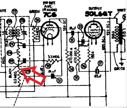

  • Disconnect the connection at the junction of the volume control and Detector circuit (a black wire that goes to the 2nd IF transformer and Cap 27e and resistor 27D on the schematic)
  • Connect the common terminal of the SPDT switch to the volume control.
  • Connect the black wire removed from the volume control to one leg of the SPDT switch
  • Connect the other leg of the SPDT switch to the center pin of the RCA jack.
  • Connect the shell of the RCA jack to the chassis.
I attached a section of the schematic showing where to add the switch and jack (the red arrow is the connection to break).  This will give the best performance and a Bluetooth receiver can be connected to this point to prevent the need to have a wire running from the iPod or whatever and the radio.
