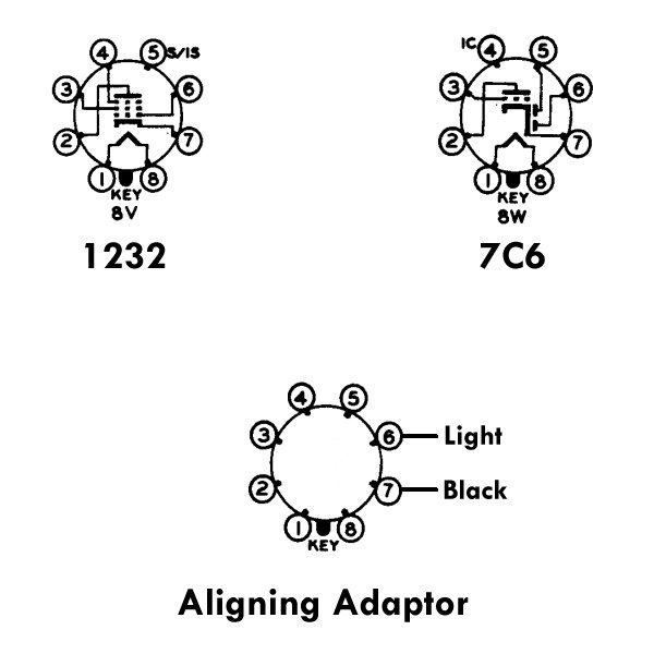

Question:  When I looked at the Rider alignment instructions, the RF alignment calls for an "Alignment Adapter". The unit is  Loctal tubes.  I happen to have a "Thru" Loctal adapter from - somewhere, no markings.  Anyone have any info on what the Philco "Alignment Adapter" hook-up is?  Mine has these, but I'm willing to modify it:
Black wire:  to pin 4 of the 1232/7G7 (RF) TUBE only, not thru to the receiver socket.
White Wire:  to pin 2 of the Receiver socket ONLY (not thru to the tube).  It's loose, so needs repair anyway.
Green wire:  to pin 2 of the TUBE only (not thru to the receiver).
White and green wires in series with an ammeter would be handy for measuring plate current on the 1232/7G7 (and many other Loctal tubes).
That makes no sense for the way it is called out on the alignment instructions.  BTW:  the black wire would be to the G3 (suppressor) of the tube (pentode).
The alignment instructions also call for it's use in on the 7C6 second detector for A.V.C. measurement.
I can probably noodle it out, but I'd rather not fry something (the 1232/7G7 is already low performing!).
Anyone got one of these little puppies? And can advise the pin outs.  Or recommend some?  (data attached)

P.S. Tore down the adaptor, had to fix White lead anyway.  Above pins correct, PLUS these inside the adaptor:
1)  pins 3, 6 & 8 connected thru (tube to socket).
2)  3.0 Meg resistor pin 4 to 6
3)  WORST ISSUE:  pins 1 & 8 shorted!  These are filament on the 1232/7G7 and many (most?) Loctals.  Might be of some interest (?) on a series filament rig, but the 40-145 is transformer equipped. With no fuse in the unit (only on the bench) this could have been ugly.  This "adaptor" was clearly not meant for the 40-145 or anything similar. Glad I didn't just "try it".  Never measured pins 1 to 8 before tear down.  Never thought to check that!
Anyone know how a Philco "alignment adaptor" is supposed t be wired?  I might fix it up to that, if I can.

Now comes the mystery of just exactly what an "aligning adaptor" was, and where those light and black wires connected internally in the adaptor.
We can easily ascertain that this adaptor had a loctal base, and a loctal socket on top, with each pin of the base connected to the corresponding socket connection on top. That is to say, pin 1 of the base to pin 1 of the top socket, pin 2 to pin 2, pin 3 to pin 3, etc.
The real mystery lies in where those light and black wires would have connected in the adaptor.
To figure that out, careful study of the schematic is called for.
We know from the scant information given in the alignment instructions, that the VTVM is intended to measure AVC voltage, which is a negative voltage.
Now we need to know which connections this aligning adaptor would have used which would have measurable AVC voltage in common so the adaptor could be used with two tubes with completely different pinouts.
Looking at the 40-140/40-145 schematic, we see that AVC voltage will be present at one of the 7C6 diode plates which is either pins 5 or 6. We also see that AVC voltage will be present on the 1232 control grid, pin 6. To measure AVC voltage with such an adaptor, a provision for a "low" or "ground" connection must also be provided.
On the 40-140/40-145 schematic, the two tube pins which have AVC voltage in common are - pin 6 for AVC high, pin 7 for AVC low or ground.
Therefore, a Philco "aligning adaptor" would have had a loctal base, a loctal socket on top, and wires connected from each pin of the base to the same corresponding pin on the top socket, plus - the "light" wire to pin 6 of the base & socket, and the "black" wire to pin 7 of the base & socket.
See image below.
Without an aligning adaptor, if you want to use a VTVM to measure AVC voltage, you may simply connect the "high" end of your VTVM to pin 6 of the 1232 (under the chassis) and the "low" end of same to pin 7 of the 1232 for IF alignment.
For RF alignment, connect the "high" end of the VTVM to pin 6 of the 7C6, and the "low" to chassis ground.

It sounds like the loctal adaptor you have is not the same as the Philco aligning adaptor as described in the Philco 40-140/145 service info.
I see yours only has pins 3, 6 & 8 connected through, pin to corresponding contact on socket, plus a 3 meg resistor between pin 4 and pin 6 of the socket. Also pins 1 & 8 shorted. Not good.
What you want is something which has every pin connected to every contact of the corresponding socket. (In other words, "straight through" as you have stated.) Otherwise, the radio will not work when you attempt to use it as an aligning adaptor. Not to mention the direct short across filament pins which would potentially take out the power transformer.

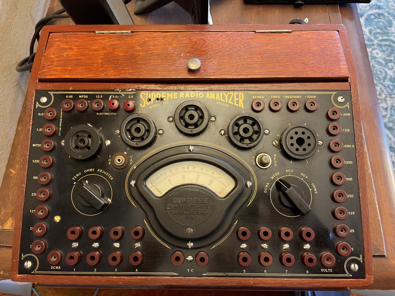

I have a good Simpson audio output meter, and can use that and normal signal generator hookups.  I just went down a "rabbit hole" since Philco said using their Alignment Adaptor and a VTVM (which I also have) was "a very sensitive indication of A.V.C. voltage". Now I wonder which is better.  I have a Loctal socket on the way here, that will make a better thru Loctal test adapter with pin-outs all around.  The one I had didn't survive teardown; I HATE epoxy (or equivalent) sometimes!  I like to make my own adapters, rather than buy one from eBray if possible. Will advise output vs A.V.C. voltage!
Thanks all!
P.S.  My other favorite test equipment I could use.  Major refurb, repairs & adjustments done. Fun! I would use it, but no Loctal (yet!).
When it comes to set testers that is an excellent example.
