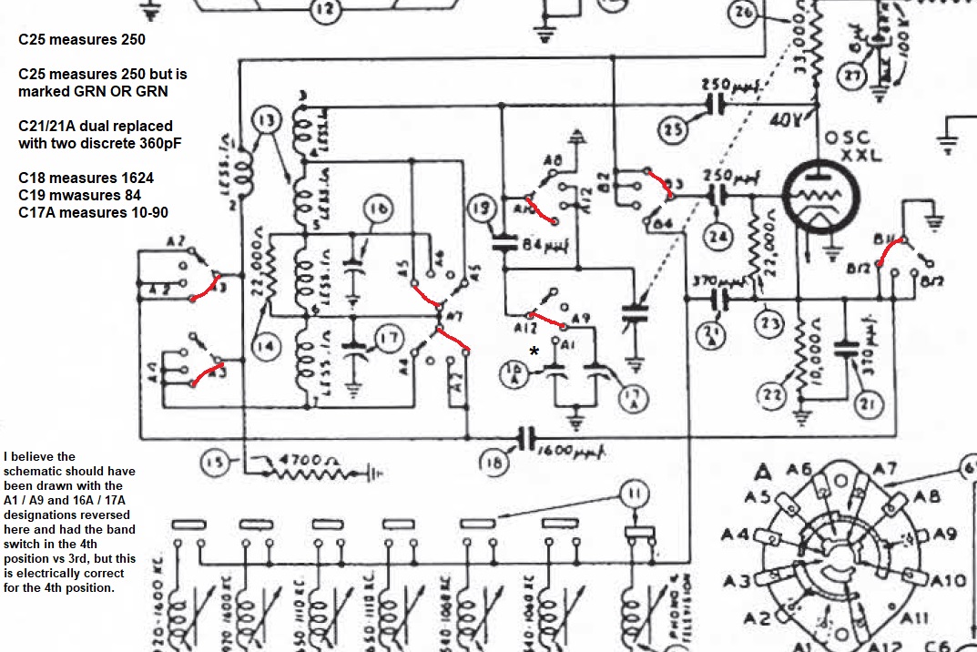

I can't find any way to make the upper SW band LO run 455 above dial frequency, which is counter to alignment info but would match the other two bands. If I open the trimmer to get the LO at 455 KHz on the high side at 12 MHz, it tracks so incredibly poorly that by 11 MHz on the dial, the LO itself is at 11 MHz, then it's soon farther and farther below the tuned frequency. I'm attaching the Philco schematic, as well as the alignment instructions for the similar model 41-280, which is what Philco specifies as instructions for the 41-255.
I've triple checked my original work. That included replacing the oddly packaged dual capacitor C21/C21A with two discrete 360 pF silver mica capacitors in the osc./mixer circuit. The other discrete silver mica capacitors in that circuit appear to be at the correct value. I've also measured continuity of the various band switch connections related to the upper SW band, including coils, etc., and soldered every riveted chassis connection, including the chassis connections of the oscillator trimmers. And of course I've cleaned the oscillator tube/socket pins. The oscillator trimmer is one half of a dual trimmer, and it measures 0-90 pF, though no value is given in the parts list.

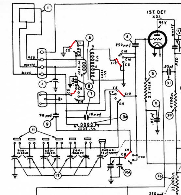

One other possibly related problem is that there's no peak on the "aerial padder" designated "2", although I am extending the cabinet loop with 3 alligator clips to the antenna terminals.

I've been picking away at this without making any headway. I've checked the continuity of each section of the antenna and oscillator coils, and tested connectivity to and through the band selector, and I've checked capacitor values. At this point I'd love to hear from someone who has a 41-255 operating correctly on the upper SW band. To help with diagnosing the problem, I marked up the antenna and oscillator sections of the schematic to show the band switch in the upper SW position. As far as I can tell, there's no antenna tracking when that band is selected - only the LO section of the variable capacitor seems to be in circuit and the antenna circuit is fixed. And I've continued testing the idea that the LO is supposed to be on the high side of carrier/dial frequency, and it just doesn't seem possible. The LO starts well below dial frequency with the oscillator compensator closed and at maximum capacitance. slowly backing the trimmer out moves the LO up in frequency in a linear way and easily places it 455 below dial frequency. But the trimmer has to be sloppily wide open for the LO to be 455 above dial frequency, and then it won't move proportionately to dial frequency at all.
I wanted to update this thread with what I've found trying to solve this problem in case it's helpful to others. First of all, it turns out that I caused most of the problem myself. I experienced this problem with everything assembled in the cabinet as well as on the bench, so I dismissed the idea of the built in loop being involved. It turns out that when the loop was directly attached with its short leads, I still experienced the problem because I also had my external antenna adapter connected. And if I had the adapter disconnected, I had the loop extended on 12" clip leads. That was critical. And not so obvious, because it did not impact the BC and lower SW band in a readily observable way.
So it turns out that the BC and 2.3 MHz bands do have the LO on the high side, and the 9.1 MHz band uses LO on the low side. The LO/dial tracking was not very good on the 9.1 MHz band (only), and that was ultimately resolved by moving C19, 84pF, up and back ~1/2" from its original spot near the group of wires leaving the band switch. The LO/dial tracking improved significantly and LO was always 420-450 KHz below dial frequency across the dial. C19 is only in the oscillator circuit in the upper SW position.

The reality check on this was receiving known off air broadcasts at 9.3, and with the loop extended on 12" clip leads, or with the loop directly attached but with the adapter also attached, 9.3 on the dial had the correct LO frequency but it was barely possible to pick the broadcast out of the noise at 9.3 on the dial, while it could easily be heard at ~10.2. With the loop (only) directly connected, performance was as expected with strong reception at 9.3 and a weak image at ~10.2. And, the adapter was problematic regardless of whether it was set for "local" with no external antenna, or set for "distant" with a 10' wire. Now, the adapter is one that I made from the diagram for the Philco 76-1134, so it's completely possible that it's not built correctly or that it's not correct for the 41-255. My final item to resolve is trying to make sure that the loop antenna resonance is tracking the dial, which I've been able to see with my scope, but I'm certain my scope is affecting resonance so I can't really confirm how well that's tracking. C9, 98pF, is measuring 108pF, so I may replace that.
