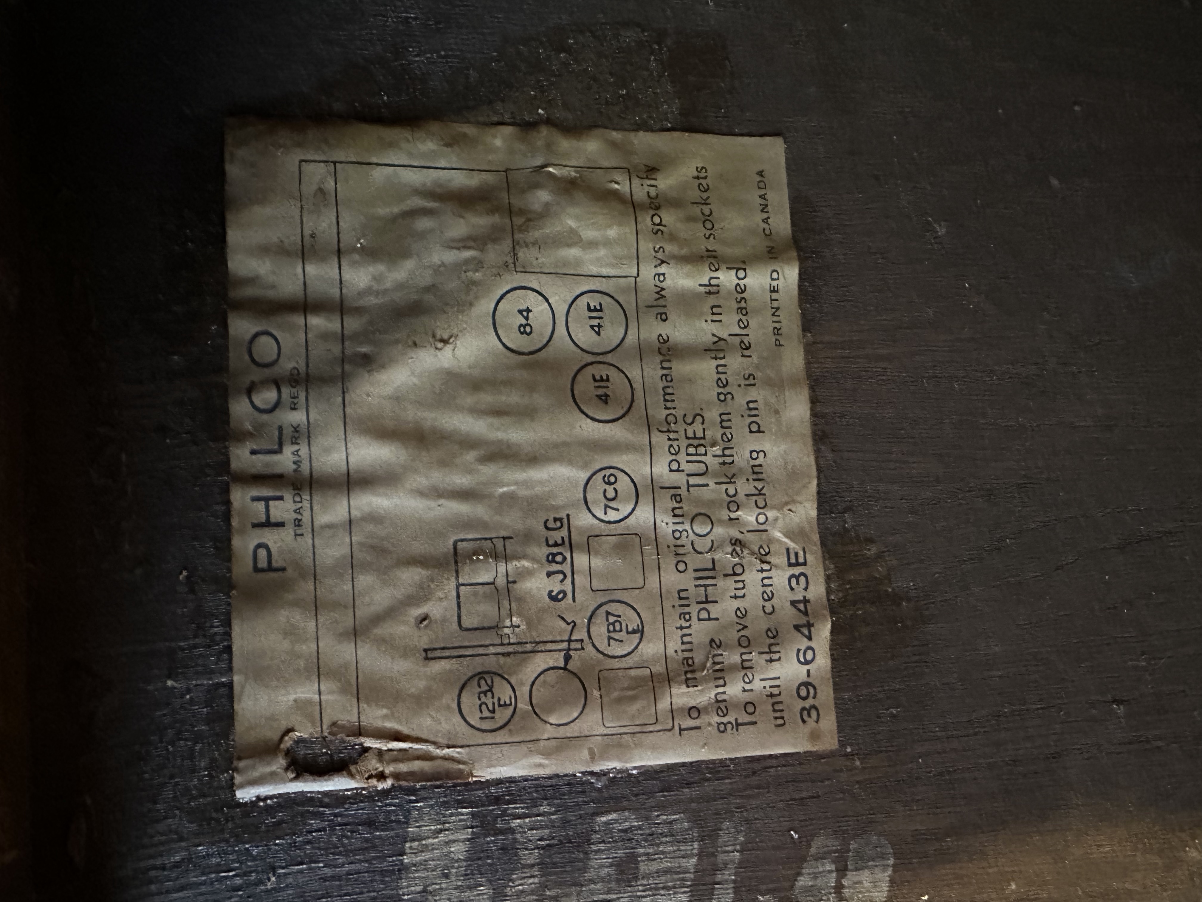

On the inside of the case there is a tube diagram that says 39-6443E, but I can find no reference to this model on the internet.

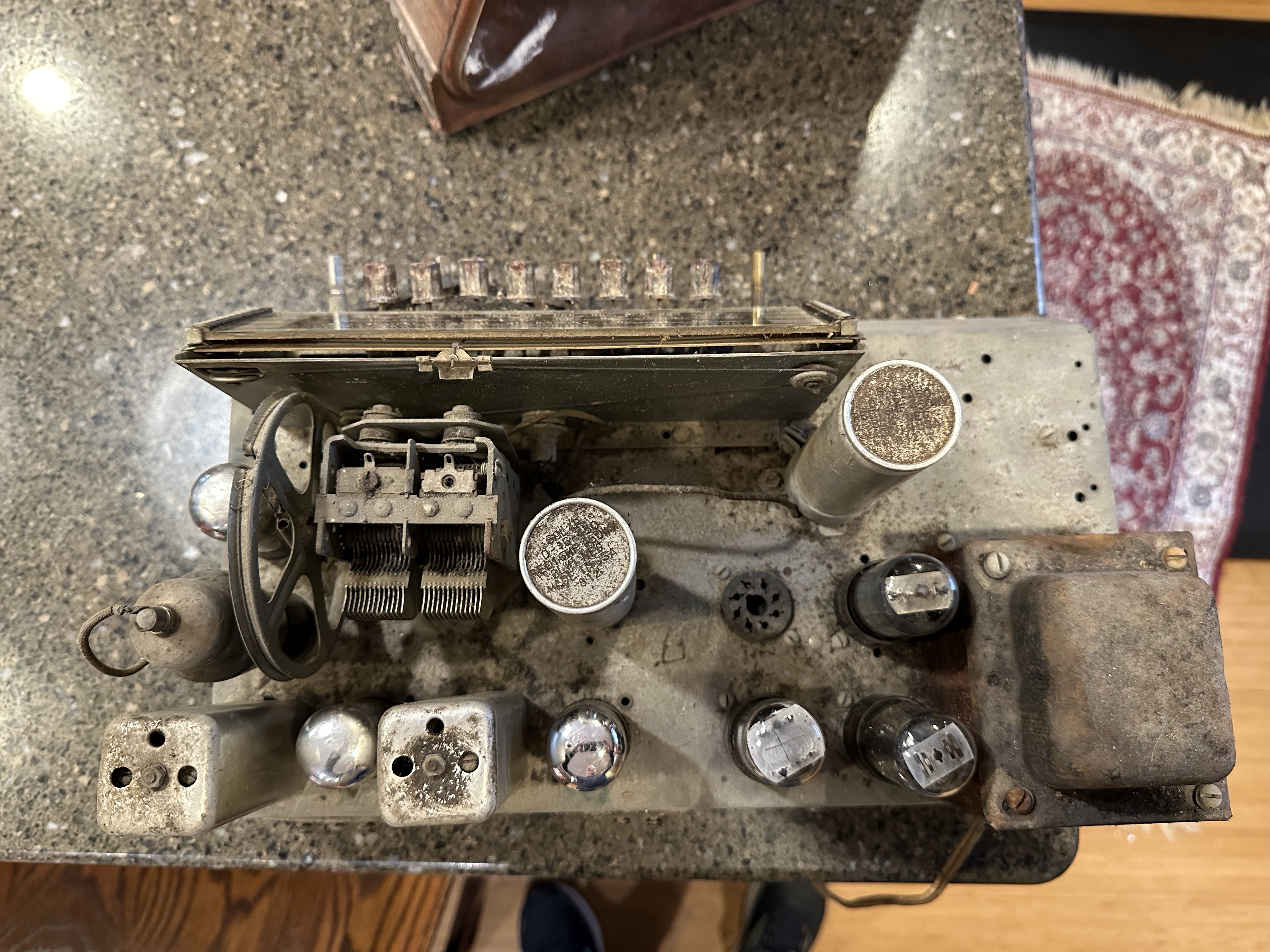

The tube diagram shows seven tubes, but the chassis actually has EIGHT sockets, one of which is empty. The empty socket has 6V6 written in pen beside it.

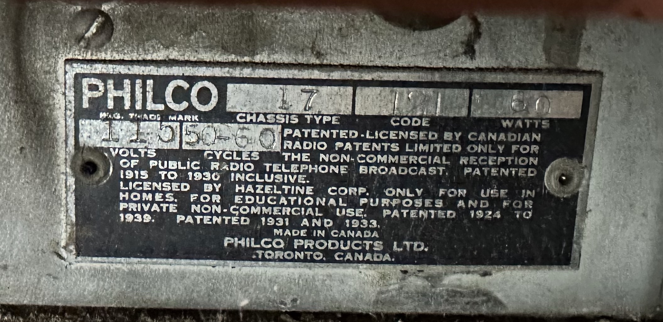

The radio was produced in Canada, based on the tag on the back of the chassis
I would like to get schematics and attempt a restoration, but don’t know where to go from here, as I don’t trust the model number specified, since the tube count is wrong. In addition, the rectifier tube on the tube diagram is in a different location on the chassis, so the diagram is obviously wrong.
I wondered if the radio had been modified to add the additional socket, but it looks original.

Just an observation. The Canadian model 17AT was equivalent to the US produced 40-155 which used 7 tubes. The 4 tube sockets adjacent to the transformer look to be attached to the chassis with screws (and probably nuts underneath). I believe that the factory tube sockets were riveted to the chassis. I suspect that there have been changes but very old ones.
That number 39-6443E is probably the part# for the label itself!

@462ron - I too was thinking about the number on the tube diagram being a part number. Does anyone else have a similar radio with a tube diagram that would confirm this theory?

From the top, your chassis looks exactly like an American Philco 40-180 chassis.  If you get the schematic for the 40-180 and run  out the circuits, it may be the same.  Just my observation.

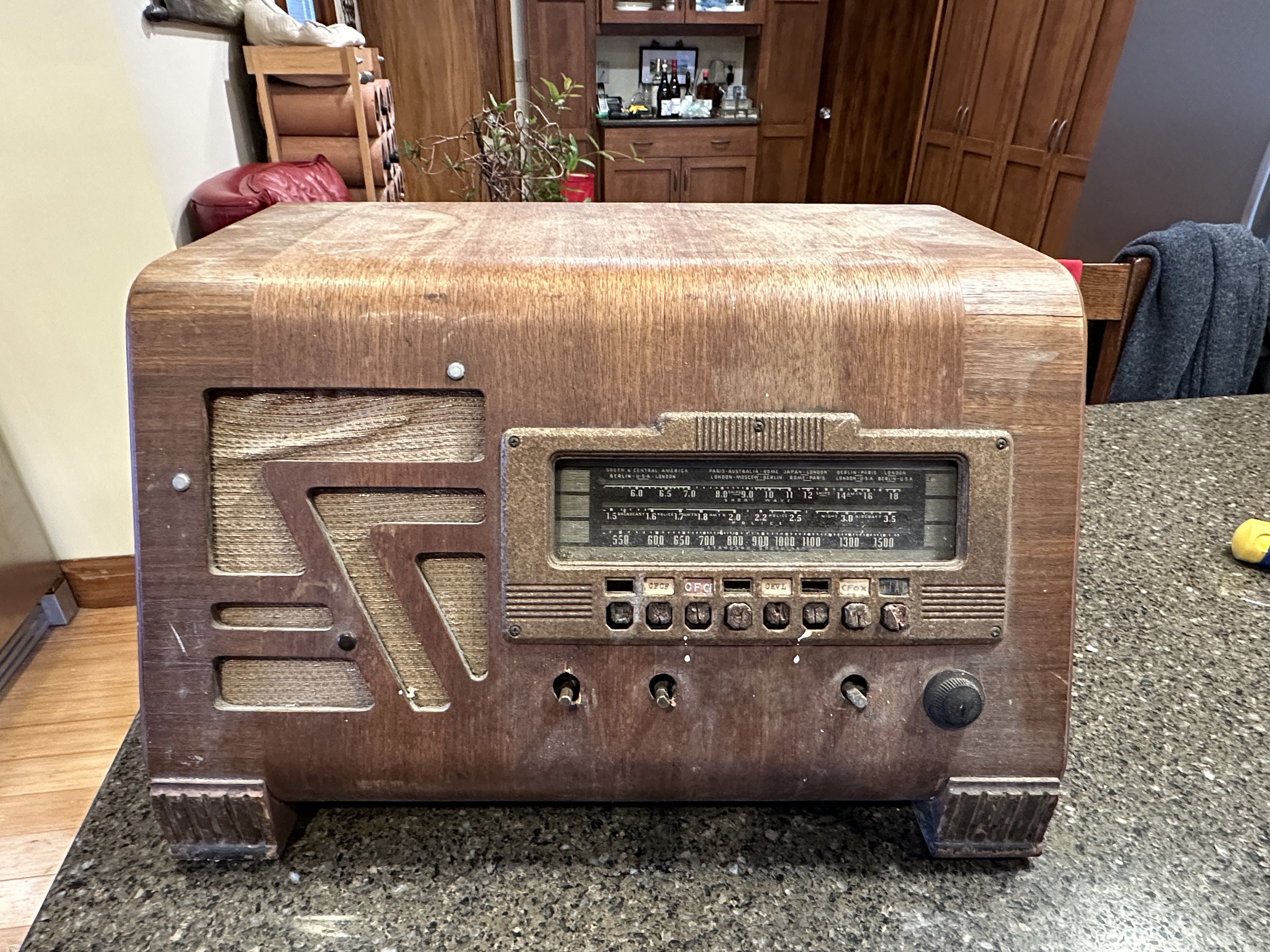

Philco offered a number of radios in the 1939 - 1942 era in both table and console versions that offered this "slant dial" chassis with a few variations. Your model uses the same cabinet as a US 40 - 155T, however that radio used an 8-tube layout while your radio appears to have been originally a 7-tube layout. The US model 40 - 150T used a 7-tube layout. The 1 additional tube for the 40 - 155 is listed as a "diode detector".

My 2 cents.  This is a Philco 40-155 based on the cabinet design over the speaker. It has been modified, evidenced in part because of the transformer.  It isn’t squarely on the chassis (hanging over the edge) and appears to be a replacement.  As 6V6’s aren’t part of the original tube line-up, someone wired in some octal sockets to sub for the 41’s and the 84. In fact, there were NO octal tubes in the tube line-up. Checking the components underneath and tracing the circuit would be the first step.
Yes, I think that’s what happened. I’m away from home for a week but on my return I will Start to create a schematic from the components in their current state. It also appears that a newer speaker has been wired to the output withoue]t a proper transformer between the two, and I’m guessing this is going to be an issue. I’ll know more once I’ve mapped it out. Hoping I can still read the test on the axial capacitors…
Actually the 6J8EG is an octal based tube, but the #41s and the #84 were six pins, the 7B7 and 7C6 were loctals. I'm guess that the eighth tube was from someone adding a phase invertor as opposed to the screen grid inversion setup the radio had according to the tube chart. Incidentally I think the rectifier tube was put in the wrong socket, although it was rewired to accept a 5Y3/5Y4 but there would be no reason to relocate it, power transformer may also be a replacement. Schematics for Canadian Philco sets were published in the RCC manuals, and whilst many were copies of U.S sets many had changes made like different tube types substituted, and more cloth wire and less gutta percha/rubber wire used.
The 84/6Z4 is a 5 pin job. Do note that the 5Y3 and 5Y4 are not interchangeable because the filament and plate pin are wired differently. Philco sets that have the original socket for the rectifier some of the reciprocals for the pins are deleted. This means if you happen to have a 5Y3 and not a 5Y4 you can't add a few jumpers so both tubes could be used. Those sneak! This doesn't apply to this set as the socket is a replacement.
Arran, You are correct about the 6J8. However, the 40-155 has 8 tubes; a 1232, a 7C6, a 7A6, a 7J7, a 7B7, an 84, and two 41’s. What I can’t see is why the label only shows 7 tubes. Maybe a 40-150 chassis modified? It’d be nice to know what the replacement tubes are.
Looks like someone slipped a 6SN7 in there next to the 5Y3.

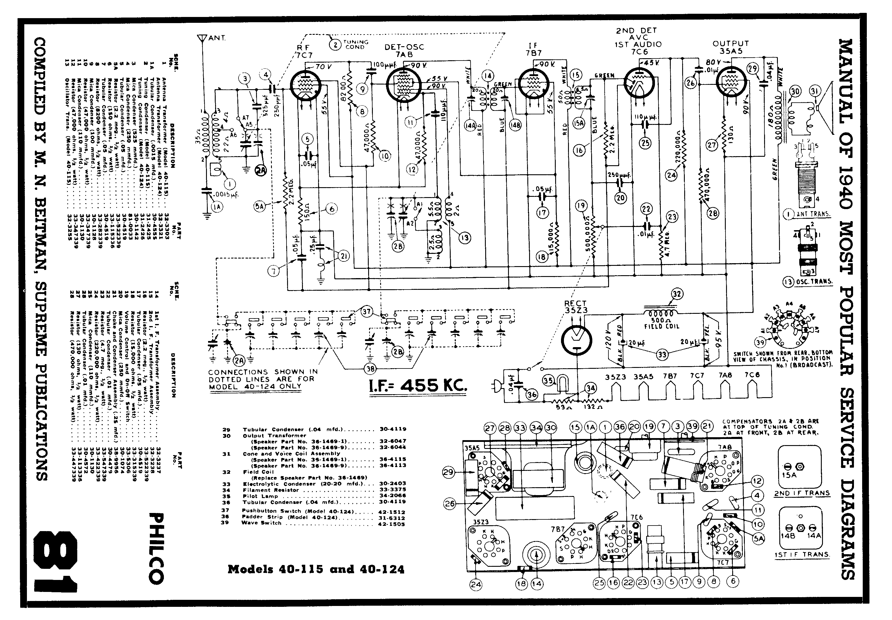

Beitmans Philco 40-155
David, This schematic is for the 40-115. 40-155 is on page 85 of the 1940 Beitman. The Riders is in vol.10.
