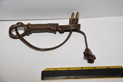

If you search eBucks with "cheater cord" you'll find a few, black, white or red. Plus you get some hardware hits. I might have one downstairs.
Something like this?
Yes, the cord was riveted via the vinyl "ears" at the female end to the hardboard back of the TV/radio. The cheater cord was "for" technicians to power the set with the back off... Though the cheater is a replacement one has to cut off the rivets and install screws to replace the old cord. Often the hardboard back is turned to mush arounf the cord opening.

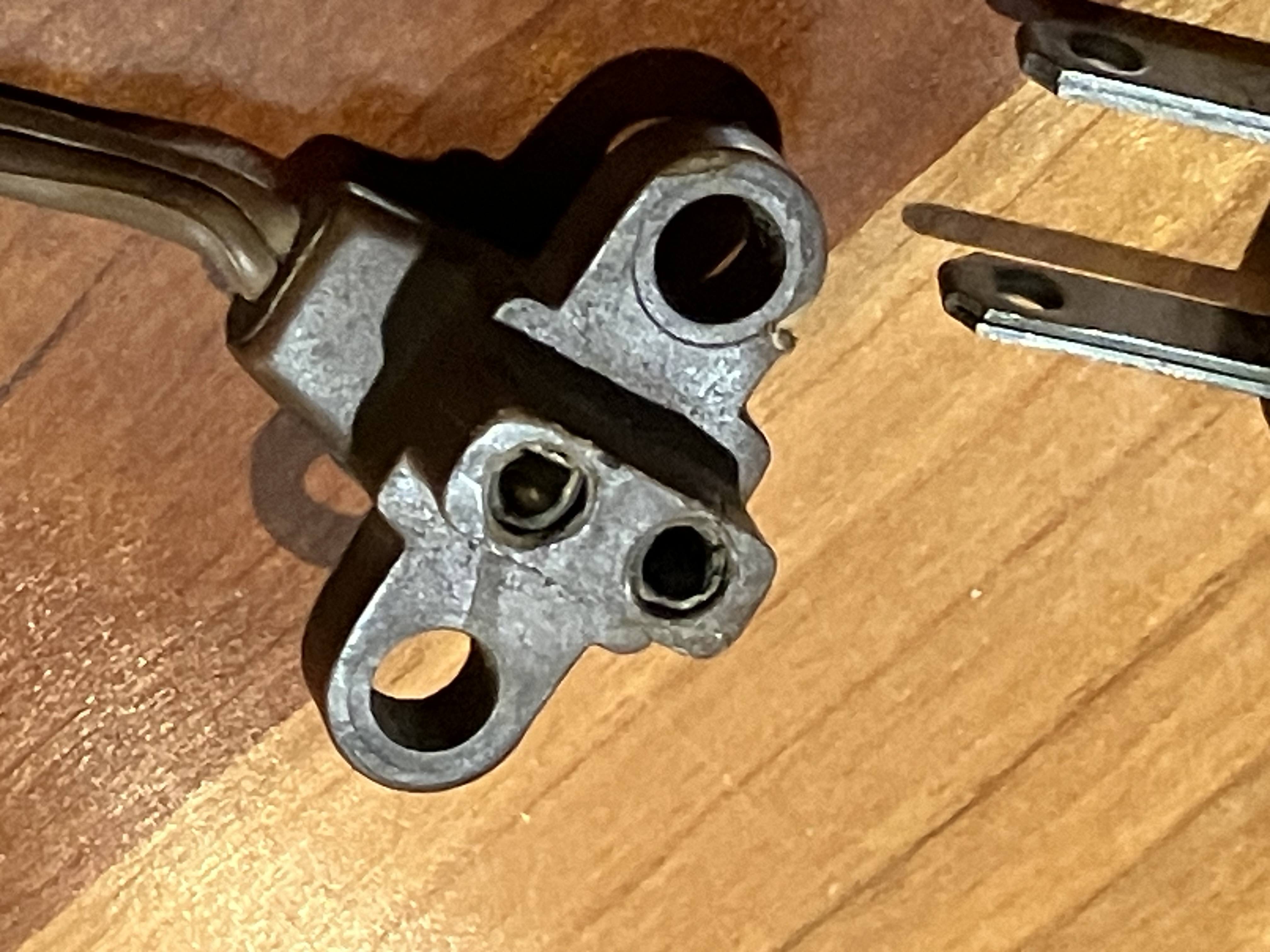

What you have there is exactly what I am looking for.  Would it be possible to measure the distance between the centers of the two openings and the diameter of the openings.

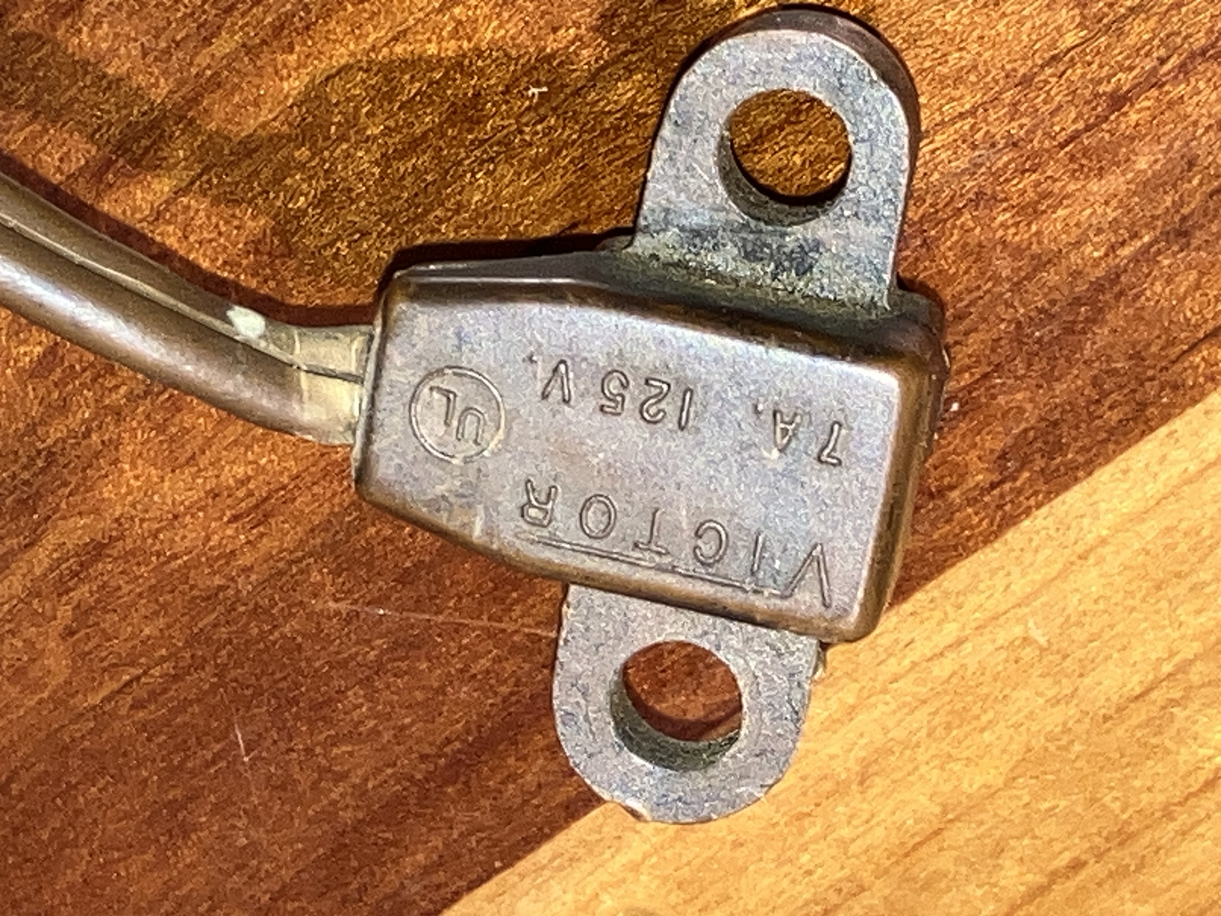

Here are some photos of the cord that came with the set.  It is obviously not a Philco cord, the tabs are in the wrong position.  Additionally, it has the word "Victor" on the opposite side, so my uneducated guess is this is from an RCA set.  The cord is slightly brittle, especially near the connector going into the set.  Decided that it's not worth risking a short.
Sorry not able to help. The picture is from ebay.  David
That "Victor" cord might be from a movie projector, there used to be a brand of projectors called "Victor", RCA stuff usually has the meat ball logo on it or nothing at all. I've never seen a TV cord with a vertical arrangement like that, it doesn't men that there weren't any but I'm pretty sure that Philco used a more standard design.

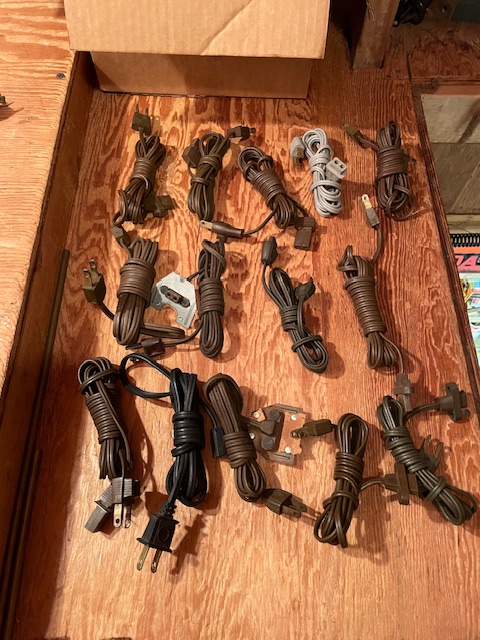

Up until this afternoon I thought I would have possibly one cord.
Tv's sort of "came along" but I sold off the last of them a few years back. I have cleaned many TV technician estates and would bring home box lots of tangled cable cords wire. Sort through junk most and wind up the cords and separate. I pricked through and found all those to my surprise. There is about 10 more that are polarized. I also have "some" clips and chassis male connectors.
But the punch out in the TV back determines if the female end needs ears and the front protrusion is of different length depending how forward the chassis is. Some male chassis have "squarish" corners, others rounded. So the real mate has to fit or an oversize one has to have the vinyl trimmed.
