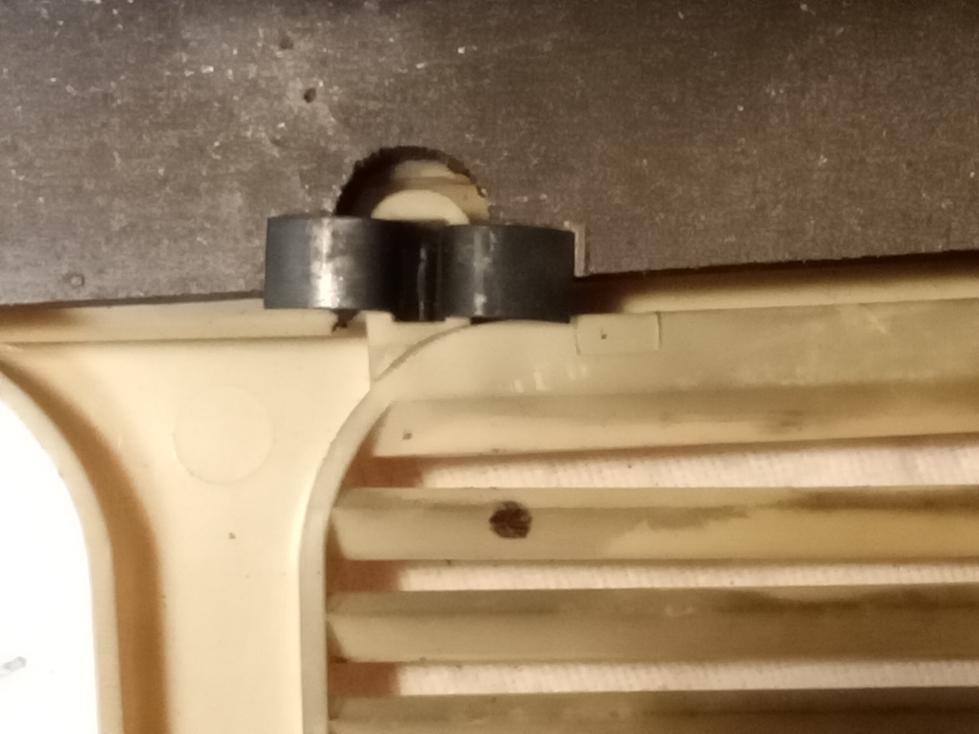

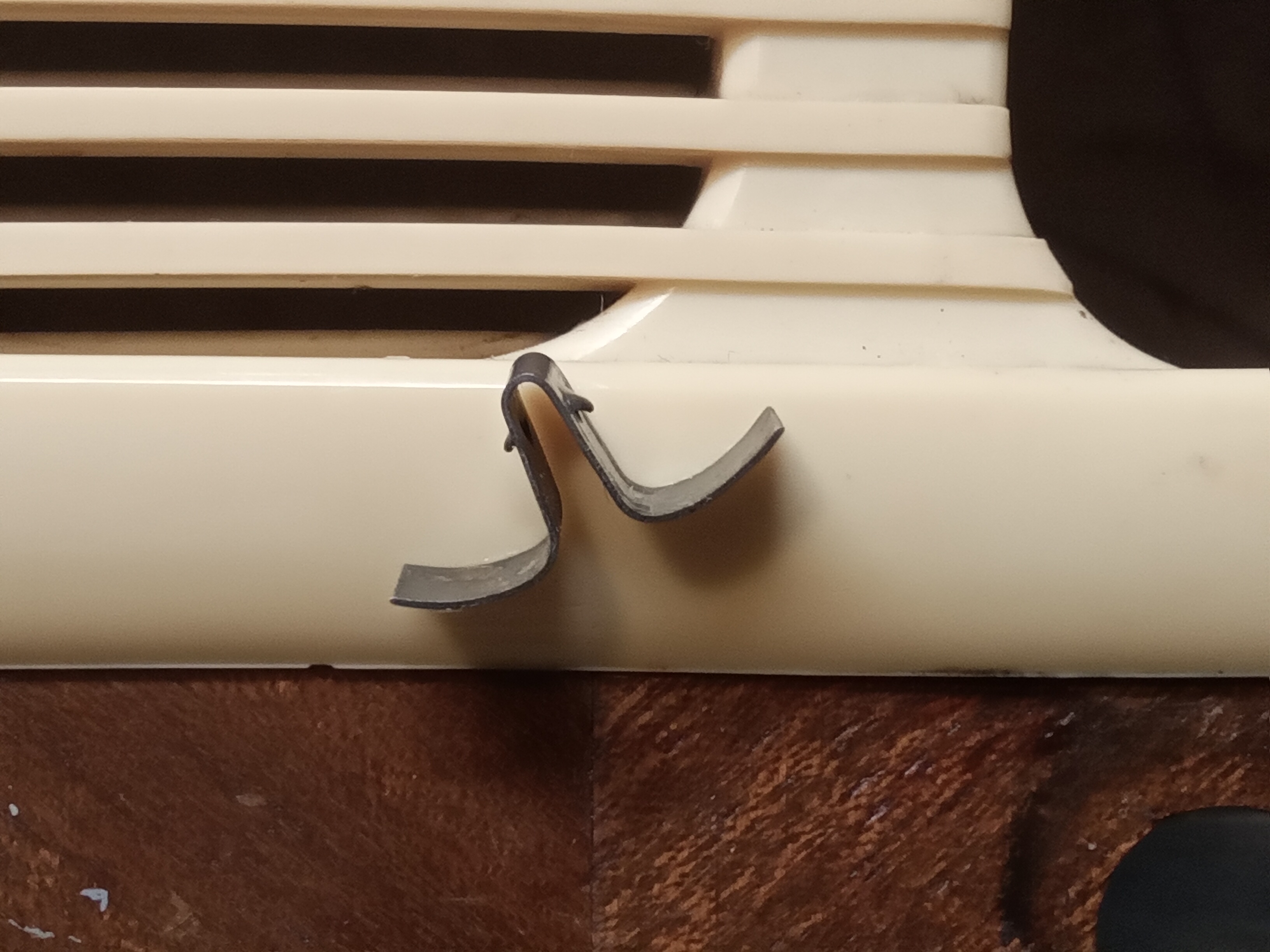

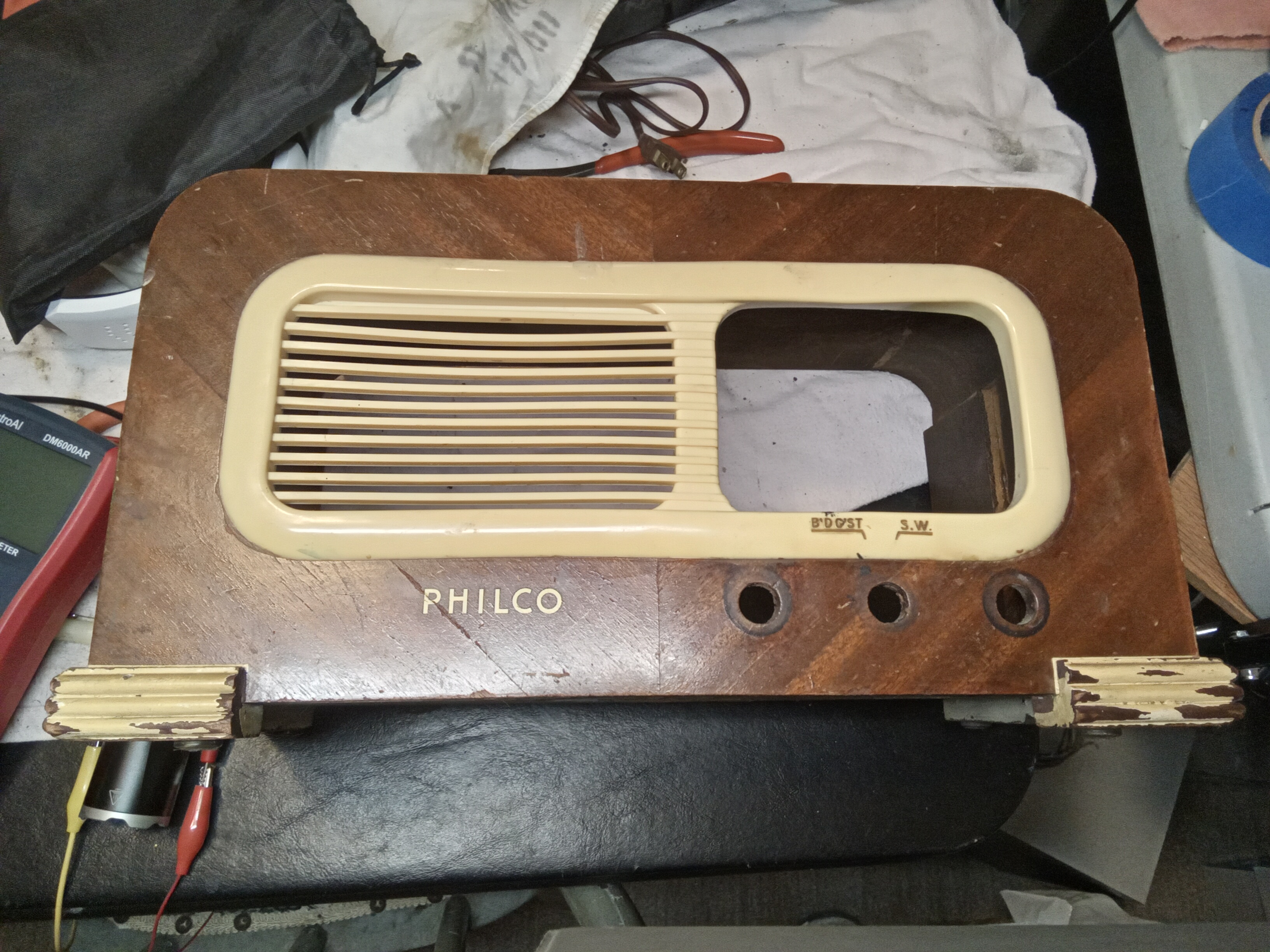

I just started restoration of a 41-221. I need to know how to remove the clips holding the tenite bezel on the cabinet. I didn't want to get too rough for fear of damaging the bezel.
So here's a couple photos of the bezel and clips.
Looks like you just need a pair of angled needle nose pliers to slip into the clip and give a squeeze and a giggle.
I was able to remove them using a small pair of long nose pliers. There wasn't much clearance to get the pliers under the clip but once I got a grip on it I was able to pinch and rock it back and forth. Looking at the photo, you can see that each side of the clip has a gripper barb to hold it in place.
