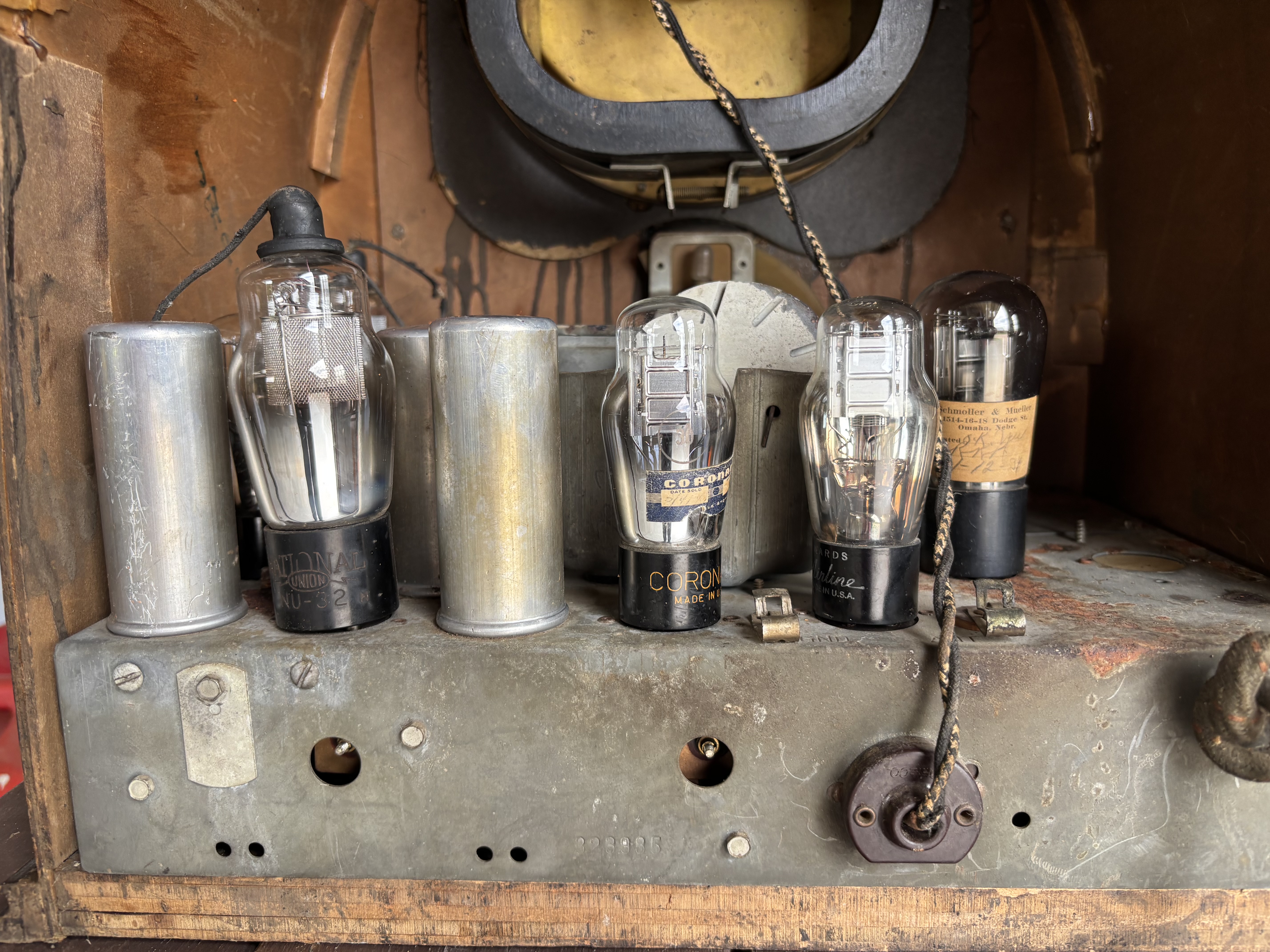

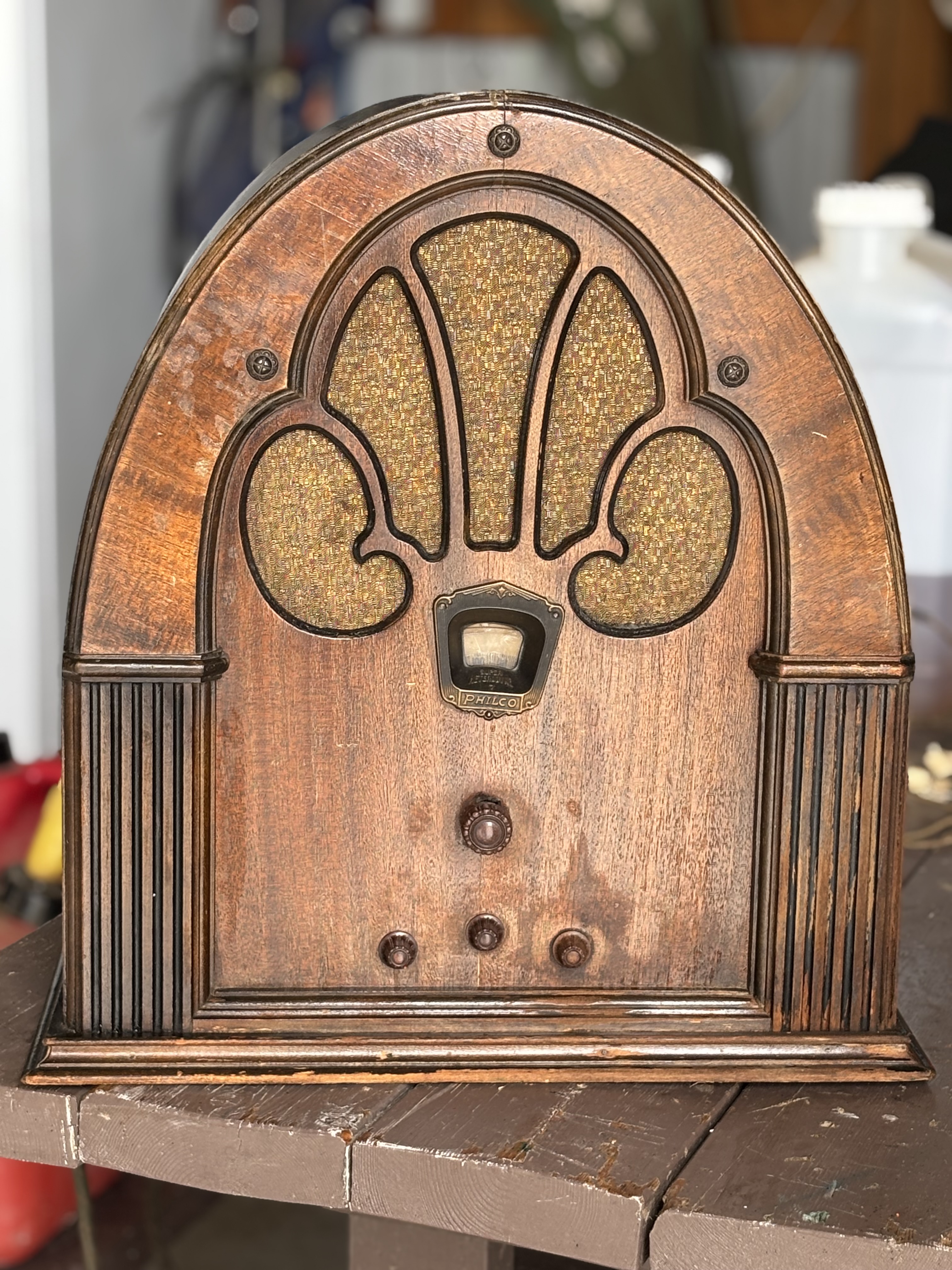

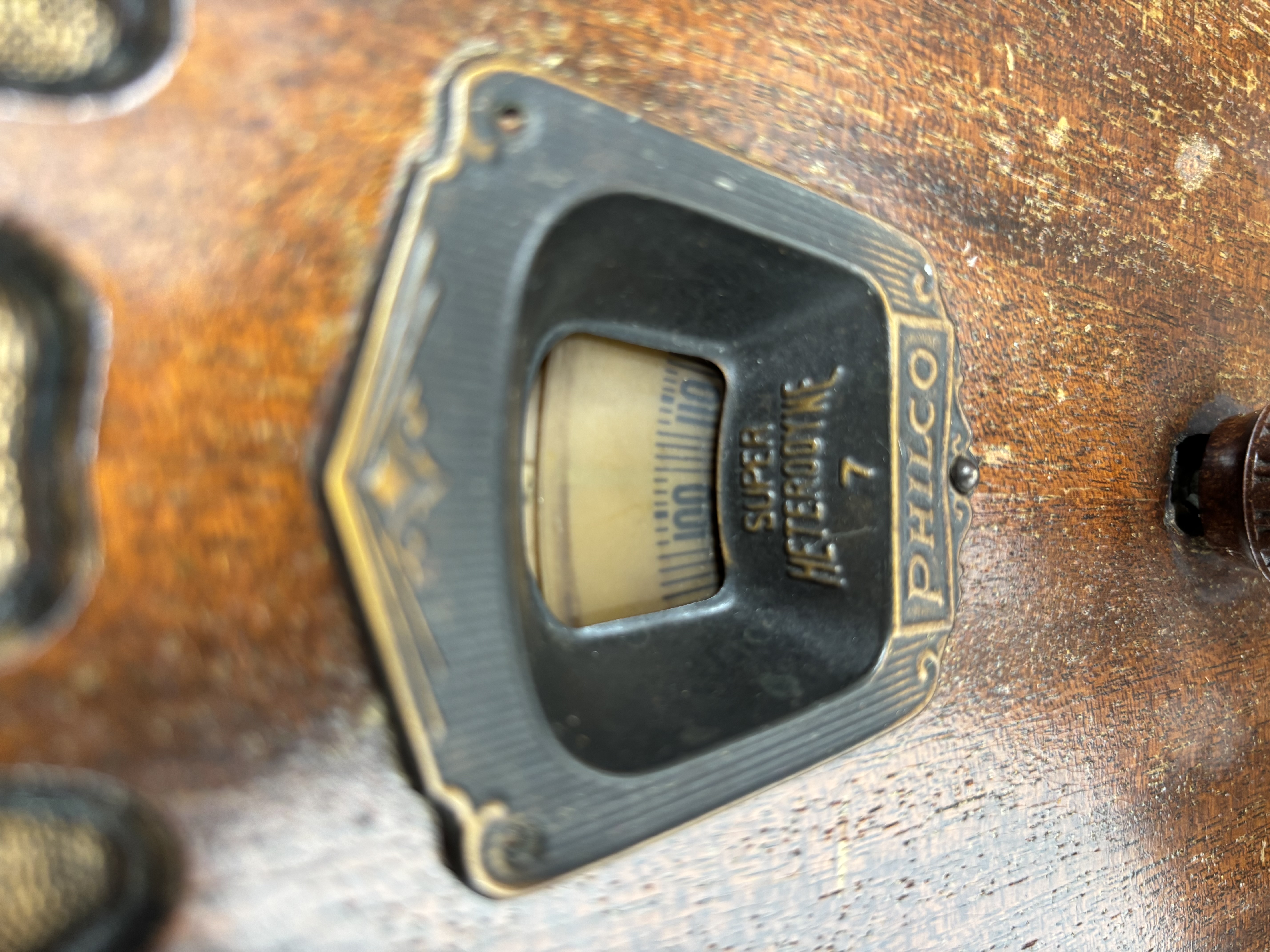

Welcome to the Phorum, jacques! Looks like a very restorable Philco 70. I've seen worse cabinets. It looks like its' been serviced in the past (different tubes manufacturers), and the escutcheon was re-installed crooked. It's also missing the tube shield. Looks like mice enjoyed the warmth looking at the surface rust. All in all a desirable radio in need of a full chassis and cabinet restoration. Also in its' favor is it isn't a console. I wouldn't make an offer without seeing the circuitry underneath. Take care, - Gary

It is not a model 70, it's a battery operated equivalent called a model 35, which was typical of a radio used on a farm from those days: https://philcoradio.com/gallery2/1931b/#...Baby_Grand Here is the service info: https://philcoradio.com/library/download...l.%201.pdf They are probably less common then the AC powered model 70s, but at the same time that makes them less appealing to many.

I agree with Arran its a 35. Has the rosette screws holding the speaker in place and is missing the power transformer. The fact that its battery operated makes it less desirable to some, particularly because it requires 4 separate battery voltages to operate, 67.5v, -22.5v, 2v, and 135v.

I should have looked closer before I mistakenly said it was a 70. I didn't look any further than the escutcheon and that "7". Thanks for correcting me gentlemen. Take care, - Gary

Everyone has their off moments first clue no power transfomer !!

Having said that, in my humble opinion, you have a real piece of history. I have always been interested in farm radios. You have the farm version of an iconic radio in one of the most iconic and beautiful cabinets that Philco (and other manufacturers) ever made. This is the farm version of the Philco Model 70, one of Philco's first Superheterodyne radios (licenses had to be purchased from RCA). The farm version has very similar construction and circuitry, except for the fact that there is no power transformer or rectifier and an additional stage of AF amplification. Since permanent magnets were bulky, expensive and not so per anent until the invention of AlNiCo V magnets, "electrodynamic" speakers (speakers with a field coil as a magnet) were popular in AC sets while farm sets used a permanent magnet speaker. Note the massive magnet on your speaker. This is possibly the reason for the crack in the front panel of your cabinet. Nonetheless, except for somewhat weaker audio output (0.8W for the 35 vs about 2W for the 70), this farm set (35) has all the sensitivity of its AC equivalent (70). This set ran on a 2V storage battery for the filaments which had to be recharged, by a service station and three 45V "B" batteries which had to be replaced after about 100 hours if use. A 22.5V C battery would last more than a year as very little current was drawn for grid bias from this battery. Considering the remote location and expense of the batteries, the farm radio was likely used sparingly, usually for crop reports, Sunday religious programs the occasional Saturday night entertainment and news of the growing troubles in Europe and Asia which culminated in WWII.
If you want to restore and use this radio, here are the following issues:
- Replacing missing tubes and components. The tube types used in this set are not the most common types, but should be available on the various auction websites.
- Recapping. This should be no more difficult than recapping a line powered radio, and possibly easier.
- RF, oscillator and IF coils. The primaries of these coils have been known to fail, requiring rewinding of these primaries. This is not impossible and instructions are in our library.
- Power. This may be the most difficult issue. Since this set runs on batteries which are no longer available, an external power supply such as an ARBE III (about $170.00) or a home built power supply is needed to operate this radio. Coming up with 135V worth of 9V or AA batteries and 3V worth of D cells is possible, but not exactly cheap. Building a 135V DC supply is not too difficult, but building a stable 2V DC supply for the filaments is not easy. 3V "wall warts" are commonly available but the voltage has to be dropped to 2V. This can be done by external resistors by adding up all the filament current drawn by these tubes, then calculating the resistance needed using Ohm's Law.

However a 70 cabinet in good shape might make it somewhat valuable for those looking for one, even if 35 is less desirable.
One thing I am not sure of is the speaker mount: it might be different for 35, but I am sure a person with right skills can take care of it.

Anyhow I looked up the schematic of that Philco model 35, it does follow the concept of the model 70 pretty closely, including a tuned RF amplifier stage. The power output is a single ended #33 pentode, so pretty similar to a single ended #47, though I think the #33 sounded a bit better fidelity wise. The #33 was a popular choice in many 1930s battery radios, right up until 2 volt octals came out in 1938. My Stewart Warner vibrator radio uses one, and in theory they can put out over a Watt, since the vibrator supply can put out up to 180 volts on the plate and screen grids, on a straight battery set they usually topped out at 135 volts. When I get that set working I am planning on powering it from a SLA, a sealed lead acid battery.
