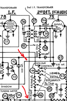

Hi fellas,
I believe the schematic has an error in the AVC circuit. If you look at the schematic from the library at the second IF primary to the third intersection down. It shows a connection to the AVC. This should not be a connection because there is B+ on the plate circuit of the IF. My 650X schematic has the same error. So I don't believe the AVC controls the shadow meter, it's the plate current of the 6A7.

Rod, I have two copies of he 635 schematic and both are very hard to read so I can't really tell where junctions are. Could you please post a picture showing what you said?

I am not seeing what you are describing in the sch, both Riders' on the Nostalgia and the one on Philcoradio.
If you mean this.
https://philcoradio.com/library/download...%20239.pdf
There is no tie-dot on the 3rd intersection and the 2ndIF primary ties to B+ which it should. AVC bypasses it with no dot.
You could see the tiedot to B+ at the bottom (bottom red arrow) but not with the AVC (3rd intersect, top red arrow).
Also, for this error, if it exists in some form, to take effect, it needs to be on tthe sch which Dconant uses and he had to then modify the circuitry according to it, which he did not indicate he had done.

I did not make a modification there.
