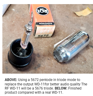

If all else fails you might try this fellow's solution. (I have no idea if it actually works or not.)
https://sites.google.com/site/johnengsde...dyne-radio

Ingenious. I wonder if there is a way to cut the envelope and glue it over instead of the dropepr bottle.

The above link is to John Eng, who has a wonderful website.
I would think that it is possible. You will need a blowtorch. I remember creating glassware in either High School or college chemistry.
1. Remove the base
2. Obtain a glass tube, heat the tube and the bottom "stem" of the tube. When both melt, touch together to "weld" the 2 parts together.
3. Rotate the tube heating the seam between the stem and envelope of the tube. When sufficiently hot, remove the stem and "firepolish" the envelope.
Alternatively, create a glass cutter using a length of nichrome wire suspended and powered.
If the getter changes color, rinse it out and paint the interior with silver paint.
Glue the envelope over the base after wiring the submini tube to the base and verifying operation
Will the vacuum inside the envelope not interfere?

Oops.
Cut the tip off the stem, to vent the tube. then do the above steps.

Attached is another pic from John Eng's site. Unfortunately, he does not describe how he cut the stem out of the tube:

I suspect that the problem will only be there if the glass is simply softened: it will start sucking the soft part in.
But I think the vacuum is not enough to really create an explosion if neatly scored.
So if you try one turn of some hot wire, or maybe both this and dip an cold water afterwards, or scoring first...something might work.
Now that I think about it, of you break the tip (neatly) the rest of the envelope might hold just fine. Then the rest could be dealt with.

Hi Morzh,
Yeah, if yo carefully cut off the evacuation tube , you will vent the tube. Amazingly, the getter did not change color, unless he cleaned the inside and coated / painted the inside of the tube.
