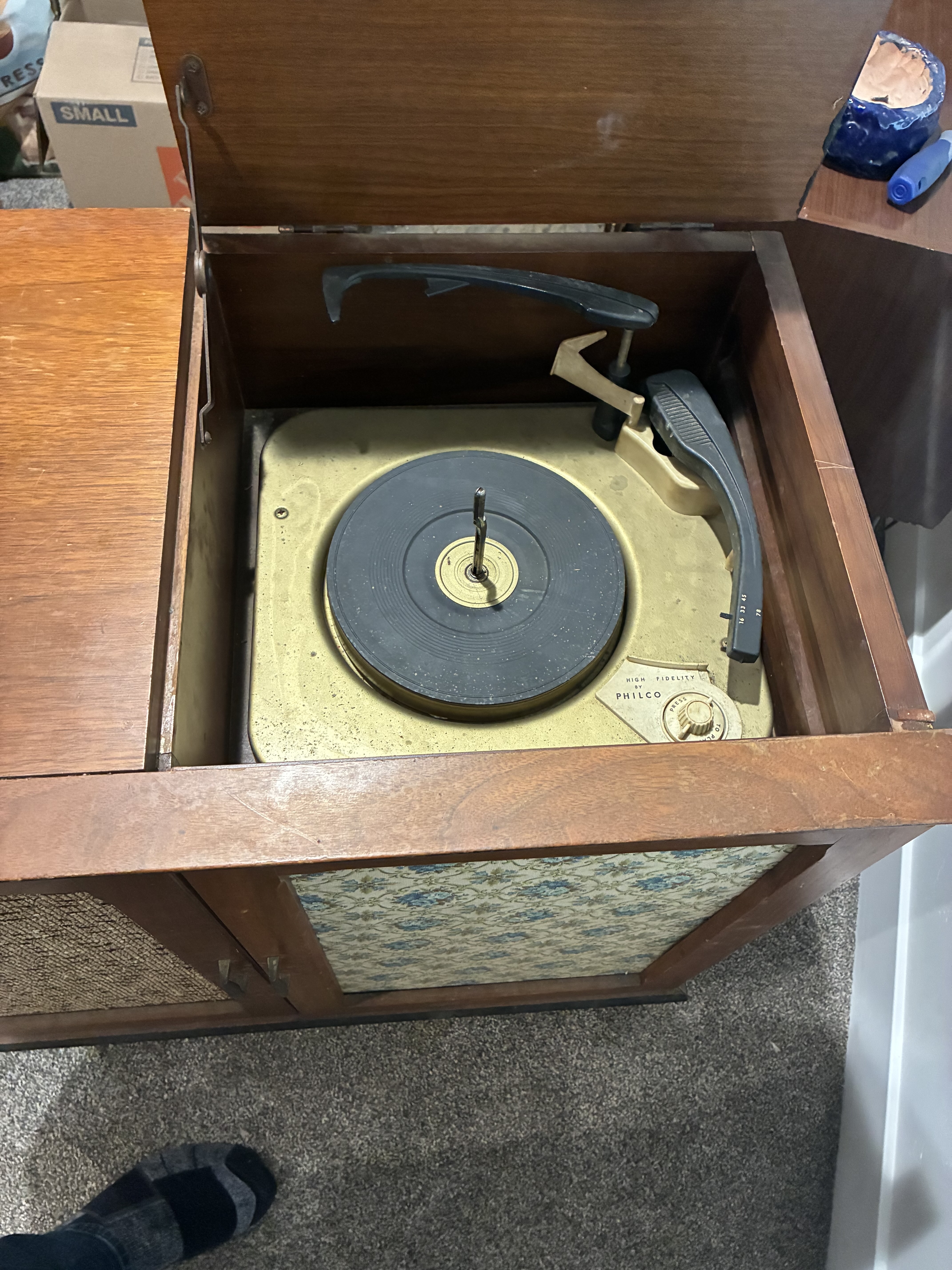

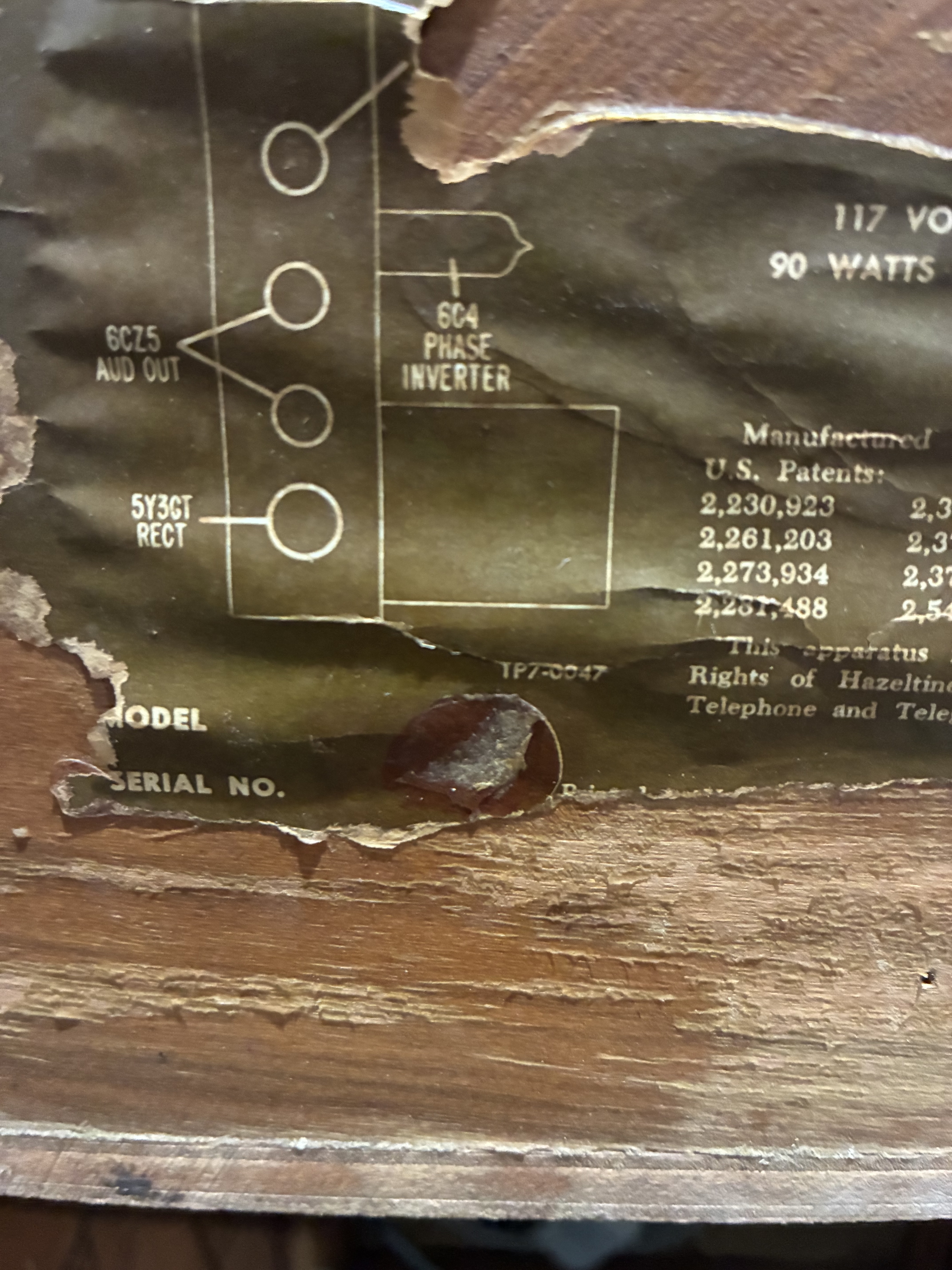

I have an Philco Radio/Phonograph from either the 50's or 60's I am trying to identify.  The label on the back with the make and model is torn and the information is missing.  So looking for some help in identifying what I have.
Here are a couple of pictures.

https://www.radiomuseum.org/r/philco_g_1806s.html

nice looking like console I don't know if you have a tools like digital meter you for sure need that to start with .
Hi FancyPants, and welcome to the Philco Phorum.  We hope to see much of you.  Please "surf the Phorum, read the rules and regulations, and "What not to post".  We are a family-friendly and supportive gang here.
Attached are the schematics for this set from RadioMuseum:
.pdf Philco G-1806S Phono RadMus Sams P1.pdf Size: 320.66 KB  Downloads: 95
.pdf Philco G-1806S Phono RadMus Sams P2.pdf Size: 314.16 KB  Downloads: 107
This is an interesting unit.  While it states that it is "Stereo", another amplifier and speaker are necessary to hear a record in stereo. I assume that the phono cartridge is a stereo cartridge.  In the early days of stereo, the amplifier and speaker for the right channel did not necessarily match the left channel on many sets.  This is anathema to the modern audio enthusiast but this was common.  True HiFi equipment like Fisher, McIntosh, Scott, etc. was out of the reach of the average person.  The "main line" companies such as Philco, RCA, Magnavox, Motorola, etc. had several interesting attributes to make a nice sounding unit.   In the case of Philco, the electrostatic speaker and their earlier "Beam of Light" Phono pickups were innovative designs.
Please note to NOT connect typical dynamic speakers to the electrostatic speaker terminals.  The electrostatic speaker is charged by a negative 610V Power supply!!!!
For example, Motorola had a 3 channel amplifier; a high powered monaural "center" channel and smaller left and right amplifiers.
The amplifier for this set is interesting.  This does have a relatively high output, somewhere between 5 and 10 watts based on the plate voltage, and an interesting "electrostatic" tweeter.  The amp also featured negative feedback to reduce distortion and several stages of amplification.  This was likely because the phono cartridge was ceramic, which had lower voltage but better fidelity than crystal cartridges.

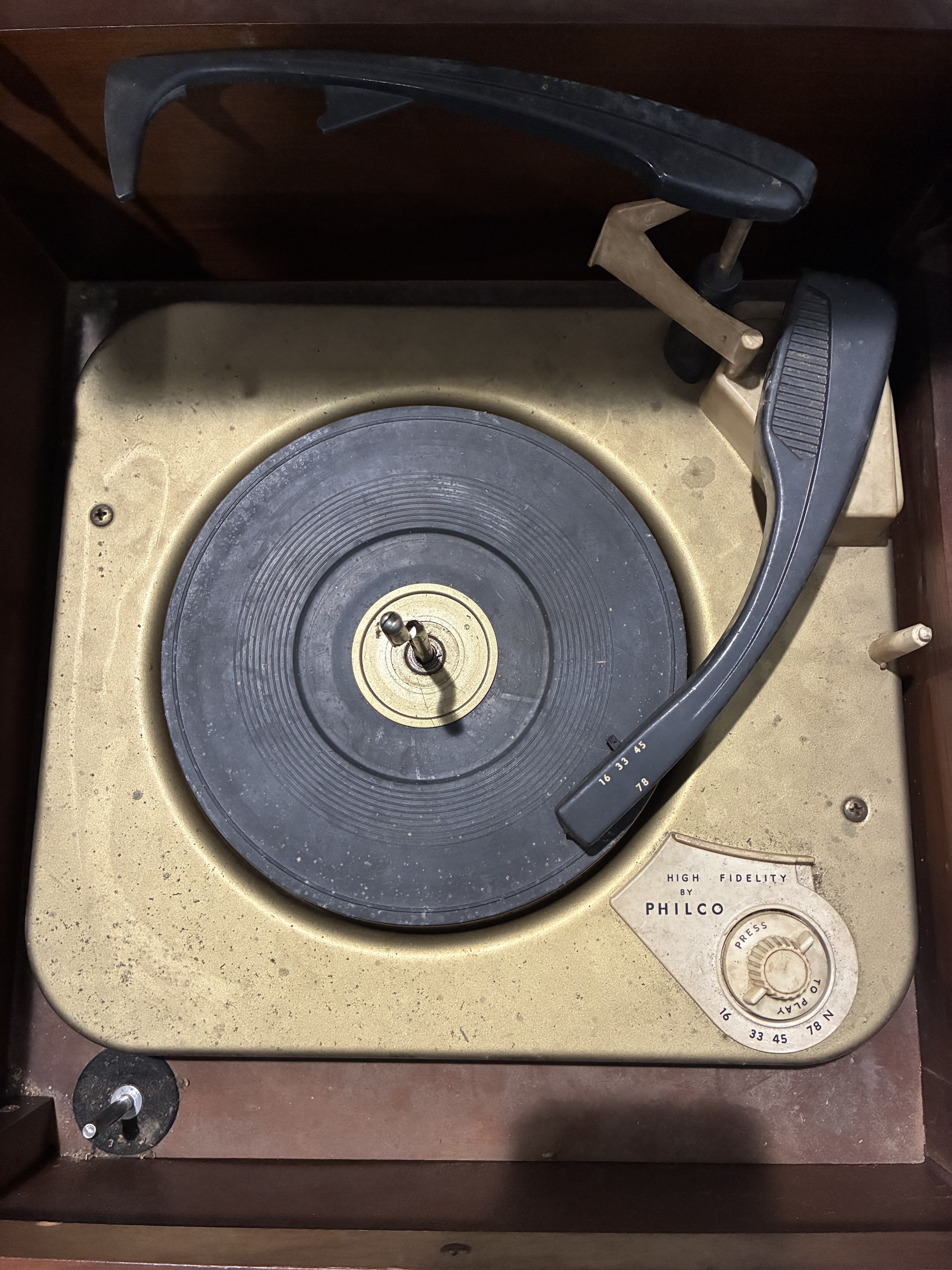

At one time, Philco built their own turntables, but this one may be a "Voice of Music" (V-M) turntable.  V-M was a majpr OEM suppier of turntables and record changers to US phonograph manufacturers.  n the mid 50s to about 1970, at least 75 % of all phonographs or radio-phono combinations used a V-M turntable or changer.  This was before the "British Invasion" of Garrard, BSR and Collaro.
