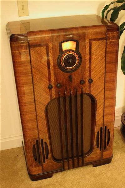

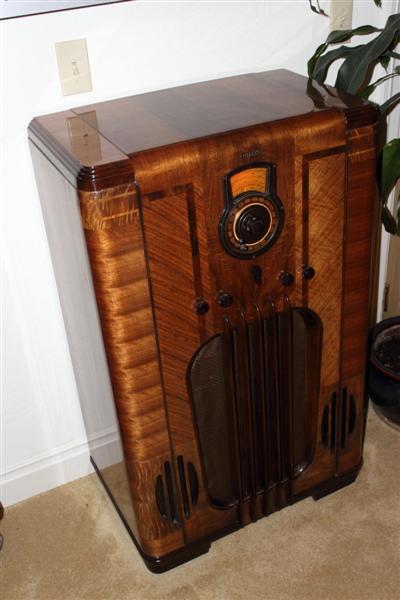

Here is how I did one of mine.
I mix my own toners.
Both a bright exposure (notice the reflection of the light switch = Gloss) and a exposure with less flash:

I have all of the tools to save a little time. The one above was sanded with ~1200 depending on my mood that day, and then power buffed with a 3M compound and finished off with a glaze. A few weeks later I put on some wax. And when I say power buffer, I mean an air tool. When I let off of the trigger I want it to stop - right then!
A buffed gloss finish will be a better reflector than a shiny un-buffed finish, but less shiny. But all is lost if you don't fill the grain.
By the way, shellac is a fine sealer and grain filler. I use it in the summer here when the humidity drops into the teens, and it smells nicer than lacquer too.

Phlogiston, great job on that 37-116!
