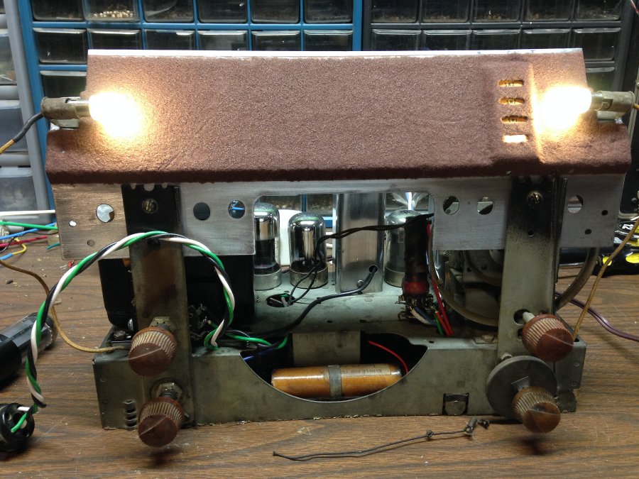

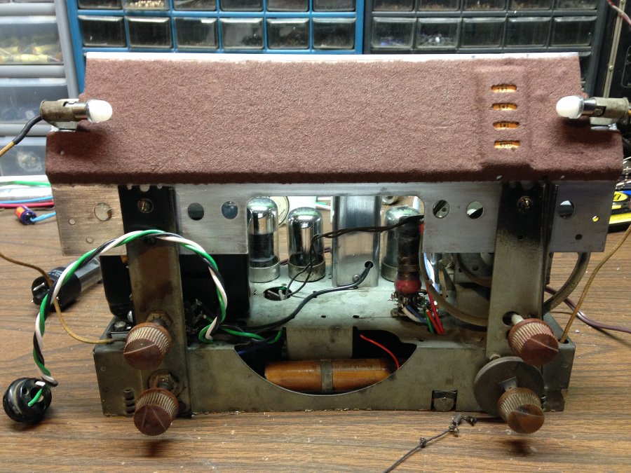

With many thanks and my most sincere appreciation to Greg (NostalgiaRadioTime), I now have a great-looking, reflocked dial back plate.
[Image: http://www.philcoradio.com/images/phorum...e00034.jpg]
Here it is turned on, with the 5Y3GT removed since the speaker is disconnected:
[Image: http://www.philcoradio.com/images/phorum...e00035.jpg]

I still have to restring the cord that controls the placement of the bulb behind here, which indicates the proper band selected. The tuning dial cord is already restrung; I only need to reattach the pointer.

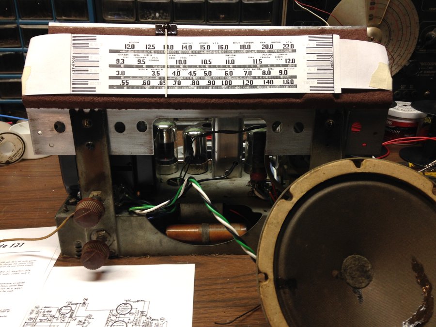

Using the dial scale scan sent to me by Mike Feldt, I made a negative image of it and then printed it to actual size to make alignment easier:
[Image: http://www.philcoradio.com/images/phorum...e00037.jpg]
And, yes, folks, it does work on all four bands.
Other than tying up a couple loose ends, this chassis is finally done!
This has been one of my most challenging electronic restorations. I am glad it is finally up and running again. Thanks go out to Greg (NostalgiaRadioTime), Mike (in KC), Sam, and Mike Feldt for helping make this possible.

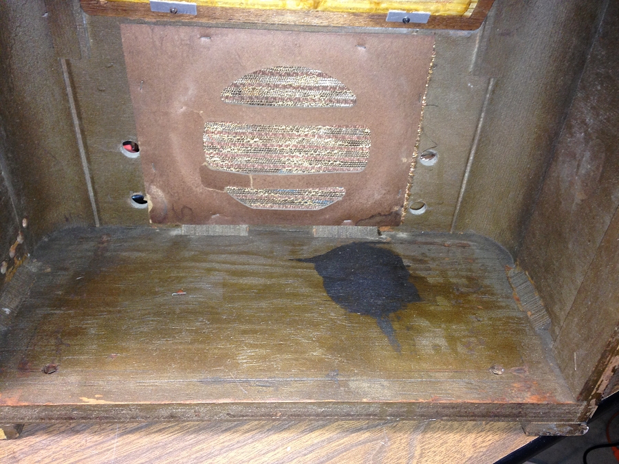

Look inside the cabinet; you can see the spot where the original power transformer had a meltdown prior to my purchase of the set.

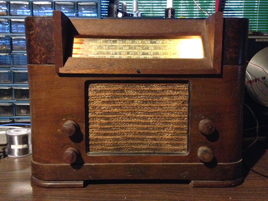

Using some original old dial cord salvaged from a dead radio some time back, I restrung the mechanism that moves the band indicator lamp up and down. I also soldered the grounded end of cap (30) to the ground lug which is held in place by one of the screws and nuts that holds the dial back plate in place. Once the loose end of (30) was properly grounded, the volume dropped slightly but the tone quality increased.

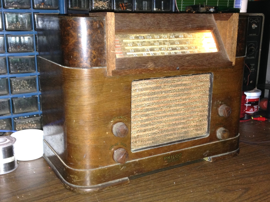

After all this was done, the chassis went back into the cabinet.
[Image: http://www.philcoradio.com/images/phorum...e00039.jpg]
[Image: http://www.philcoradio.com/images/phorum...e00040.jpg]

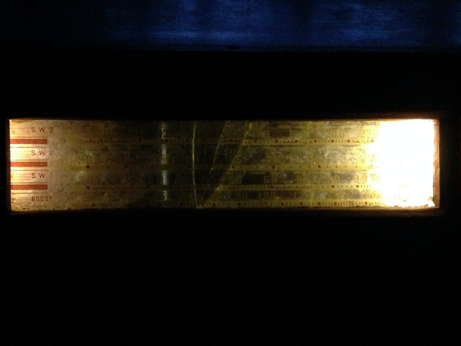

Here is a close-up of the broken dial scale.
[Image: http://www.philcoradio.com/images/phorum...e00041.jpg]
You can't see Greg's fine reflocking work here, because apparently when the scale was broken, someone applied a piece of wide cellophane tape to the back of the dial to hold the pieces in place. Now the tape has yellowed and become hard, as this type of tape inevitably does. Once I have a new dial scale made, this problem will be resolved and the flocking will be visible once again. That isn't going to happen for a while, though.

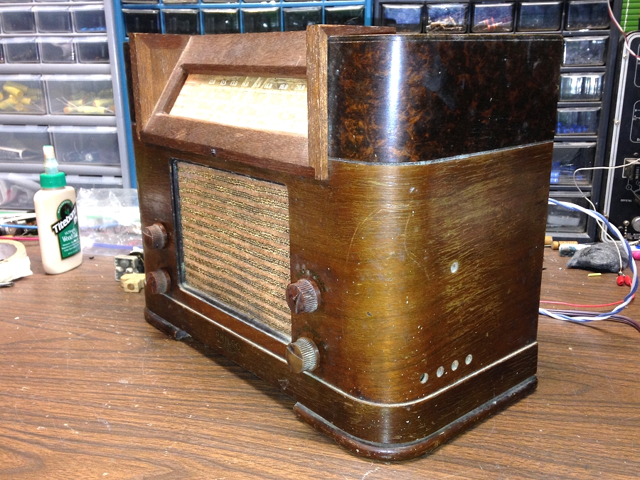

You may recall that I had mentioned holes drilled in the right side of the cabinet, which line up with the alignment screws on that side of the radio chassis:
[Image: http://www.philcoradio.com/images/phorum...e00042.jpg]
[Image: http://www.philcoradio.com/images/phorum...e00043.jpg]
I'm not sure what to do about those. Leave them, and the cabinet will always be an ugly duckling; patch them, and they will always show. Yes, that top band on both sides of the cabinet, going around to the front, is photofinish.
The original speaker was not attached to anything - it is merely held in place by being wedged between the speaker opening of the cabinet and the front of the chassis. This speaker is really too large for this set; it should have a smaller speaker mounted to the chassis as in the 41-240, 41-245, 41-712, etc. But since this speaker came with the set, and the chassis has a short cable with a 3-pin connector to connect to this speaker, I decided to leave it as it was made. It sounds very good and the set plays well now.
So that is it for this Tropic, for now. Perhaps next summer I will do something about the cabinet; when it happens, that will be a subject for the Philco Cabinet Restorations forum.

Use wood hole plugs and stain them to match. Will look more likely to
be there than an open hole or plastic or metal or just open.
[Image: http://3.bp.blogspot.com/_BV7ti_kvK4k/Sw..._plugs.jpg]

That set must have left the factory with those extra holes in the side, it's highly unlikely that some owner would have gone to the trouble of measuring out and drilling such a neatly spaced set of holes that happen to line up with the alignment screws in that side of the chassis. The average owner wouldn't have had a clue that the padders and trimmer screws were even there, let alone what they were for. If the set really was a prototype of some kind I would just leave them there, short of replacing a good portion of the veneer on that side there isn't really any way to cover them up successfully. If you don't want to look at the holes just put the set on a shelf with some books leaning up against that end.
(12-03-2014, 01:24 PM)Arran Wrote: That set must have left the factory with those extra holes in the side, it's highly unlikely that some owner would have gone to the trouble of measuring out and drilling such a neatly spaced set of holes that happen to line up with the alignment screws in that side of the chassis.
Exactly what I was thinking. I'm leaning towards just leaving it as is for that reason. This set is clearly a pre-production prototype...with the sample electrolytics and trimmer condenser bank...and the speaker that is larger than a factory production speaker would have been. I'm thinking that I will try to find a decent 1942 escutcheon (yeah, I know, "Tenite" and "decent" are mutually exclusive), have a repro dial scale made, clean the cabinet up a bit and let it go at that. I would leave this wood escutcheon on there, but it really looks crude. Philco already had Tenite escutcheons of this size from production 1941 radios as well as a few of the soon to come (at the time) 1942 models, so I don't think the crude red oak escutcheon was applied at the factory.

That would be my guess as well. Most likely only the factory using a drill jig could do holes that neatly spaced. They even chamfered the edges. My question Ron is how do prototypes get out into the hands of the general public? Sure couldn't see that happening these days.
