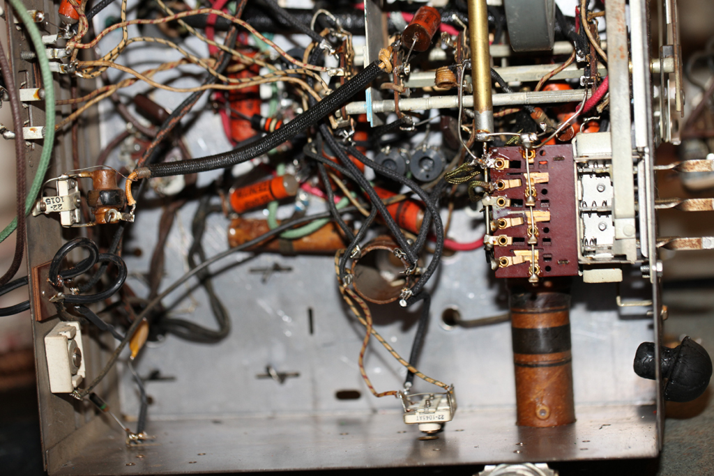

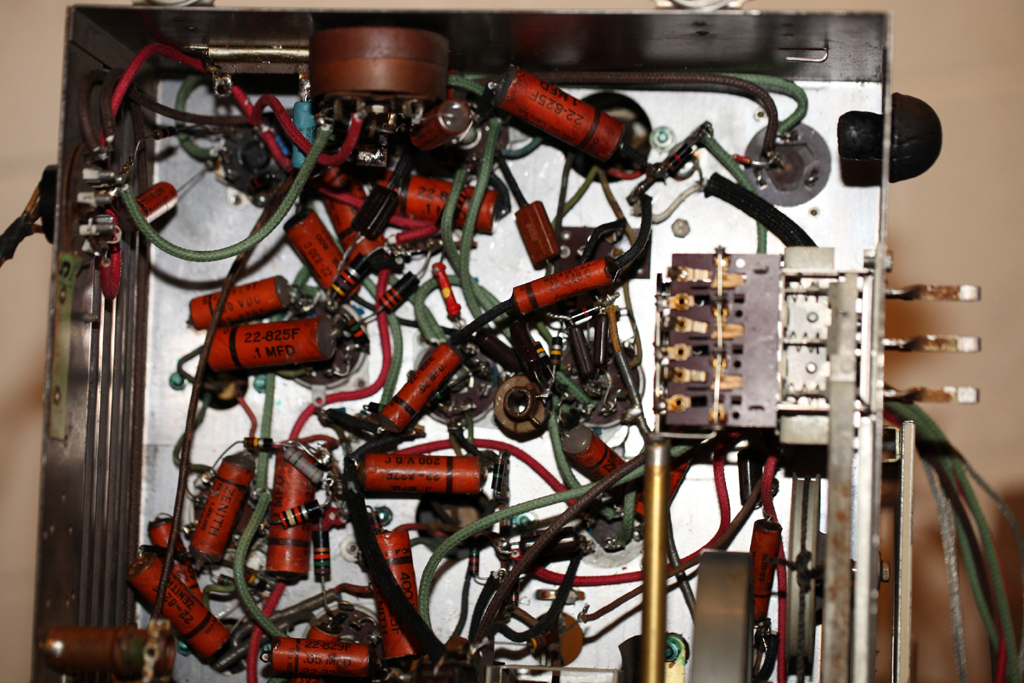

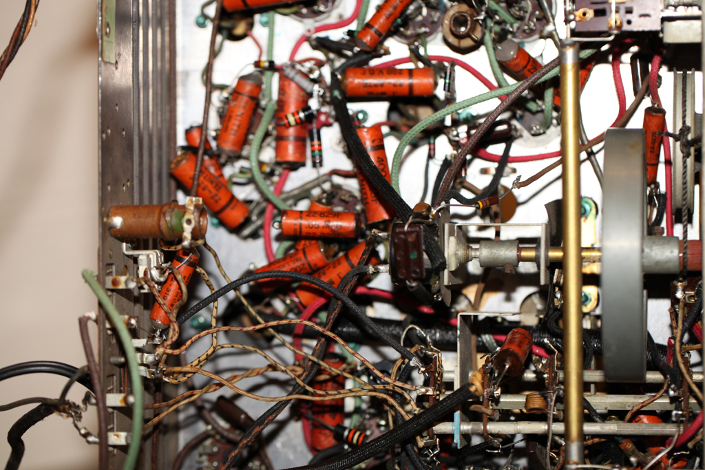

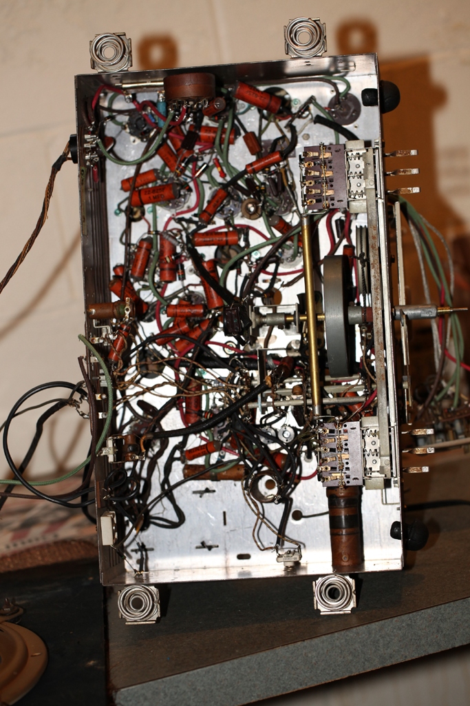

Done with the rewiring and recap.
The shielded wire came Friday; I now have a lifetime supply of it. So this allowed me to finish.

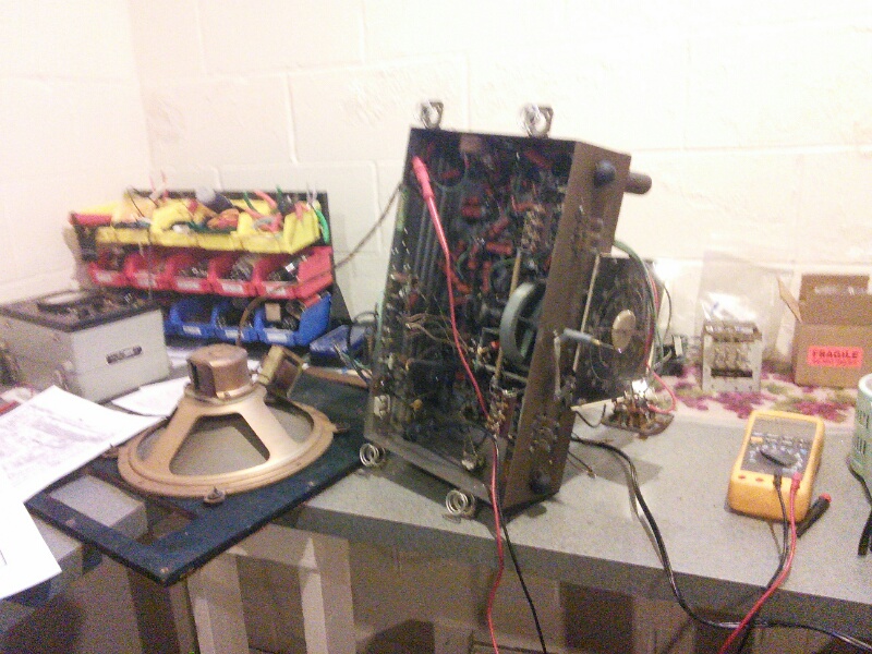

Wow what a voice, and this is without the cabinet.I tuned into 1310/1160 AM, they play 60-70s, and.....wow. Cant wait for it to go into the box.
The tone ctl is very efficient.
No antenna at this point, the station is local.
The repertoire is great to prove the music on the radio - In the summertime by Mungo Gerry, Girl you will be a woman soon...
Now to the story. (I will post this and then append it).
Posts: 15,304
Threads: 532
City: Jackson, NJ
This day didn't start well, I went to transfer my vinyls to tapes only to discover that the cassettes I bought from a vendor (great tape - BASF super chrome dioxide put in their cassettes) have cracks and sone debris are in the packing box that came 2 weeks ago. I have yet to talk to them.
Anyway, my mood was low and I decided to proceed with the radio.
Cleaned the bench that was filthy, vacuumed about a jarful of debris of rubber insulation from the radio.

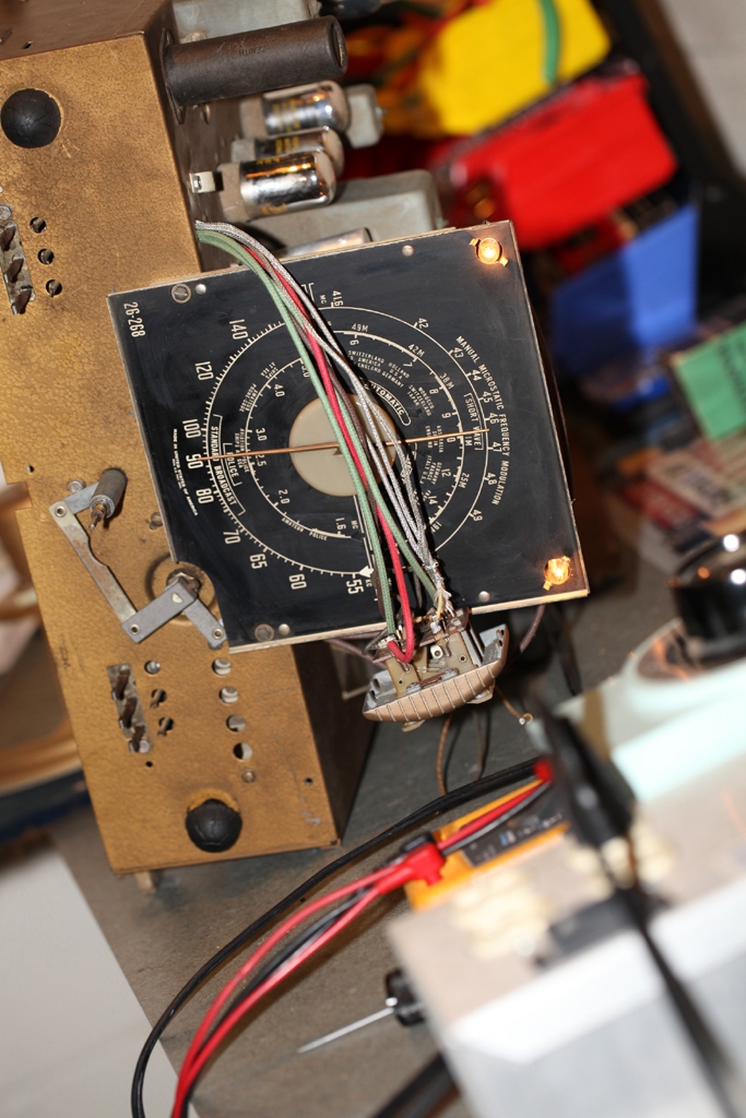

Checked the transformer. Good. Realized the pilot lights were not wired: I threaded the wire but did not fix the sockets. Took me 10 minutes to fix the sockets. Put the lamps in, one works, one doesn't. Swapped them places, then the one that worked kept working and the other smoked the filament. What do you know, a bad lamp. The next one worked fine.

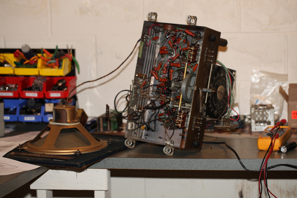

Then I realized I need to have the speaker on the bench. Well, I need it out anyway - will have to change the cloth.
Took me about 30 minutes to understand how to take the speaker board out.
Connected the speaker, checked the B+, saw it rise and droop, touched the grid of the 42, heard it buzz.
Switched to the BC, and quickly got the local Jersey Shore station. This speaker rules! I didn't expect the sound this big from any speaker outside the cabinet.
Well, need to clean the band switch, possibly the volume ctl, and tone ctl contacts.
I am not sure what to do with FM circuit, it is the old FM and will not work. To build converter....maybe in the future.
Alignment is pending. Plus more thorough check, many radios will work with the 1st RF stage not working. Though alignment will tell if it is OK.
Well, something good today.
