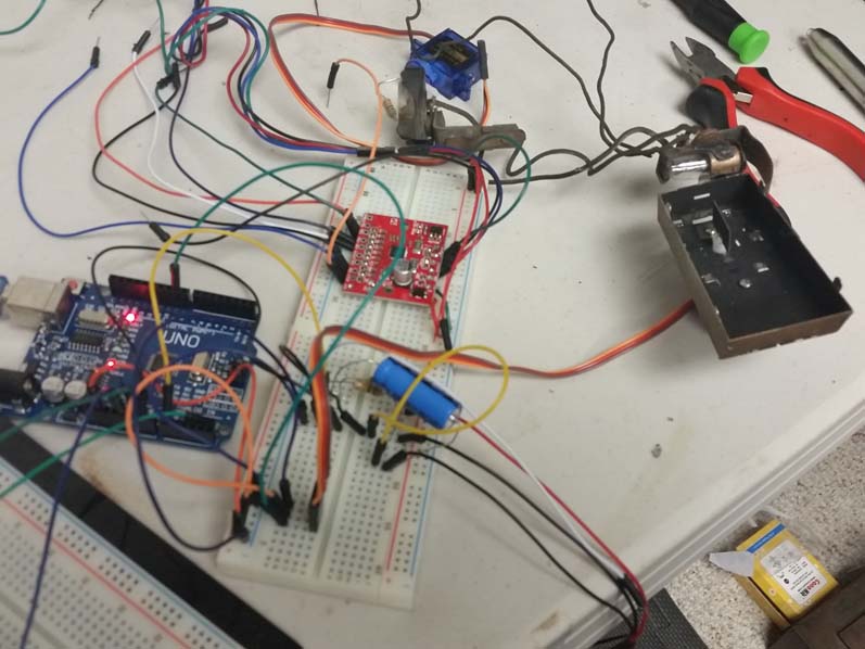

I did this project a while back.  My son was in town and insisted he film it.  -- Mark K8KZ

I was looking for something to use an Arduino for. Icon_biggrin

What's in the blue box?
(09-25-2018, 01:10 PM)morzh Wrote:  What's in the blue box?
I don't know but I'd guess a signal controlled motor to adjust the vane of the indicator.

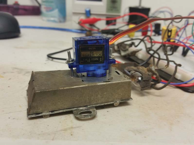

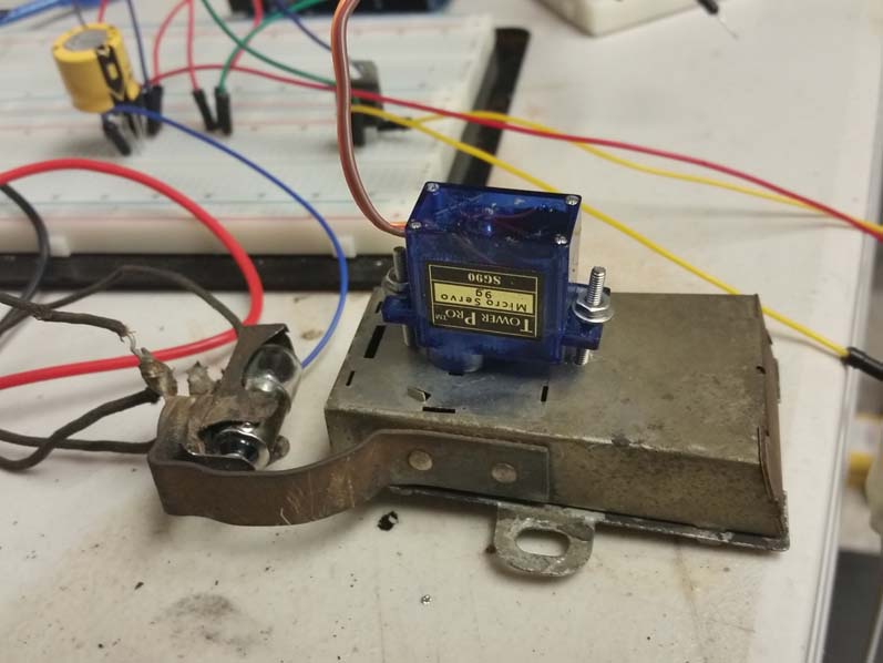

It's not a great solution. It is a little slow, and you can even hear the servo make a bit of motor noise as it turns. The servo, the little blue thing, takes commands from the Arduino microcontroller to turn to an angle between 0 and 360 degrees. I did it as more of a novelty than anything else.

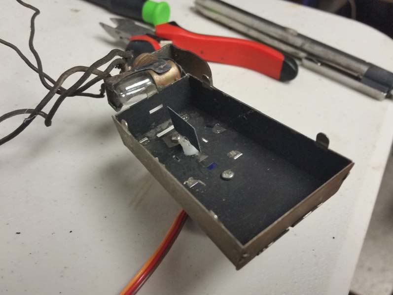

I am usually one for authenticity, and this is reversible if I get a working shadow meter. I tried rewinding the coil twice, and I couldn't seem to get t to work very well.
Mark
Have you tried to re-magnetize the magnet?
A Galvanometer, yes, that's the word, I must have been a bit off when I typed that. But still, the shadow meter movement should react much like a magic eye tube if it's working properly, charging up the magnet is a good idea.
