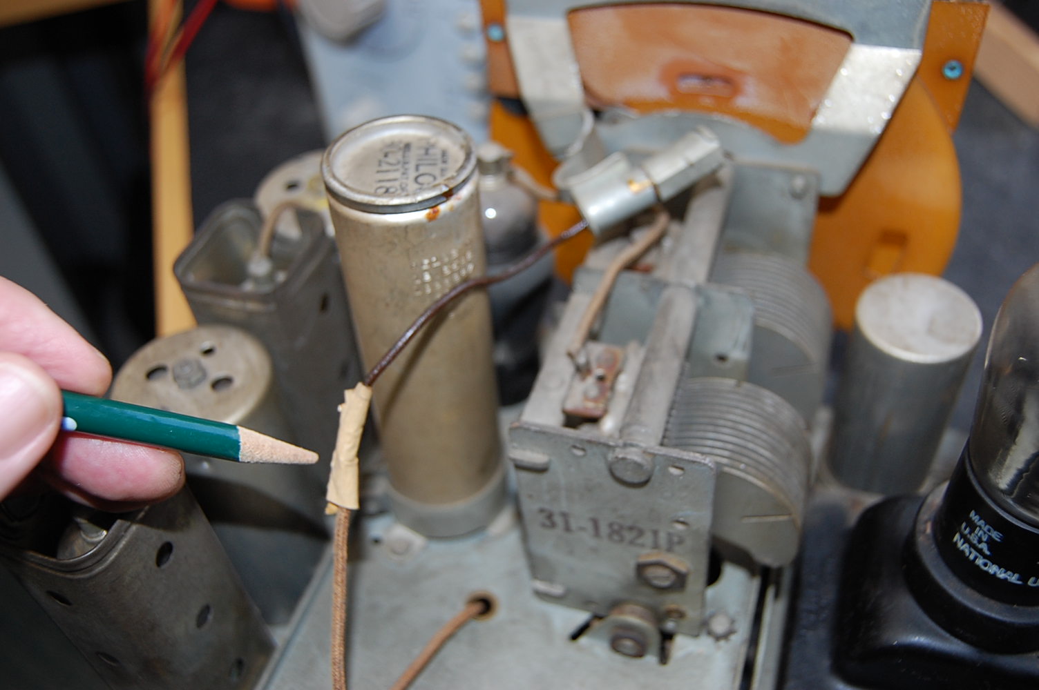

[attachment=18275]
This dial lamp doesn't look right to me. Someone spliced a wire with a #47 lamp and holder. Can somebody here tell me what should go there or if this is correct.
It can but it's a repair. The original used a blob of rubber inside the holder that over time gets hard and brittle. This in turn make the bulb difficult to remove. Probably someone replaced the lamp assembly instead of rebuilding the original.

Go to a auto parts store and see if they have rubber grommets. Most do. Buy a grommet that fits inside the bulb holder socket. run the wire through the hole in the grommet, and presto, you have a bulb holder with new rubber. I have done this and it works. You may need to shave the grommet down a bit for the bulb to push in easily, but don't take off too much. It needs to have some spring to it to make good contact with the center contact of the bulb.
The dial lamp holder you have isn't correct for your radio. I don't have a photo of the proper one handy, but it includes a hood or funnel, for lack of a better term.

I think your dial lamp should look like this.
https://imgur.com/j1AG5j2
Thanks Mike! That's it!

Thanks Ron and Mike, that is awesome information. It's hard to see on my photo because it's out of focus but someone had bent the bracket to accommodate a slide-on lamp holder and then discarded the hood. As it is the lamp throws very little light onto the dial. I read somewhere that a guy used a small funnel he found at a dollar store that worked pretty well. Or maybe I'll run across an original bracket/hood someday. The two links you guys posted are excellent. I suppose a common #47 lamp will work? Thanks again.
Randy
The original was a #55 lamp. A #47 lamp won't put out enough light to adequately illuminate your dial.
I prefer to use a high output LED lamp such as the following from Pinball Life (you'll want the warm white to mimic the color of the original incandescent):
https://www.pinballlife.com/ablaze-4-smd...-lamp.html
These are kind of difficult to get into the lamp holder since they are short (no lens), but worth the effort as they are somewhat brighter than the #55.
Of course you'll have to get an original dial lamp holder. The rounded "funnel" end of the original holder does make a difference in properly illuminating the dial.
