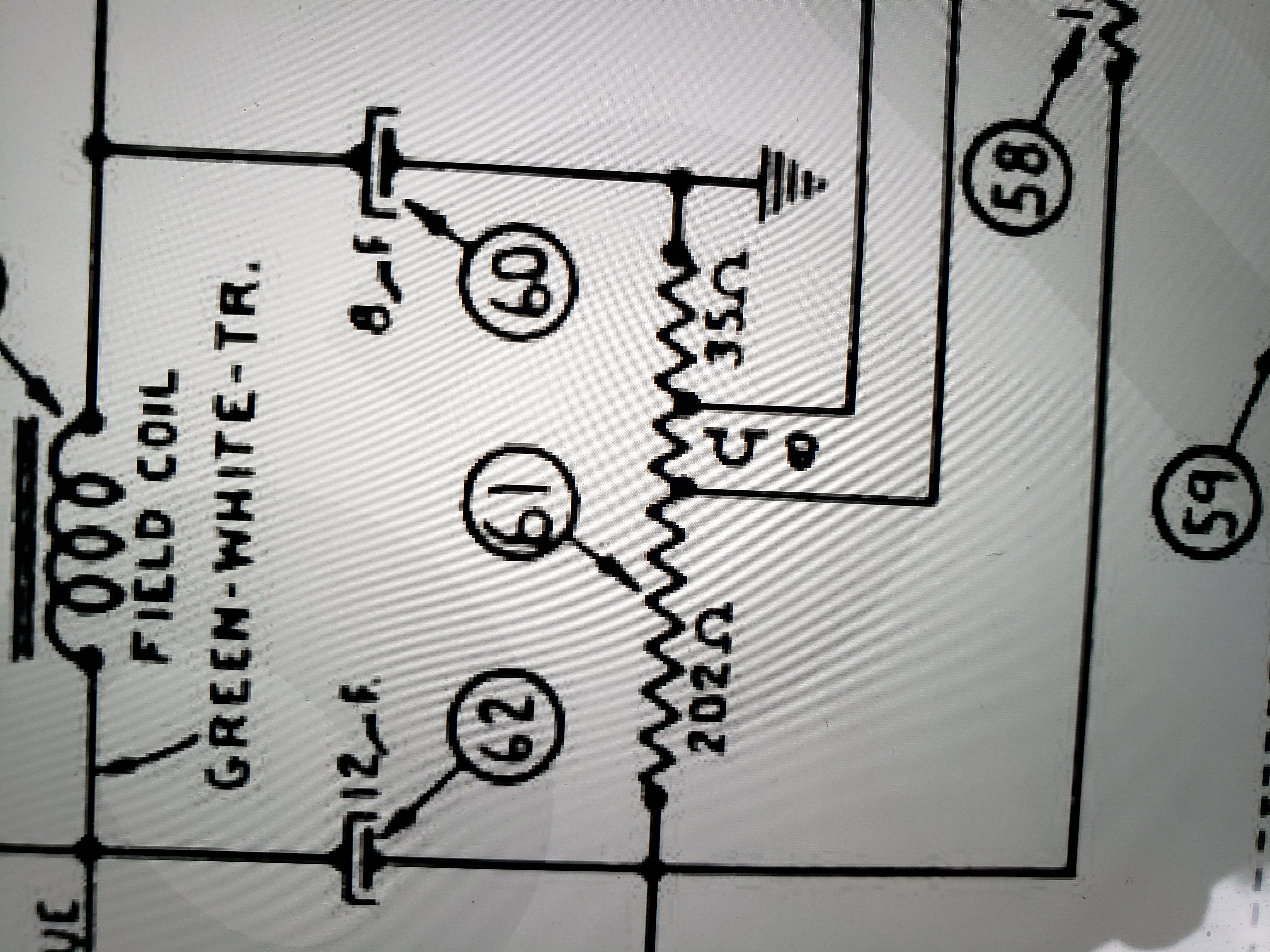

I am replacing the candohm in the picture attached (#61).
In the Philco Phorum I read that the 202 is ohm 20W, 8 ohm is 2 W and the 35 ohm is 5W.  I am considering using Vitrious Enamel Power resistors but the values are not exact unless I stack resistors.  Stacking is not an option with these because they are each 1.75 inches long and space is limited.  What I would like to do is use a 200 ohm 25 W, 10 ohm 5 W and 33 ohm 12 W.  The question is, how exact should be the replacements?

I'm coming up with a bit less wattage than you. The 200 ohm section actual dissipation is a little more that 1.6w. So a 7.5 or 10w unit would be a good choice. The other 2 are under 1/2 w so 2w would be fine. Figured based on 90ma current flow thru the hv winding. Could be less.

I am with Russ those are good resistors and far as the value with in few ohms is not a big deal Because the voltages nowadays are higher and your filter capacitors too .

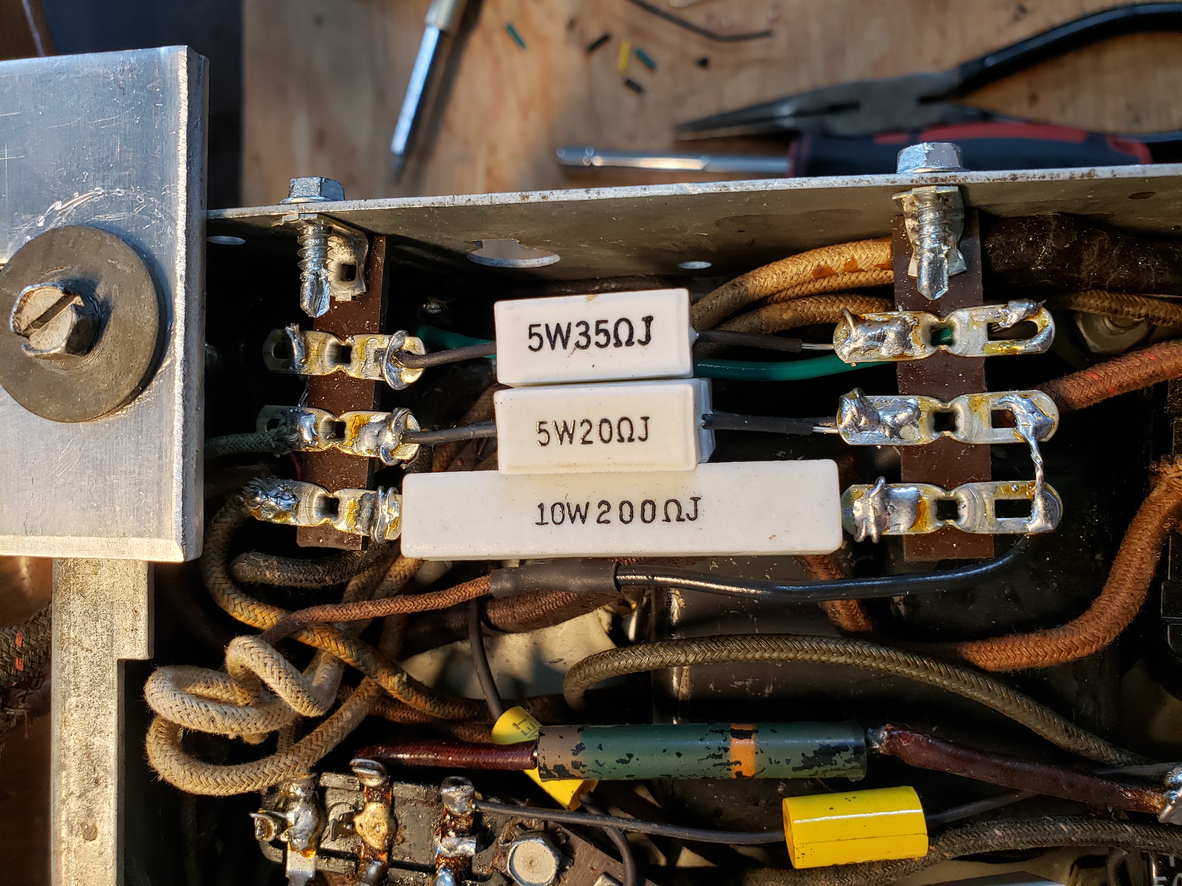

Thought I'd post a picture of the replacement I made for the 3 section candohm.  Found enough parts in my existing supplies to make it work.  The 5W 20 is two resistors in parallel to get to the 10 ohms needed. The Radio is now working well.
Glenn
Looks great Glenn.
