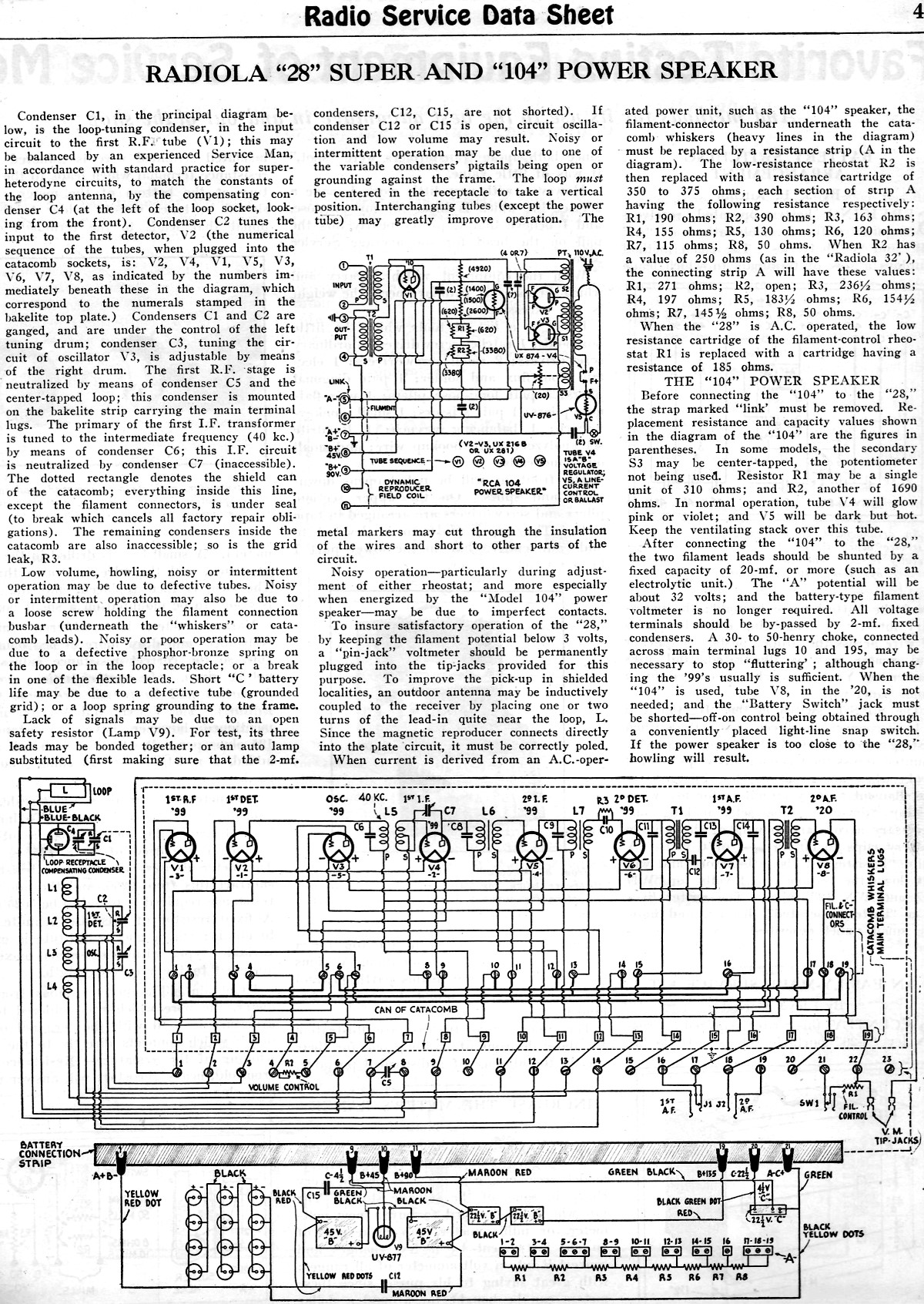

It appears the volume control for DC operation only controls the first IF, there is some convoluted routing for the filament connections to do that.  So indicated, the resistance cannot be some 200 some odd ohms but must be around 30 ohms.
I cannot find any other clear notation of the original value...
To save hinting for reference schematic here is the Gernsback for DC with jumper strip, note AC resistance strip is off to the lower right as a group of resistors, unconnected:
One has to wade through the conversions for the Radiola 25 (ignore) to get to the Radiola 28 info.
Reverse engineer the change over for AC. Note the mention of a connection. In particular, page 14 which describes a re-positioning of Whisker 16 to terminal 19 from terminal 17. You will move it to terminal back to terminal 17...

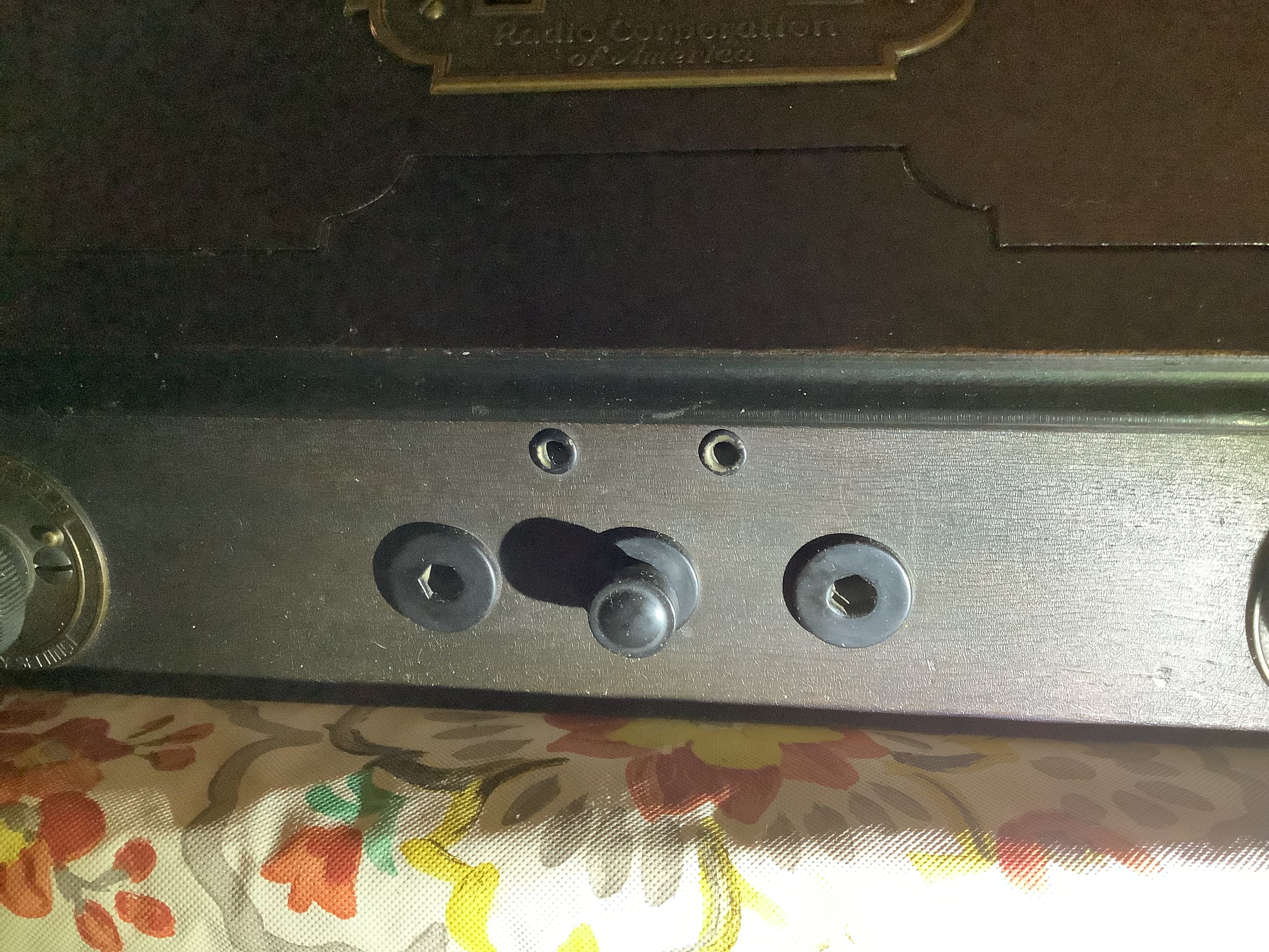

What is the spacing of the two filament test jacks and are they horizontally placed?

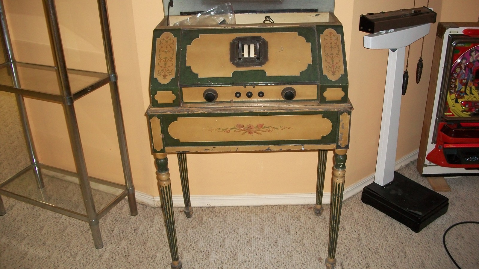

Take a look at this uniquely finished 28 done back in the 20's. Download the image so it can be blown up to see the detail...

The filament test jacks are horizontal and are 1 1/4” center to center. I’ll double check my work for shorts.
Wow- that 28 is a good looking piece of furniture. The 1920s were something else!

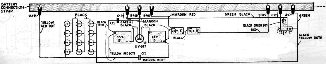

The caps are C12 & C15...
In other Radiola catacomb data these are shown to be 2mf, each.
The schematic seems to indicate that they are not part of the frame but part of or an extension (wired) from the terminal strip. So, may be in the battery box below if need be...
Think, if the ARBE is going below, you can extend a pendant switch to control it, the caps could go across the ARBE and for that matter could even be modern caps as they are out of view even if the the lid is opened. The ARBE provides a noise bypass only on the 135v connection...

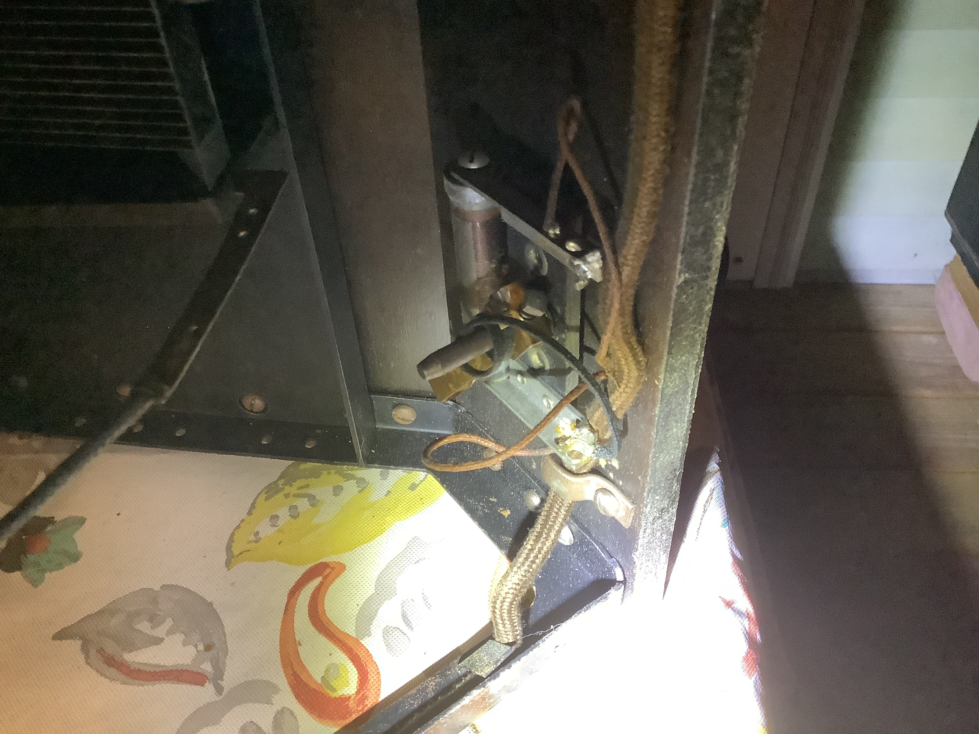

Thanks for the parts! It looks like cap C12 goes inline between 45 v. B+ to A+/B-.
Cap C15 is a bit more confusing. Lamp V9 - is it normally part of the circuit or does it serve as a safety device? Since it’s not in the radio as it stands does cap C15 run from 45 v. B- to 45 v. B+ or to the 90 v. connections? Inquiring minds want to know! I’m sending a couple of pictures showing where things stand. -Rob

Cap C15 goes inline between `90 v. B+ to A+/B-.
There is no cap bypassing the 135 volts...
All the wires going to the UV-877 lamp should be connected together, soldered and taped. That same connection is to C12///
The lamp was an early solution to careless battery replacement.

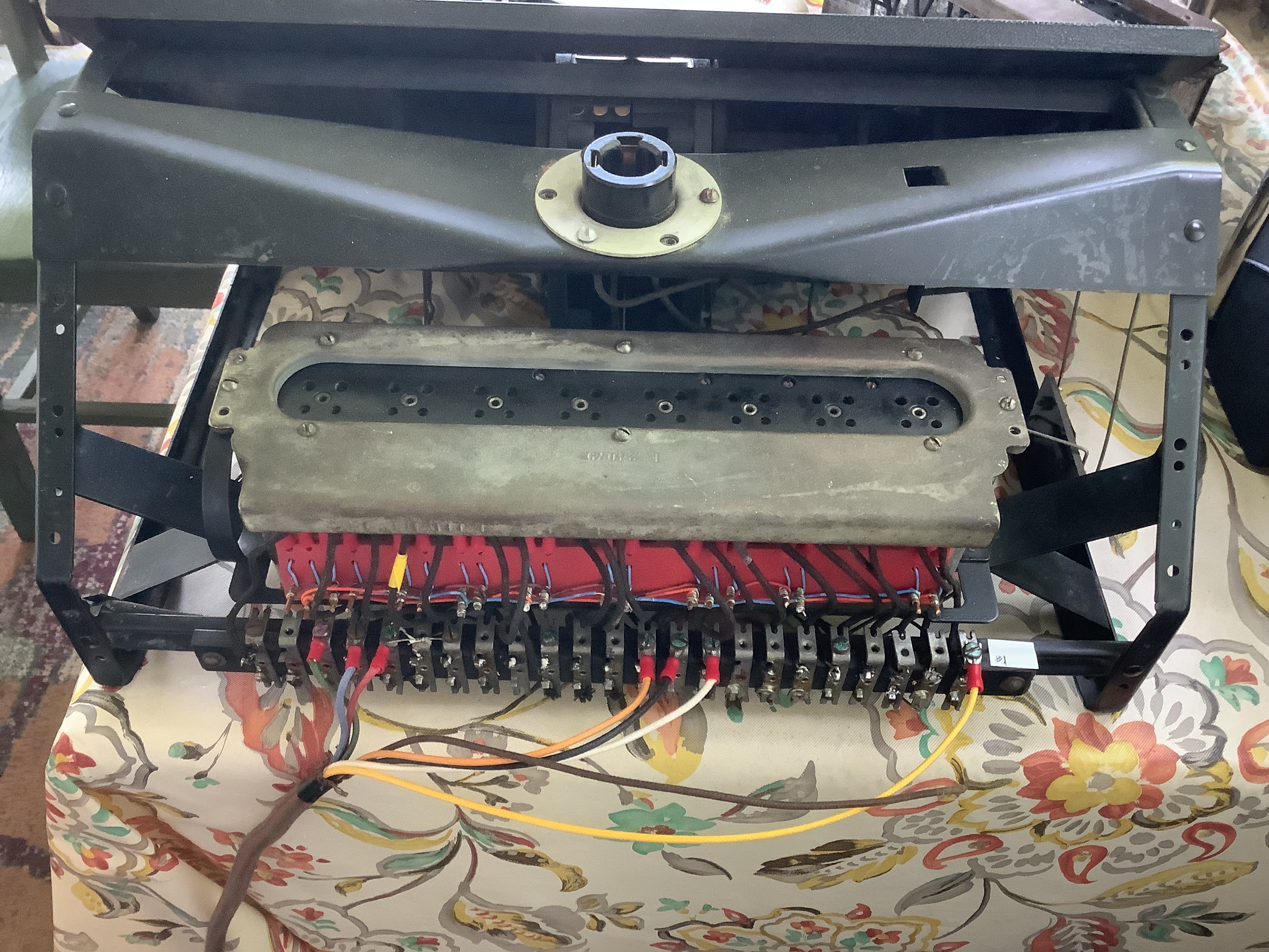

The volume cartridge is installed as well as the caps. Ready to start checking voltages as well as my workmanship. I also need to see how good the tubes are and address that as well. Stay tuned……..

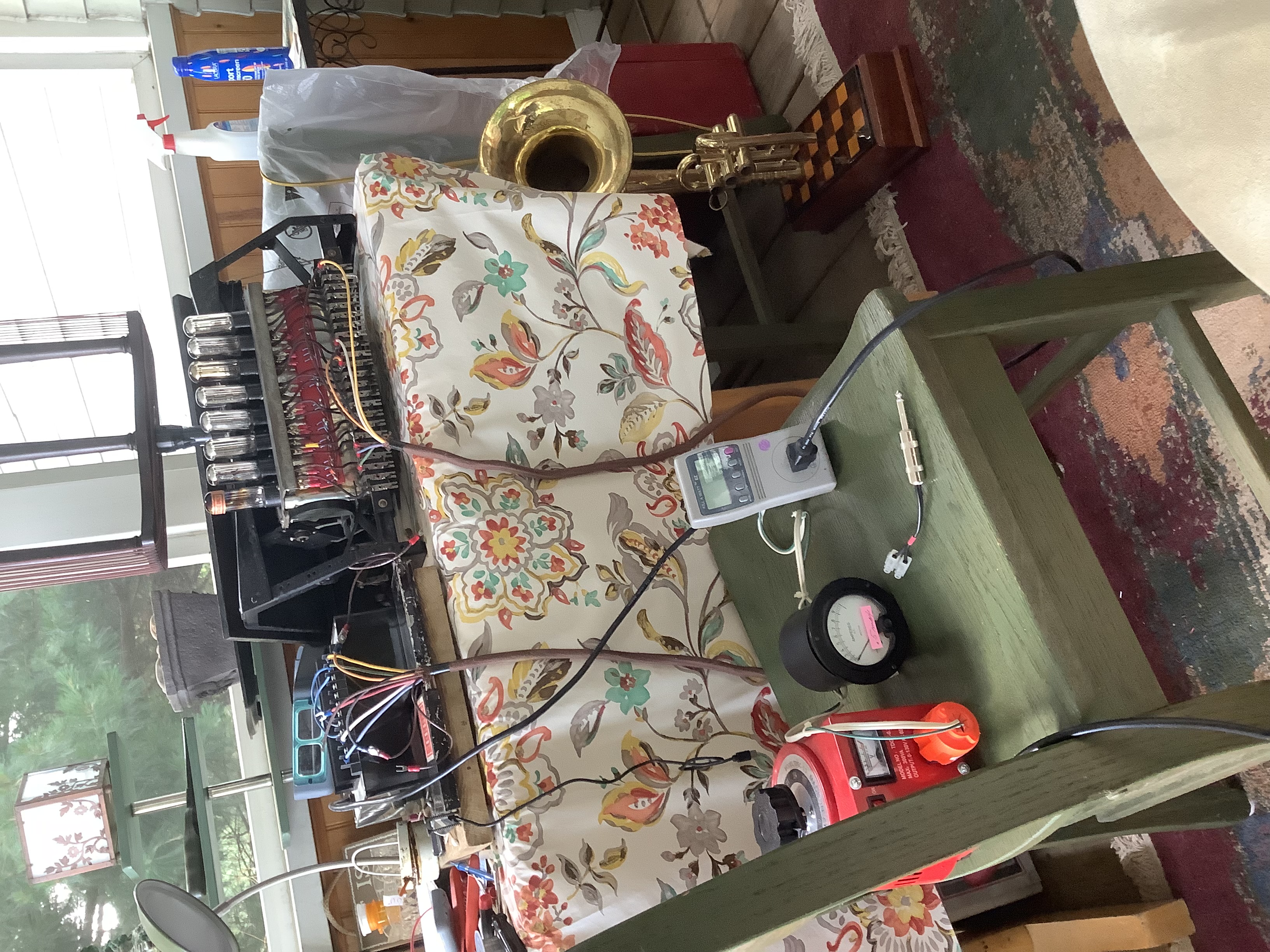

I checked and installed tubes, hooked up a speaker and made connections to the ARBE. A slow power up showed partial progress.  The A voltage shows 3 v. and there’s static in the speaker. Tapping the tubes produces a ringing sound that slowly fades (microphonics?).
This is generally what I expect at first power up. I see about.1 amps at 110 v. Will continue to check continuity and run things down with the RADIOLA manual. Getting closer but no home run! - Rob
