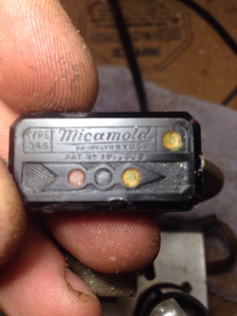

This just exploded so I  need to replace it. Is it a 100 mmfd cap? Meaning .0001?
Kirk
Looks like it's 2 o ooo @3oov But some of those postage stamp cap are screwy to decode.

So it is .0002?

What did this cap come out of ?  Is there a schematic  online for it?? Just want to double check to be sure.
Shoot an email at: tbs50a@aol.com Busy this weekend next is open.
I believe this is it. line up matches.
http://www.nostalgiaair.org/PagesByModel...021845.pdf
Kirk
