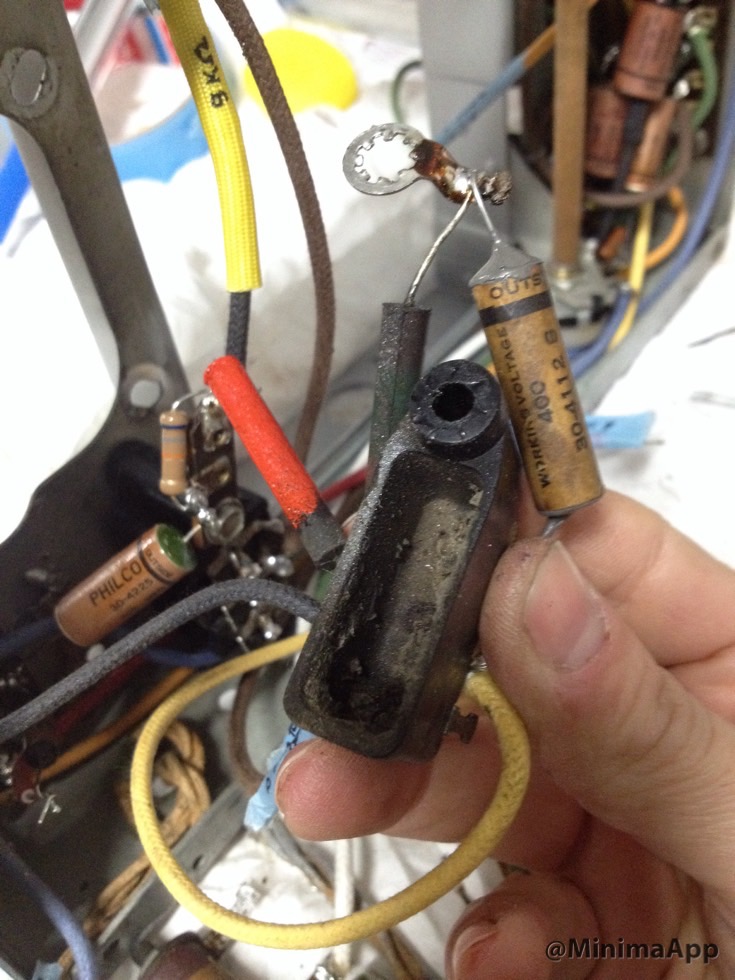

If you look back to your post #13 you'll see that same cap block with a small Sprague cap solder across two of the block's terminals. This Sprague cap wouldn't fit inside the block so it was soldered to the outside to replace the one on the inside (the missing one).
GL
Hi Terry, yes I think the same, I was surprised that someone before did the dirty job Icon_smile now I am about to buy new grommets for the tunning unit and make a Test with a variac, any recomendations with it? Should install a fuse in the main power cord just in case?

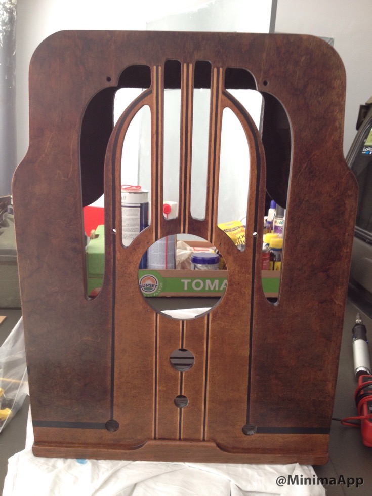

Now I am waiting for some grommets and spares from USA I am doing the cabinet, I found a paint or some kind of protection that was applied only inside and in the bottom grille that has a silver particles, what it is? Also I printed my own stickers, for the faux finish I tried to paint and shade with tonner, not exactly the old finish but still I like it
The refinish

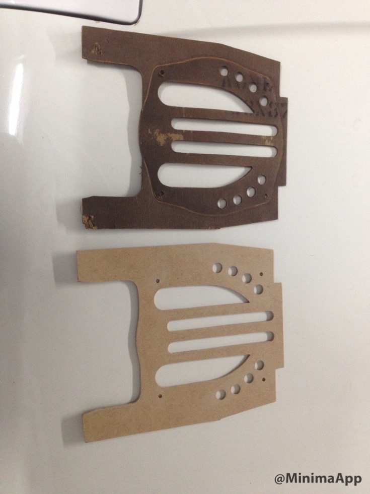

The speaker cardboard in bad shape was redone

The cabinet looks great!!!
