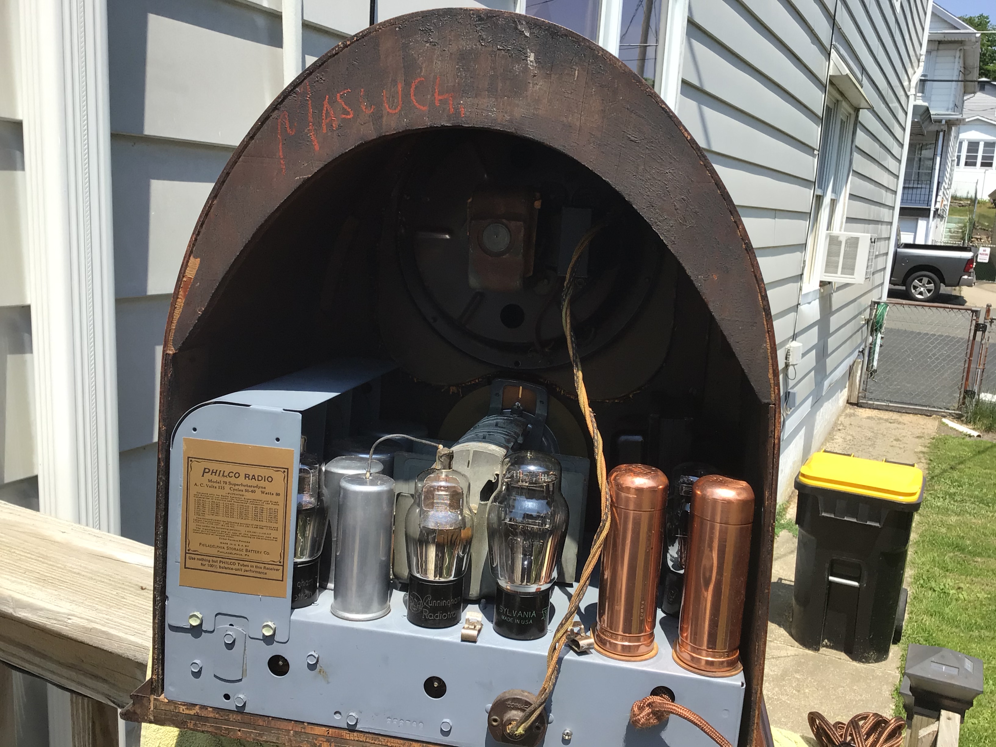

Ok, just about ready to button up this radio, replacing grille cloth soon. Replaced all the caps, checked resistors, checked the multi section wire wound resistor, tested tubes and did alignment. The only thing that was bad was the primary for the first detector transformer #6 on the schematic was open, plate circuit in the RF amp. I was able to rewind it no problem. The set isn’t particularly sensitive, better at night as expected. Tried a new set of 24s with no difference. All voltages check out. I’m wondering how sensitive of a receiver the model 70 is? One thing I noticed in checking all the coils in this set is the antenna transformer #2 on the schematic, is constructed differently from most coils. The primary is wound on a separate bobbin mounted at the top of the coil form whereas most are wound directly over the top of the secondary. I was kicking around the idea of winding a new primary directly over the secondary like most are, to see if it improves any. Thoughts!

l love those paper tube testing labels you occasionally see, how they took the heat and survived, who knows.
Nice job and some sets even if not super performers are cool, they made all kinds for all customers.  . Enjoy.

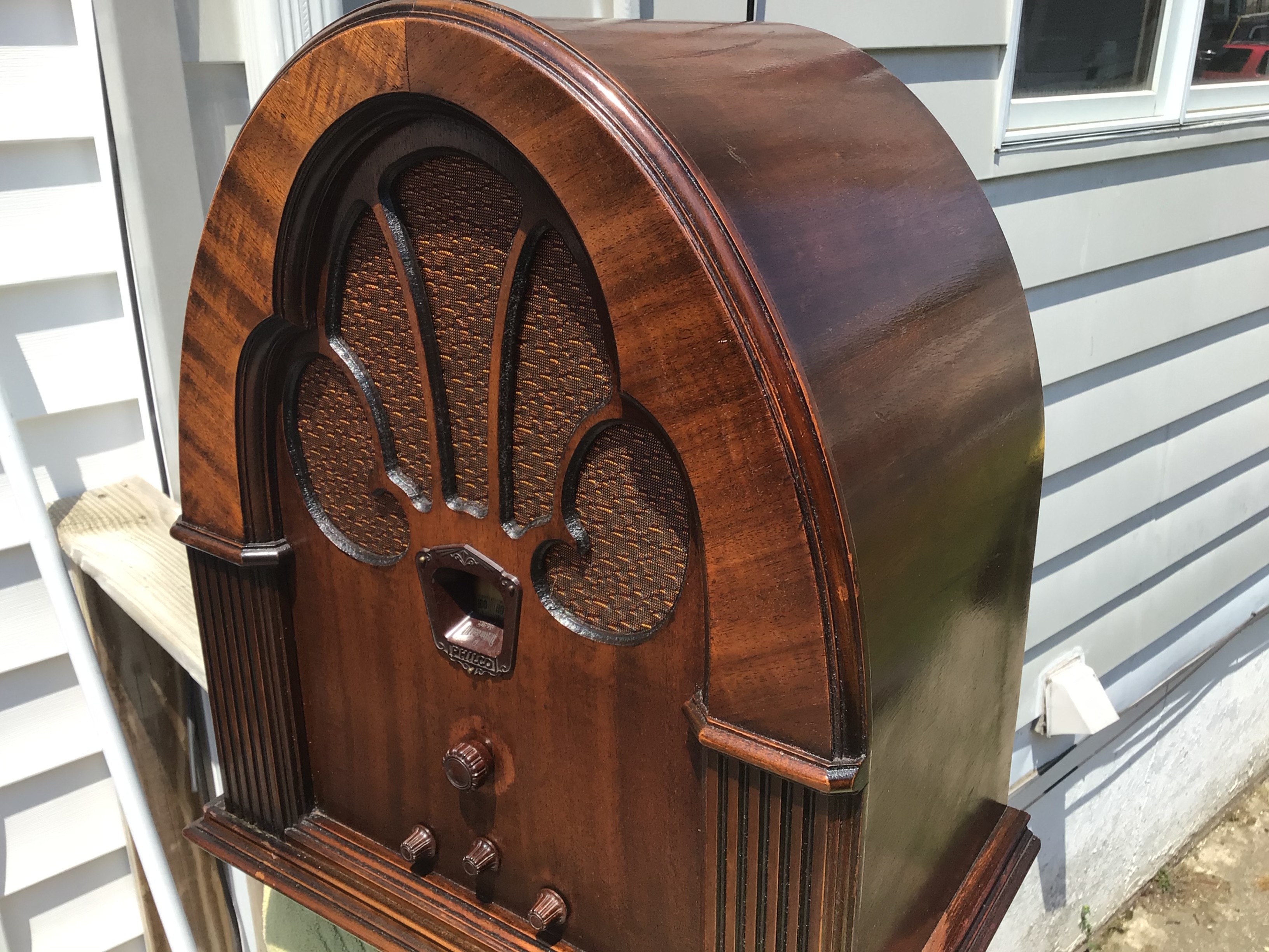

Radioroslyn Wrote:But there isn't a good replacement for the 70/90 grille cloth.
Ah, but there is...
Michael Katz is back in the grille cloth business, and the first cloth on his list of current offerings is Philco 70/90 cloth. Please see this post:
https://www.philcoradio.com/phorum/showt...?tid=22498

Thanks Ron, I already got the whiskey rayon cloth from Richmond Designs. Just need to install it. What do you think of me wanting to wind the primary of the antenna coil on top of the secondary instead of using the primary that is wound on the bobbin and mounted to the top of the coil form? I’m thinking it would get he more signal to the secondary and maybe making the set a little more sensitive!

Thanks Terry. I guess I wasn’t very clear when talking about the antenna coil. Everything ohms out good on mine, no opens. Primary comes in at 50 ohms. I was just surprised to see the primary so far from the secondary, not wound on top of it. I thought it could be a little more sensitive compared to some others I have. My antenna is little over 15’, I know, not stellar! I have finished it up doing the new grille cloth last and I left the antenna coil alone. I will call it finished. Thanks to all for your input and to Rob (rfeenstra) for graciously printing new labels for me!
