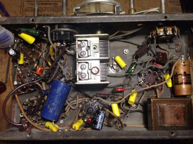

Is it ok to use. 450 volt 8 mfd I. Place of a 500v?
I am working on a halson 50R and the 50x has the same tube lineup.
http://www.nostalgiaair.org/PagesByModel...008951.pdf

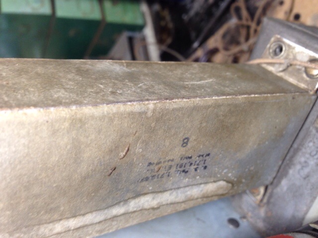

I am replacing the ecaps and there is that infamous box cap. It says 8 on it. But under it the positives are cut. Could this 8 @ 500 be the replacement?
Here are some pics
Kirk

And this pic
