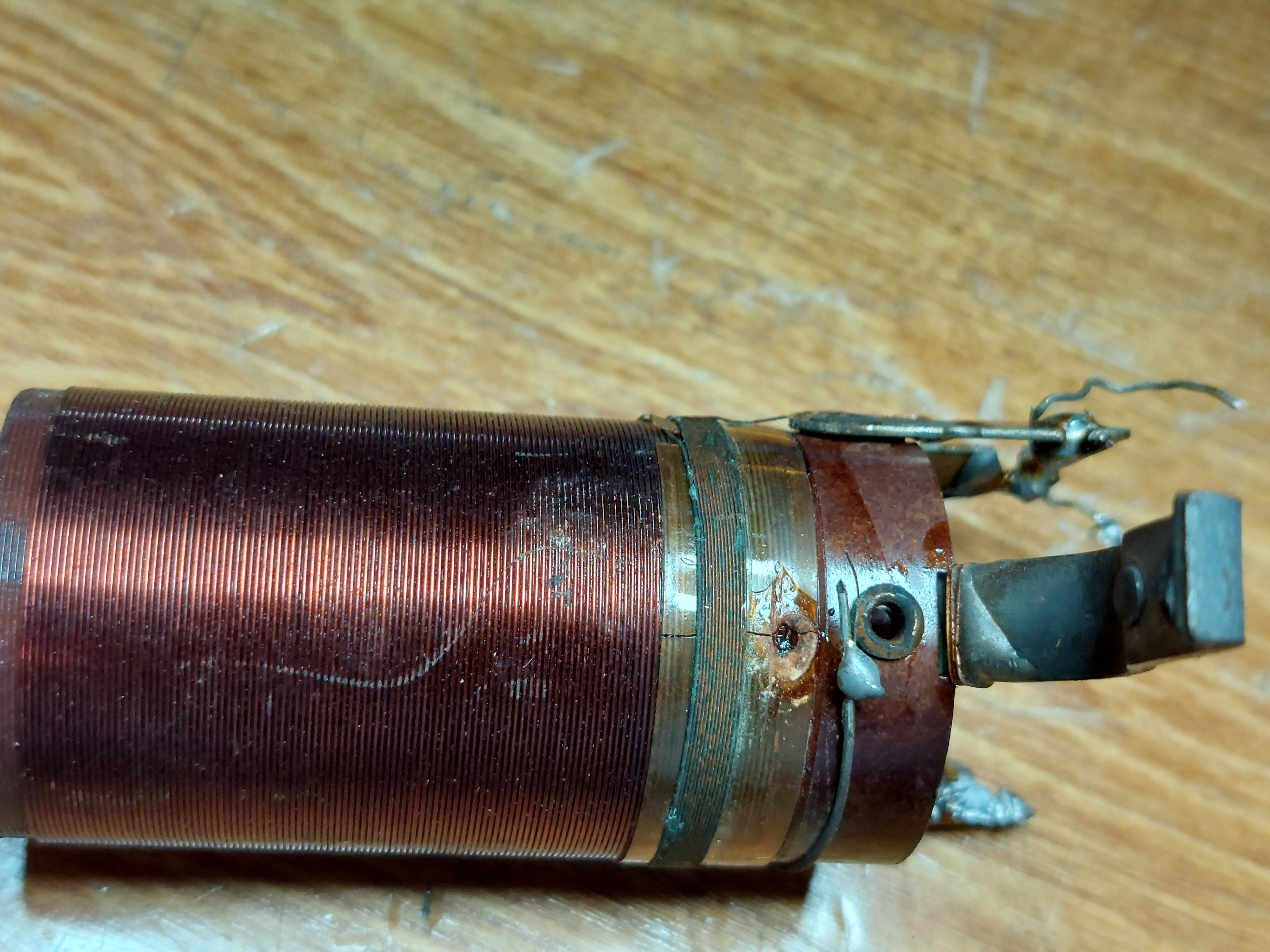

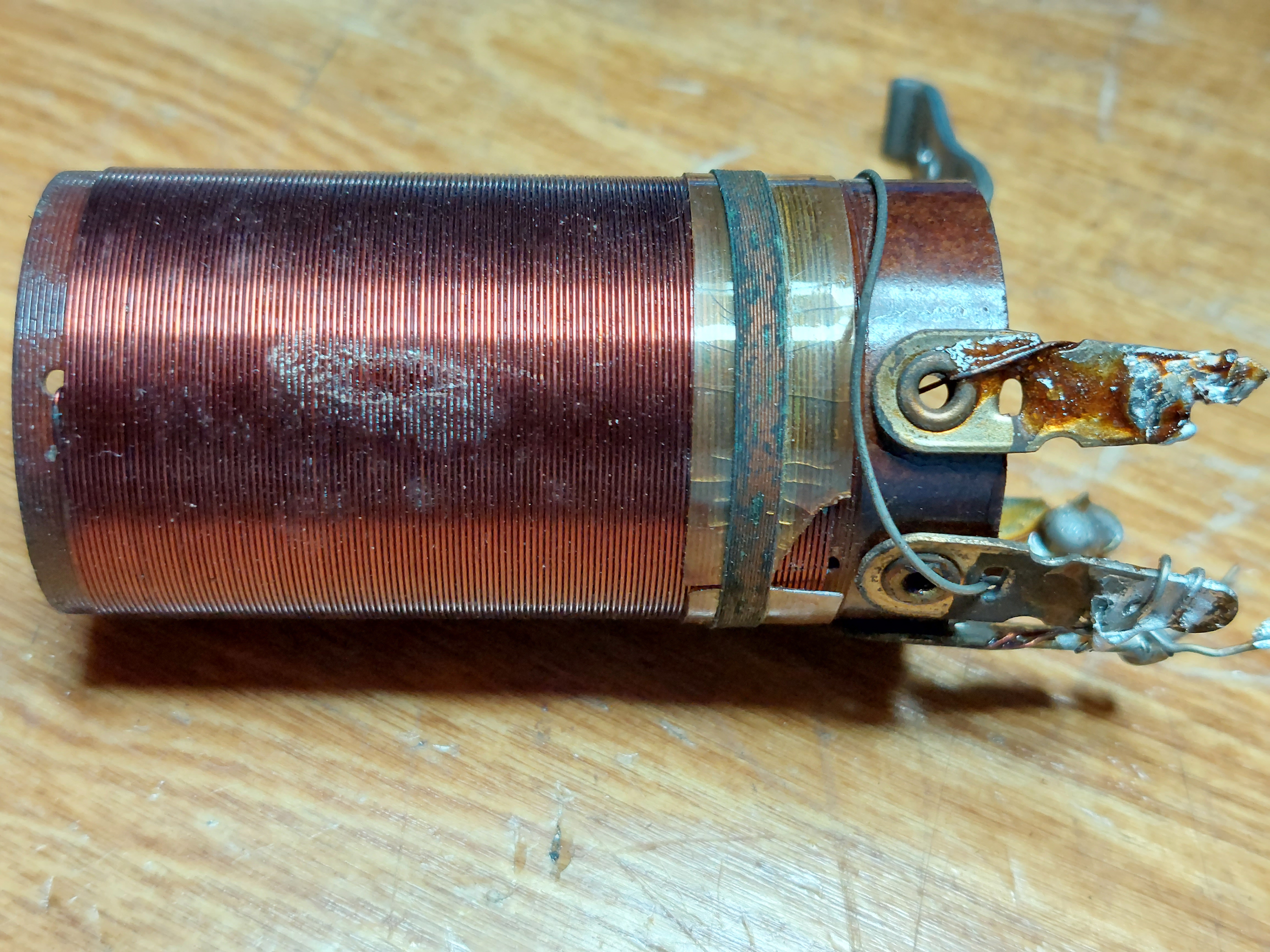

Voltages seem ok except 2nd RF, no voltage on plate. Looked harder and looks like the 2nd RF Coil has an open between the 100ohm resister and the wire to the plate.  Looked even harder and it looks like someone had tried to repair it at some point. I guess to remove it, just unsolder and lift it out the bottom. I am not good with coils and could use some advice. Should have done better at checking things. I do get a hum from the speaker.

Need help on how to fix the 2nd RF, enclosed pics.
I would appreciate any and all help.
George

Up at the top of the page. Just do a search on winding coils. There are lot of posts about this. It's a common problem with the older ones.

There's a couple of different ways to do it. One is drag a pin down over the winding and count the number of clicks. This will equal the number of turns.
Another is to unwind it and measure the length. Cut a replacement piece of wire the same length and wind it on.
Measure the width of the winding and wind a replace winding to the same width.
The fortunate thing is that it's not part of the tuned circuit so it's not super critical. It's there to transfer the rf signal from plate of the former stage to the grid of the next, supply the hv to the plate, and help match the plate load resistance.
It wouldn't be a bad idea to replace the celluloid strip under the winding and replace it with a strip of modern plastic. Somewhere around there's drawing w/measurements of it.
I would use 38Ga wire.

By magnifying the picture of the coil to maximum and then counting the individual turns, my old eyes come up with 14 turns. Not sure that direction..cw/ccw matters on antenna or RF coils but is critical on oscillator coils!

Got the magnet wire and have spent two days trying to rewind this thing. Cut a piece of blister pack and cant seem to keep the wire strands close together. Dont know if it is my lack of coordination or experience or both. Anyway, I am still working on it.

right or wrong george, the way I did it was with 3M electrical tape instead of that plastic; wrapped sticky side out, and overlapped just enough to keep it secure. That way, the wire clings to, and stays put on the coil...
