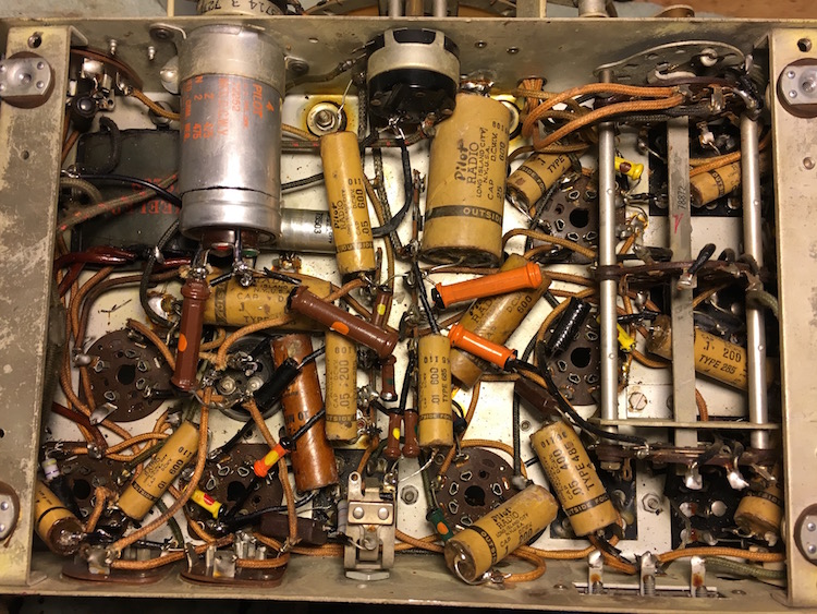

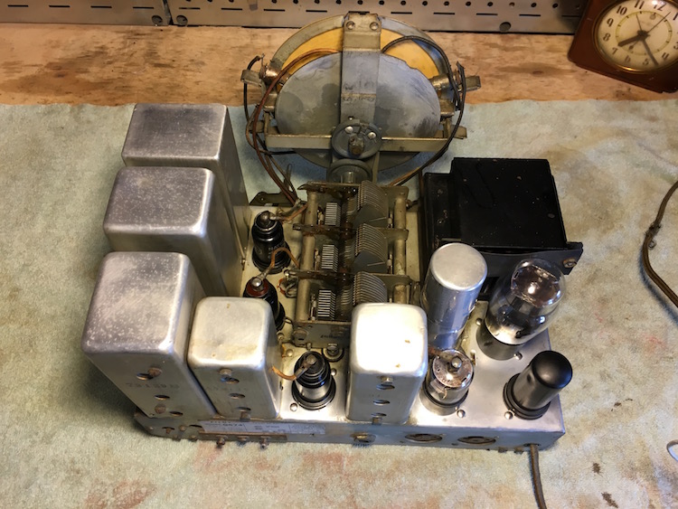

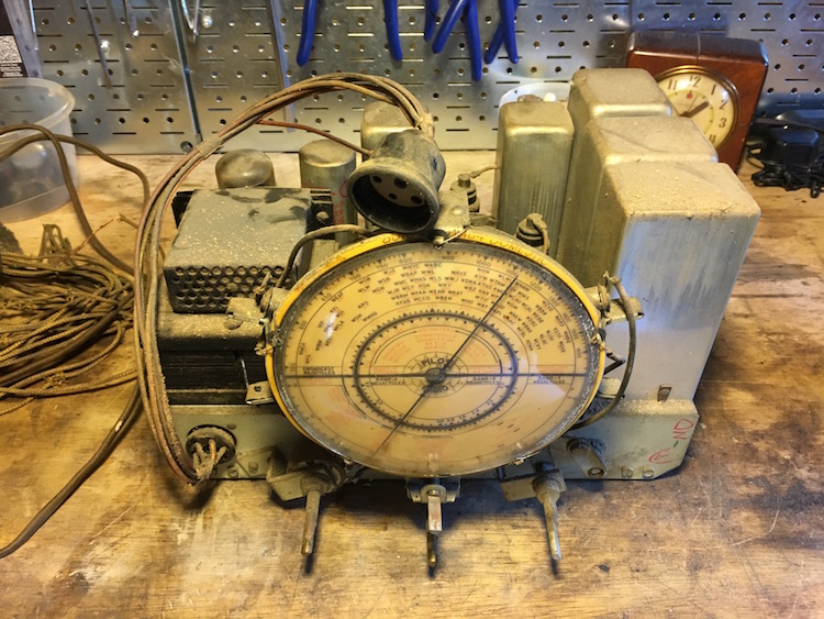

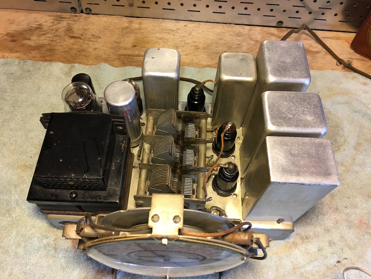

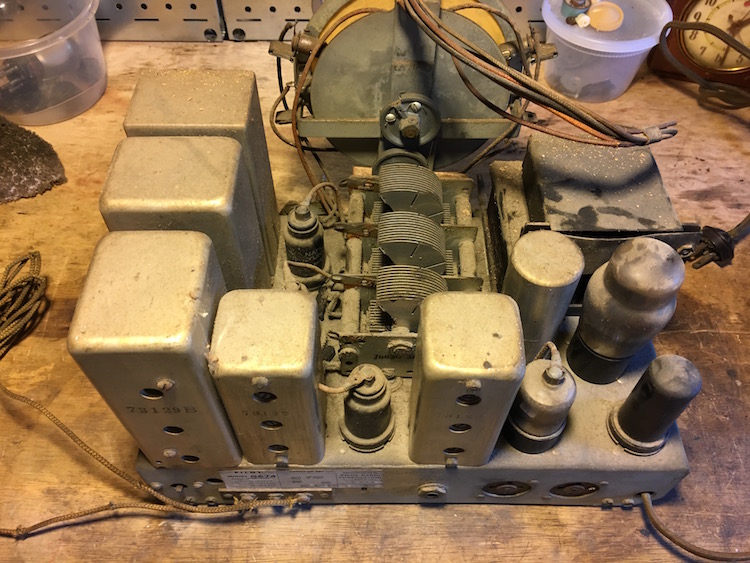

I finished my Pilot G-674!
I dismantled it, cleaned it, did a full re-stuffing recap and resistor redo, and put her back together.. First picture is the before and last is the after.

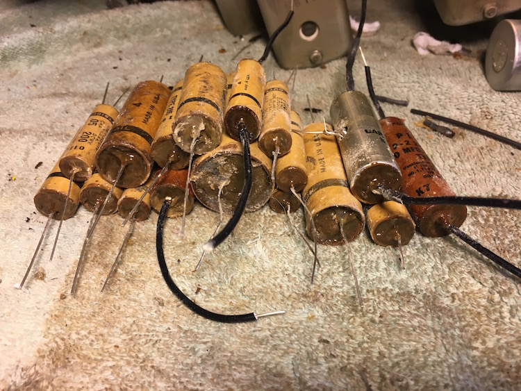

I removed all the caps and labeled every wire since I am not the greatest with schematics. I then baked the caps at 300* until the wax melted out. I took a screwdriver and quickly pushed out all the insides before the wax got hard again. I put all the new caps in each one, stuffed them with hot glue almost to the ends and then crushed up the original wax, put it in the ends and melted it over the glue. They came out just like the originals so that made me happy. I re-stuffed the Ecaps on top and bottom also.

Here she is all finished...
LOL, Mike I cant align radios very well but this one doesn't seem to need it. It plays well all over the dial.

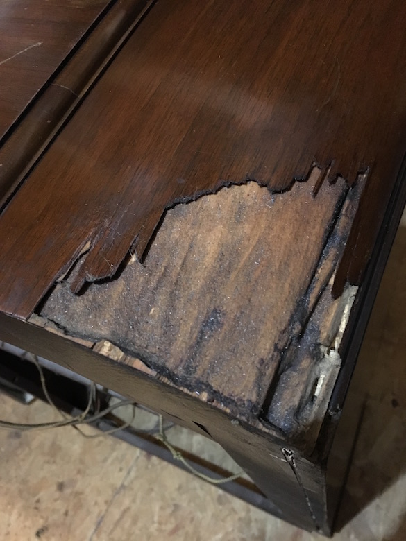

You are welcome to it Sam. The 6G5 is dead. I have a new 6E5 I will put in.

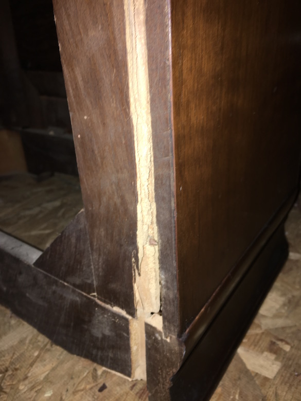

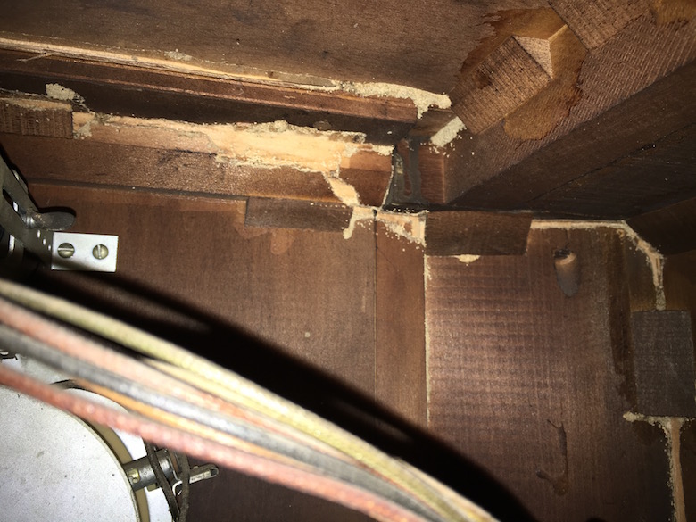

Now I have to repair the extensive termite damage.... Grrrrrr.

Looks like a winner, make sure the Termites is all gone!
Posts: 4,106
Threads: 310
Joined: Nov 2013
City: Kings Park NY
They are long dead! The really ate the crap of the cabinet though. Only on part of the base wood under the veneer though. I have to fill along the whole side and top of the inside of the radio where they tunneled...
