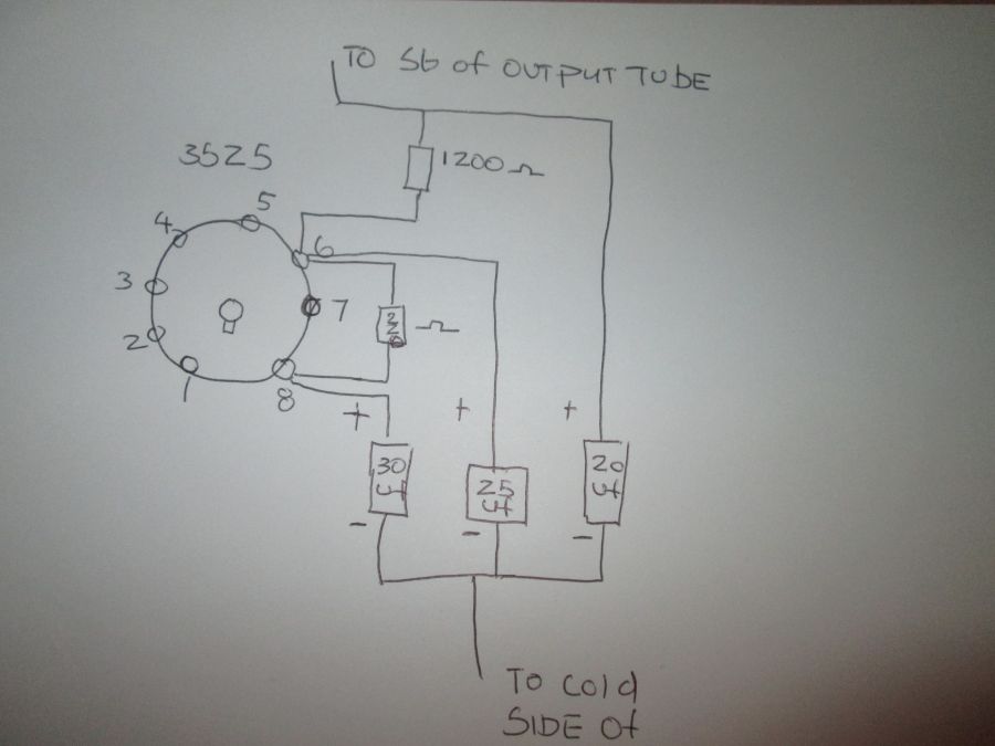

48-200 code121 Filament Wiring incorrect
The + side of the filter cap would connect to pin 8 of the 35Z5. There's a 220 ohm resistor connected there also, at the other end of the resistor that is connected to the tie strip is where the + of the second cap is connected. At this point there's 1200 ohm resistor at the other end of it is where the + of the 3rd cap is connected.
All of the - sides connect to side of the off/on sw that doesn't have the ac cord connected to it.

Hi Terry:
I ran into a couple of problems namely the connections to the strip. One of the pos + wires is attached to the blue wire which is on pin 6 of the rectifier.  The 3rd pos + goes into that cone shaped test port above the rectifier.  Also, I attached the  1200 ohm resistor to the strip but to which of the terminals does it go?  The sch. shows it is the closest one to the rectifier.  The diagram also shows the other end of the 1200 R going to cone shaped test point.  In any event I still have a very bright panel lamp @ 30 volts and no filaments but maybe we're getting close.
Rich
Correction on my last message: Pos+ is on the plate Pin# 5.
This is fine if there is something else connect to pin 6 also as it has no internal connect to the tube. A common configuration would be to have the 220 ohm resistor between pins 8 and 6. 6 being used as a tie point also it would have the 1200 ohm resistor connected there.
One end of the 1200 ohm resistor goes to the end of the 220 ohm resistor that isn't connected to pin 8. The other end connects to the screen grid of the audio output tube. Not sure which tube is used in your set, 50A5 (pin 3) or 50L6 (pin 4).
EECCKKK!! [Image: http://philcoradio.com/phorum/images/smi...n_evil.gif]Reminds me of a song Another One Bites The Dust! The only place you should have an ecap connected to the 35Z5 cathode circuit (pin 8) NOT to the plate or heater pins as these have ac voltage on them.
Pic cutoff at the bottom sez cold side of the off/on sw.
