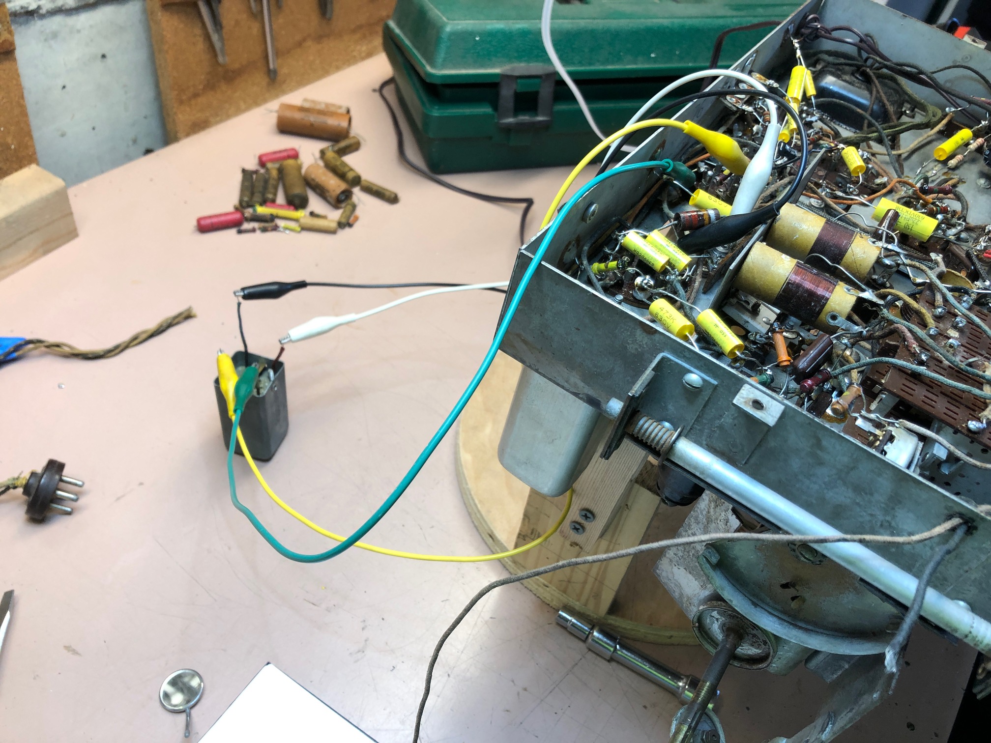

    I took another look at the IF transformers. The first one has continuity and 15 ohms on both sides, the second one has continuity and 15 ohms on one side, open on the secondary. So I had a Pac Bell parts radio with an IF transformer, 20 ohms on both sides. I jumpered this in after removing the original and for the first time I received a broadcast signal, the strongest station locally. Very, very distorted, not so much that I can't make out the words, and there is a background buzz, maybe the same one I've had all along. Getting the broadcast signal has me excited though.
Before I solder it in, this transformer should be just fine, right? The 48D is IF 460, the loaner model 651 is IF 455. Could be interesting to see what I get if I bypass the open transformer.
Alan
After you get the replacement installed you have a great project to start 2019 rewinding the old IF can.
Maybe I'll get started on Christmas Day, really annoy the wife.
Alan
(12-25-2018, 10:45 AM)lasurveyor Wrote:  Maybe I'll get started on Christmas Day, really annoy the wife.
Alan
Icon_lol
my math says a 60ohm resistor across the pri and sec on that replacement IF will get you in the 15ohm area which for some reason i feel compelled to think it would be better for the radio's original design.
the next thing is to find out if the cap on each side is going to give you problems.
meaning,,, is this a tuned slug or tuned cap??????
i would get the old IF under a magnefying glass and find out if you can "see" the open and repair.,, tiny wire there like what,, 60awg?????
