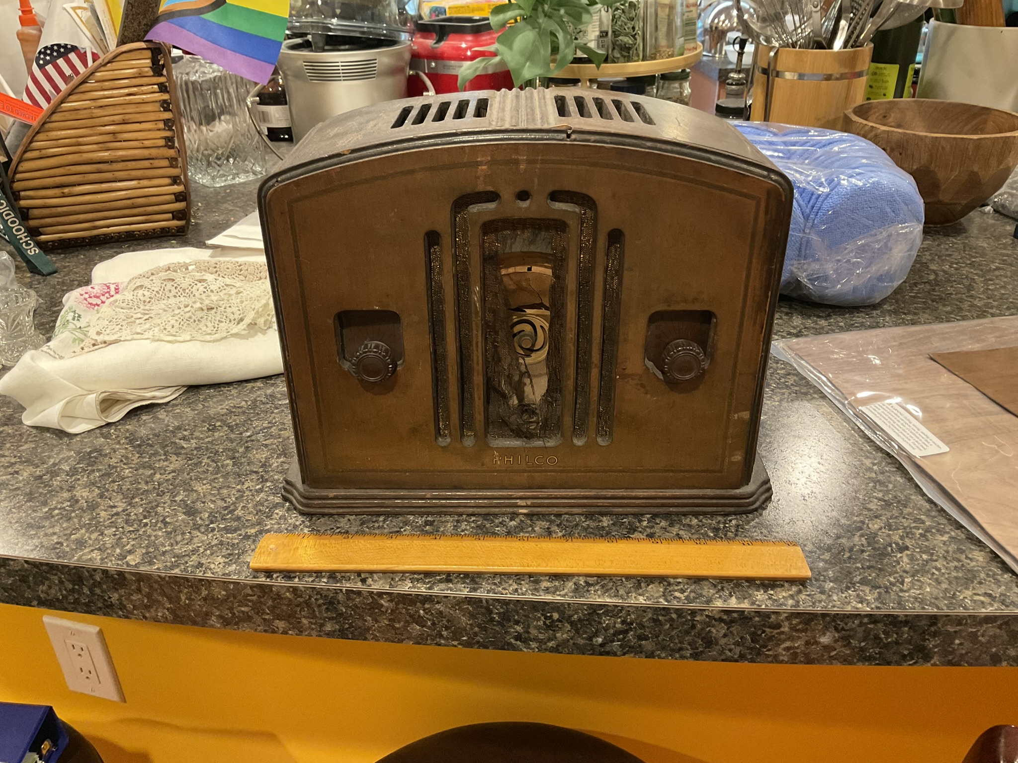

While I'm waiting to wrap up the final steps on my wife's Silvertone 2014, I started disassembly on the next project.  One of the wife's friends liked the idea of a vintage radio for the front desk at her inn, especially if it could accommodate a Bluetooth connection but she wanted something small.  This 54C was one of my very first (if not the very next) acquisitions after the 6K3, (eBay) though I paid more for it in April than I would pay for a radio today ($45, plus shipping).  She likes this one for its size.
