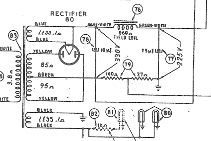

I have a couple 500uF 450Vac capacitors - Can I use these for filter caps?
I believe 500uf way too high. What does the schematic show for cap values of what you want to replace?
Looking at blurry schematic off NA site looks like cap 77 is 25uf and cap 78 is 18uf I could be wrong about 77 ,guess it could be 2.5 but that dosen't sound right. If they are 18 & 25 you could use a 22uf 450v caps. If I'm wrong someone will correct this. Good luck
Right on the smaller uF values - I just had them in my hand and was wonder what is wrong with using such a high value and if would be detrimental

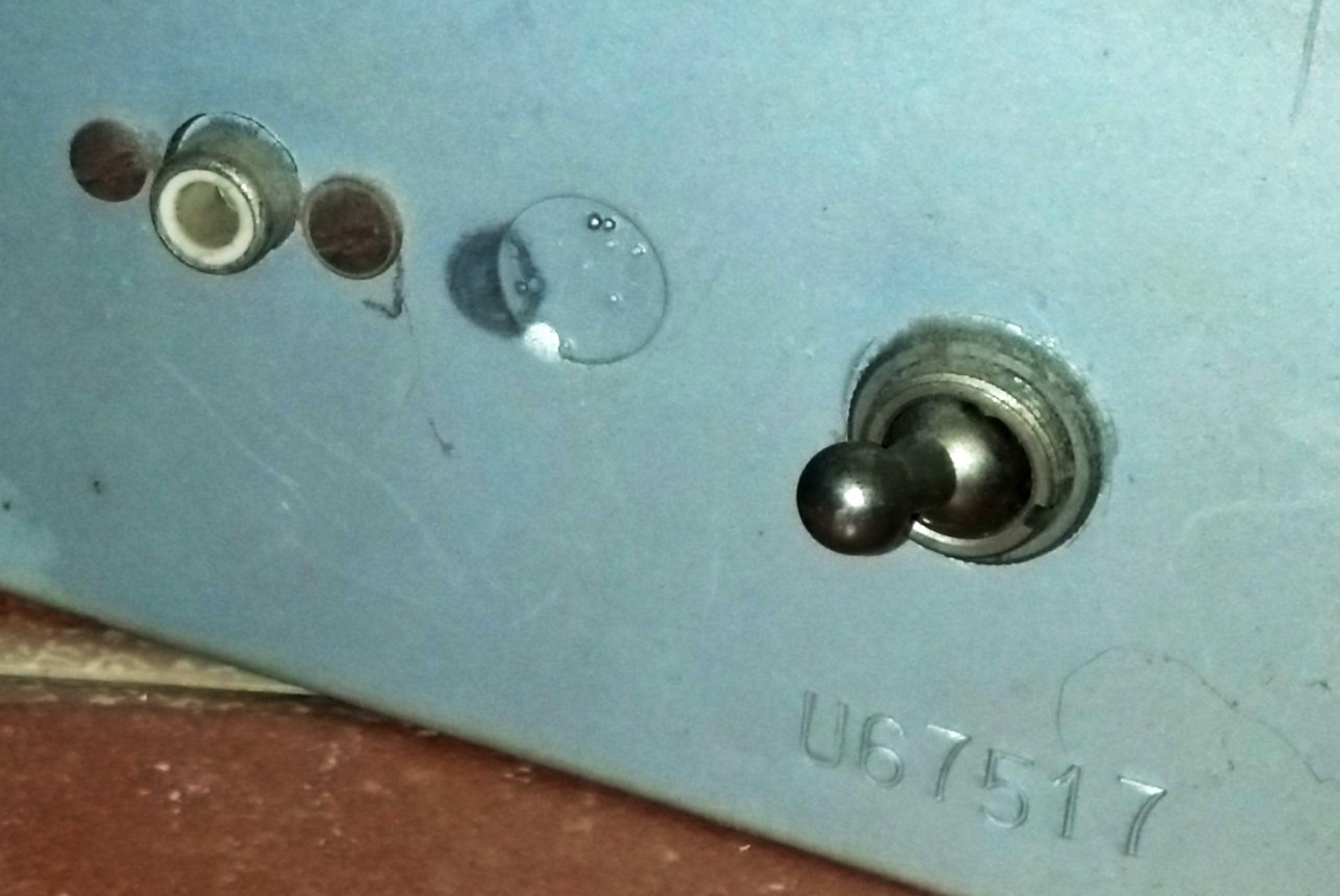

Next question. I cannot locate this mono input and switch. Was it added at a later date? It's not grounded either oddly enough and is not in the wiring diagram that I can see.
It was fairly common for people to add phono inputs to radios of this vintage. That way they could buy a turntable without an amplifier and speaker, and play records through the radio.
Usually the owner or a repair man would add the phono connection (an RCA jack like you have) between the 2nd detector diode section of the 1st audio tube and the amplifier section of the same tube so they could take advantage of the volume and tone controls. A switch was usually added to disconnect or ground out the radio signal so sound from the radio wouldn't bleed into the phono signal.
There were different ways to connect the phono input and disconnect switch. You might want to make a careful diagram of where these wires go so you can reconnect them when you finish the restoration, sine they won't be in the schematic. You can connect various modern music players like iPods and so forth to them if you want. Or you can remove the modification, since it wasn't original.

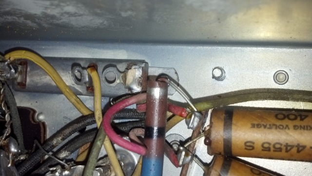

next question - looking at the wiring diagrams (thank you Chuck!) and looking at the chassis - it appears that there is no ground at #79, at the ground side of the 27ohm portion of the BC resistor (does this stand for invented Before Christ?).
It's supposed to ground #77 25uf electrolytic.
Where did the ground wire go? I asked the chassis a couple times, then the darn BC resistor, but it's resisting to answer me...
Is it grounded through the mounting rivet or bolt that holds the resistor to the chassis?  Cap #77 is probably grounded through its mounting on the chassis.
#10-0,05uf is missing too.
