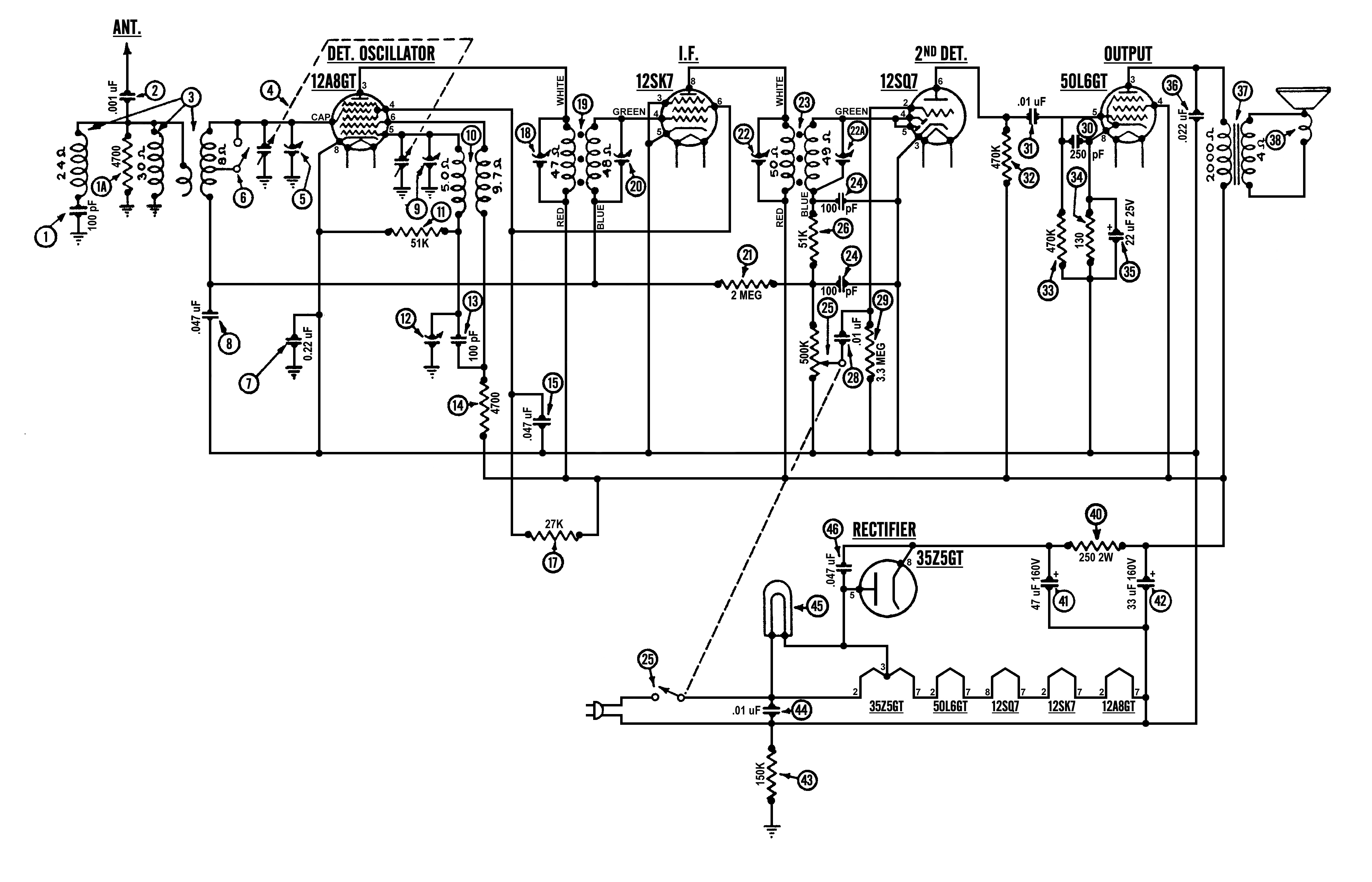

Just for fun, I decided to try and see if I could convert a 54C to use octal tubes in order to eliminate the two large dropping resistors. It was mostly successful.
Mostly?
Well, now the thing will not tune correctly. The oscillator is working, but is way, way out of range - beyond a simple alignment issue.
Our local AM station at 990 kc won't even come in. Stations which should be on the higher end of the band are coming in on the lower end.
IFs are properly aligned at 460 kc.
Please look over the modified schematic below, and then tell me -
Would you consider this to be an oscillator coil issue? Or is there something else I am missing here?
Thanks. Oh, and you can compare the schematic below with the original 54 schematic which may be found here.

Did the radio align properly before the modification? One would not expect the characteristics of the 12A8GT to be much different than the 6A7. Could capacitor number 13 be bad. You might try adding a cap parallel with 12 and 13. May have to add a couple of turns to the primary of the coil.

Just for fun, I tried different capacitors in parallel with the oscillator section of the tuning capacitor. Using a 150 pF put me in the ballpark as far as getting the tracking correct is concerned. 180pF also worked but was a bit too much. This is why I was thinking perhaps something about the oscillator coil's characteristics has changed.
I'm baking the oscillator coil now, and I may try a different 12A8GT. I currently have a tested used tube in that socket. i do have a few NOS 12A8GTs. As you say, the characteristics of both it and the 6A7 are very similar.

All things being equal. Sounds like the inter electrode capacitance is less than the 6A7 making it oscillate faster. You might try to measure the capacitance between the elements of the two tubes and then add some extra capacitance to slow it down.

If I am reading the schematic right (And that may be an issue, as I am fighting either a bug or the effects of the COVID Vax Booster), it appears that you eliminated the cathode bias resistor. (Maybe resistance really is futile??  ) Try putting it back in. Both units use a voltage divider in the B- Return to create an ersatz "C-" supply, but there is more resistance in the 38-18 than the 54.

As someone here said "all things being equal", your IF being aligned, the sole person who could shift things is Mr. Oscillator.
If you kept the resonant elements from the earlier sch, then my bet would be on the parasitics of the tube (the IE capacitance).
I would start from measuring the output frequency of the Oscilaltor at the start and the end of the scale; and then possibly (if you have the old 54C) comparing it to the current one.
The inter-electrode capacitance of the oscillator "plate" grid (G2) and the oscillator grid (G1) are very, very close between the 6A7 and the 12A8GT.
And MrFixr, after thinking, I realized that if the 12A8GT needed more cathode bias, I don't think it would affect the oscillator frequency that much - the entire tube would have poor performance.

I studied several Philco schematics. I focused in on model 602 since it is the most similar to the 54 of all the 1930s five tube AC/DC Philco sets.
Notice how it has the oscillator coil winding with the highest resistance (7.5 ohms) connected between G1, the oscillator grid, of the 6A7 and B-. The other winding, 2.4 ohms, is connected between the oscillator plate (G2) of the 6A7 and B+.
Just the opposite of the 54.
Just for laughs, I connected the oscillator coil into my hot-rod 54 in a similar manner to the 602.
Boom, the entire AM band came to life. Wow, is this radio sensitive! It even picks up stations without an antenna!

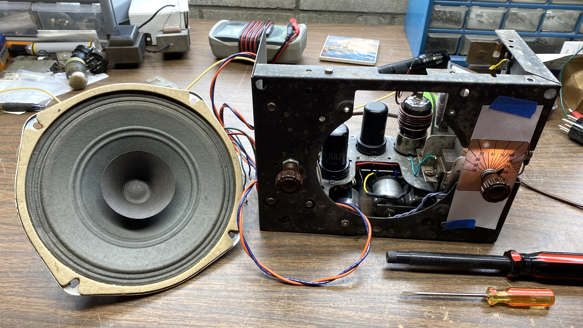

This morning, I printed a 54 dial graphic to size and taped it to the chassis. I found that the alignment - on the high end at least - actually wasn't too far off. At the low end, 600 kc was coming in around 70 on the dial. Fortunately, the 54 has a low frequency padder so this error was soon taken care of.
Now the set has been nicely aligned and is working properly. Yes, it is less sensitive on the low end of the dial, but it seems most of these cheaper radios are anyway. This isn't a laboratory grade instrument - it's a five tube cigar box pee-wee which was originally made to sell at a fairly low price.
I am very happy with how it has turned out. I would absolutely do this conversion again on a 54 if only to get rid of those two large power-wasting resistors on top of the chassis.

(Notice the Steve Davis alignment tool in the photo above.)
