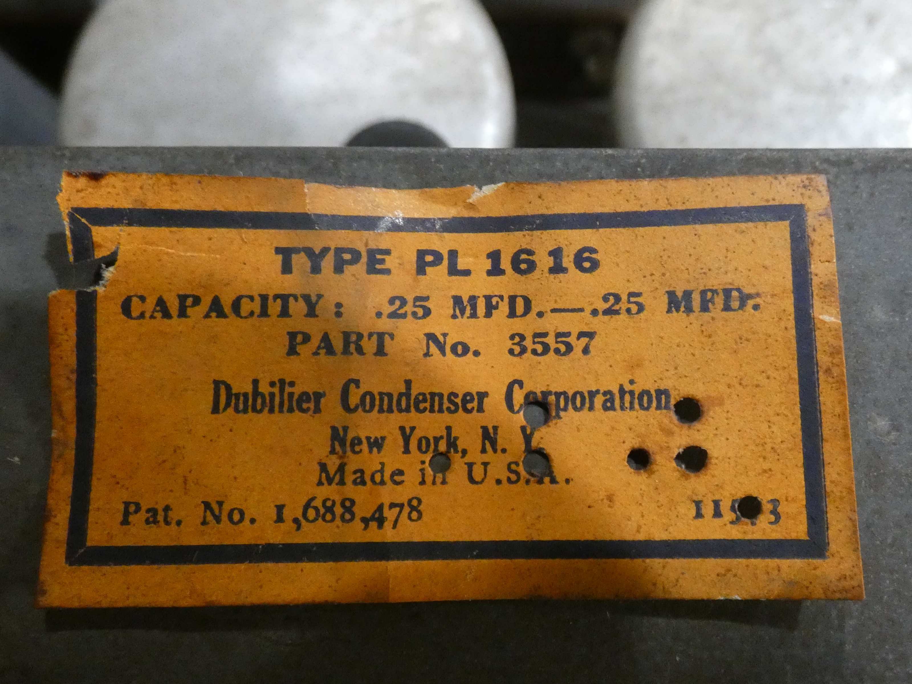

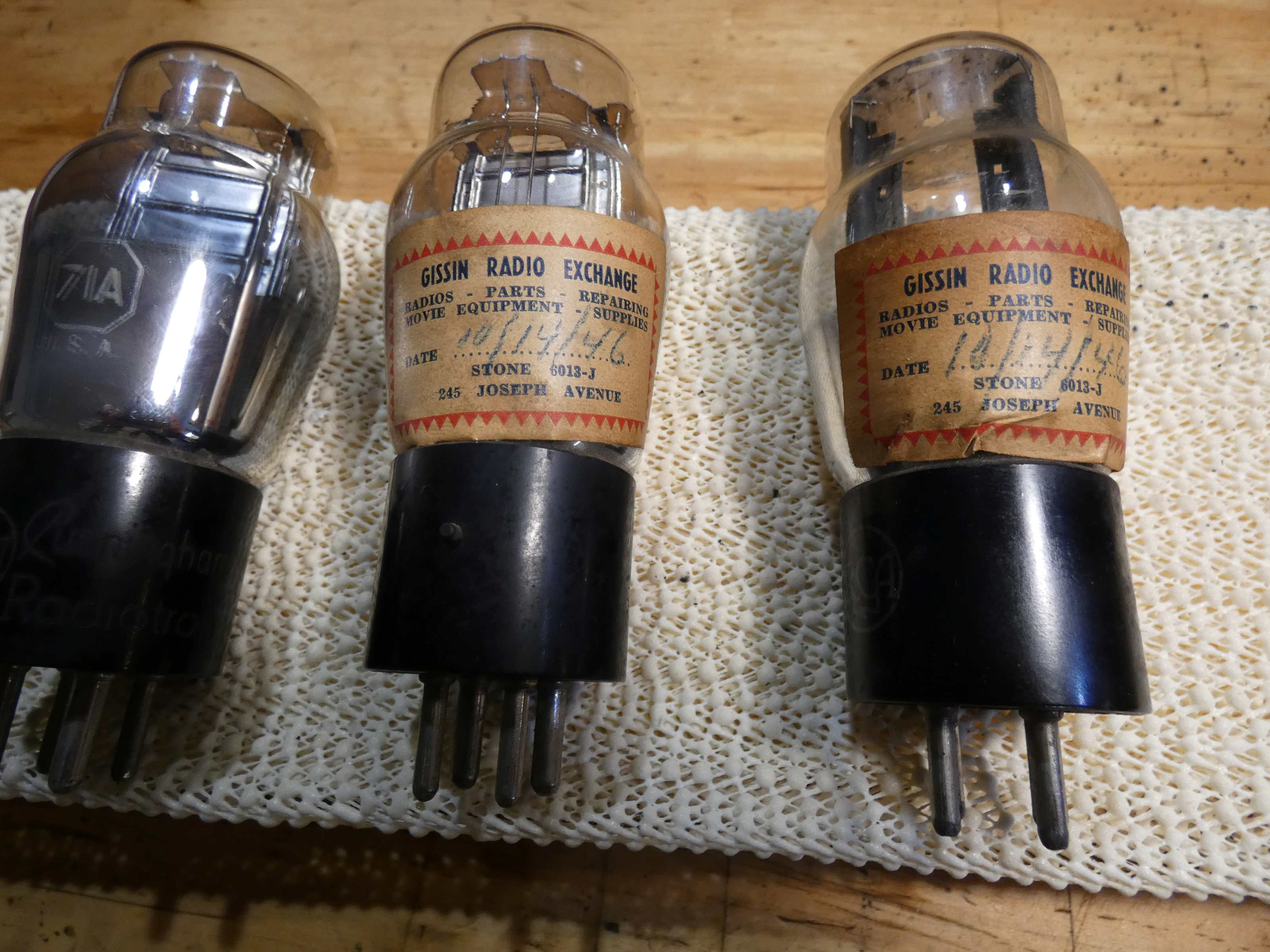

Thanks for the replies. As I continue brushing off the dust in the chassis, I am finding labels attached to some of the components that I find interesting, is there an interest in preserving or those sharing labels with the group? As I go forward with questions should I continue with this same post? Also, I seem to be not having any luck when I do a forum search for the radio, I am needing information on.

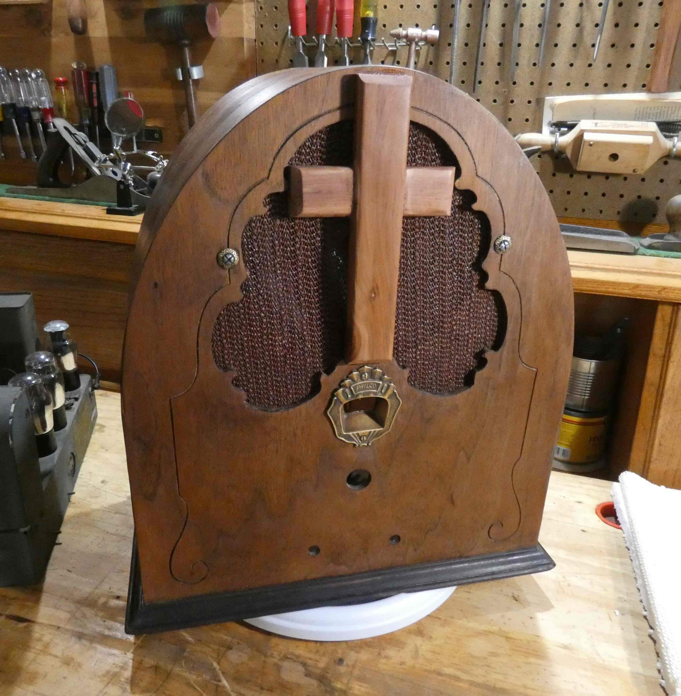

Ordered the individual components I needed so in few days I will be able to proceed with the restoration of the chassis. The case rehab is not pretty but it's the best I can do for now.

I’m understanding the original front was trashed, but I’m still unsure about your replacement.
I think you could find a local craftsman who could make some fretwork that closer approximates the original. This isn’t totally an an aesthetic issue as I think having that thick cross will affect the acoustics.
