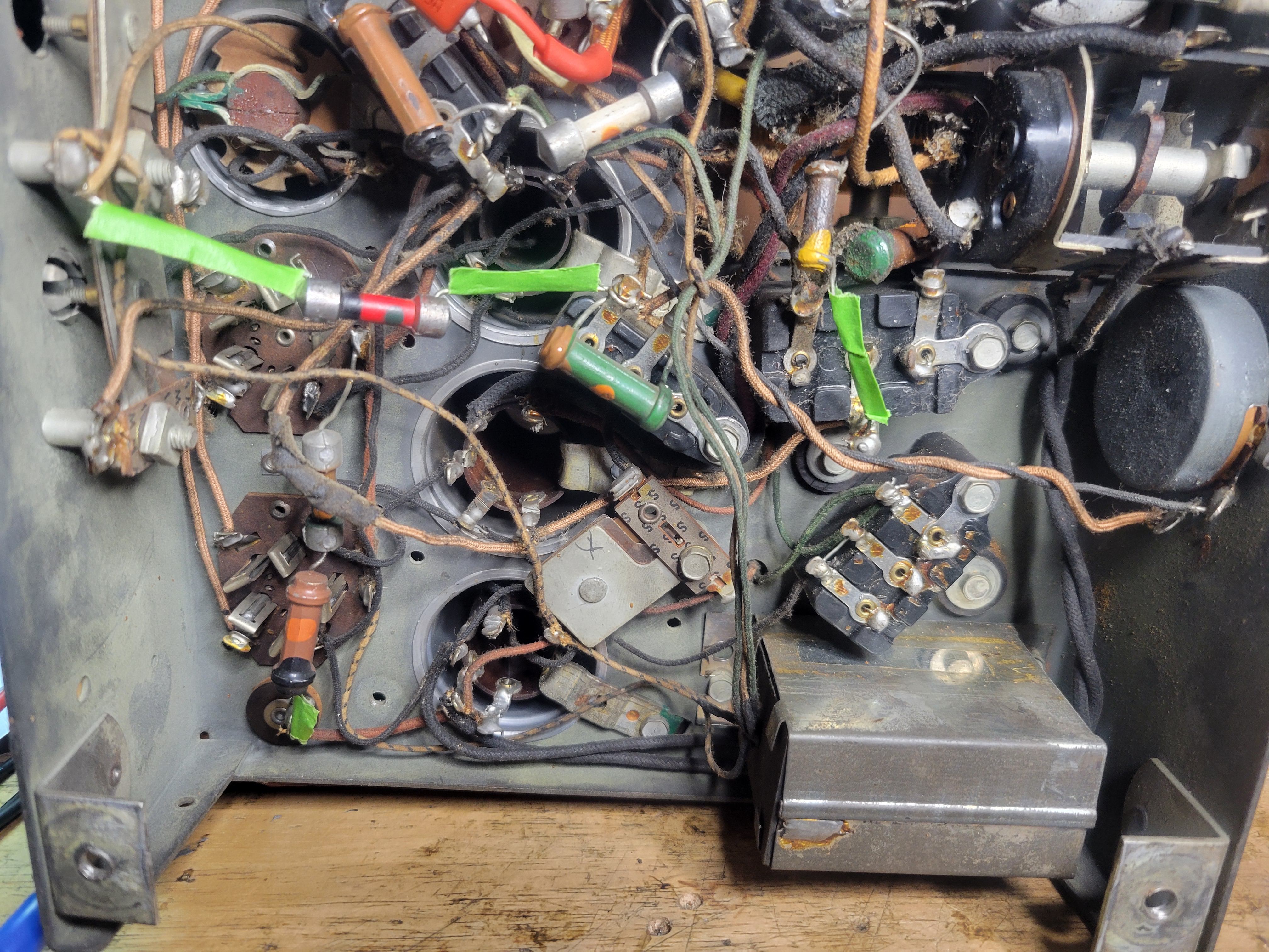

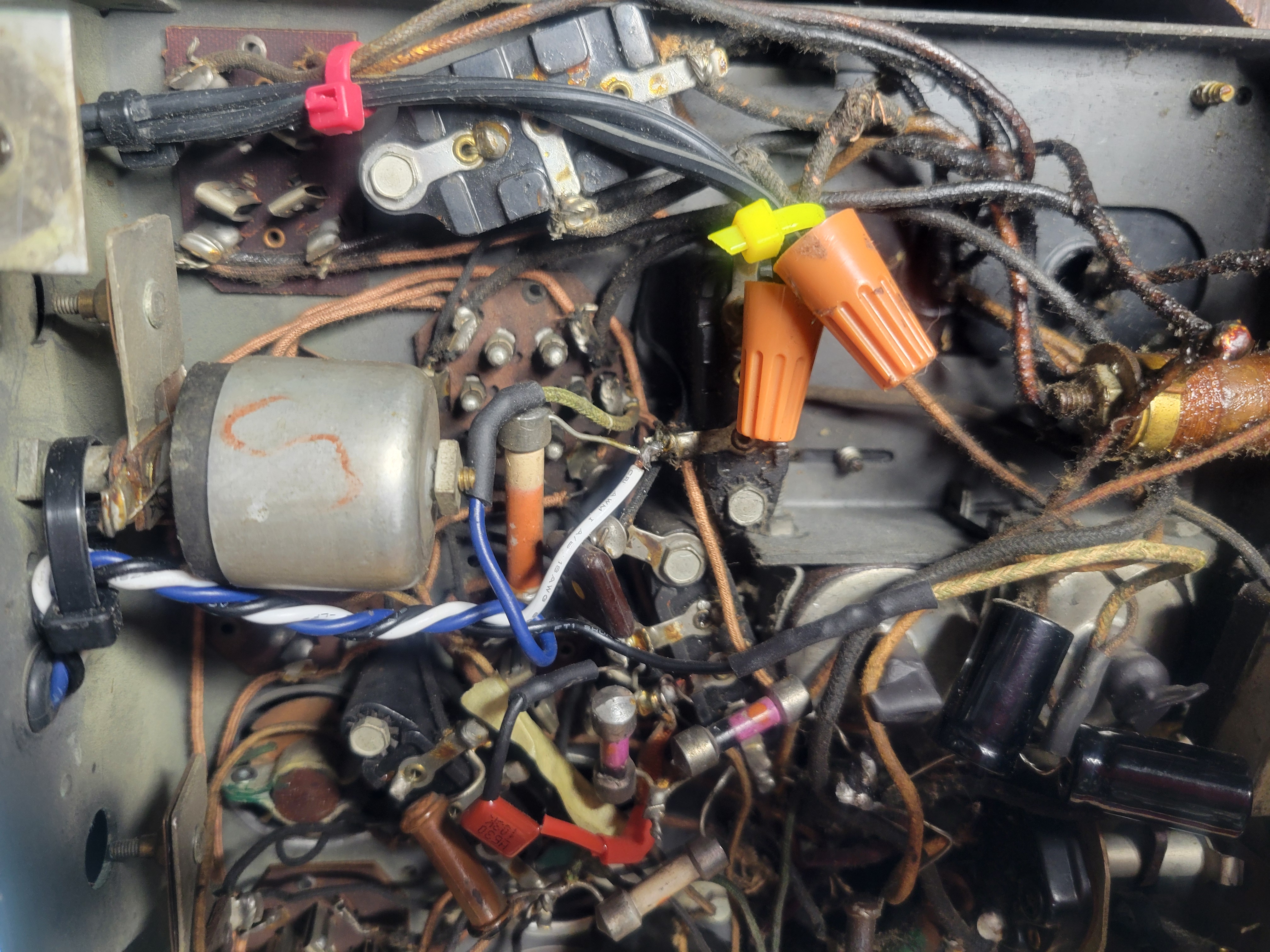

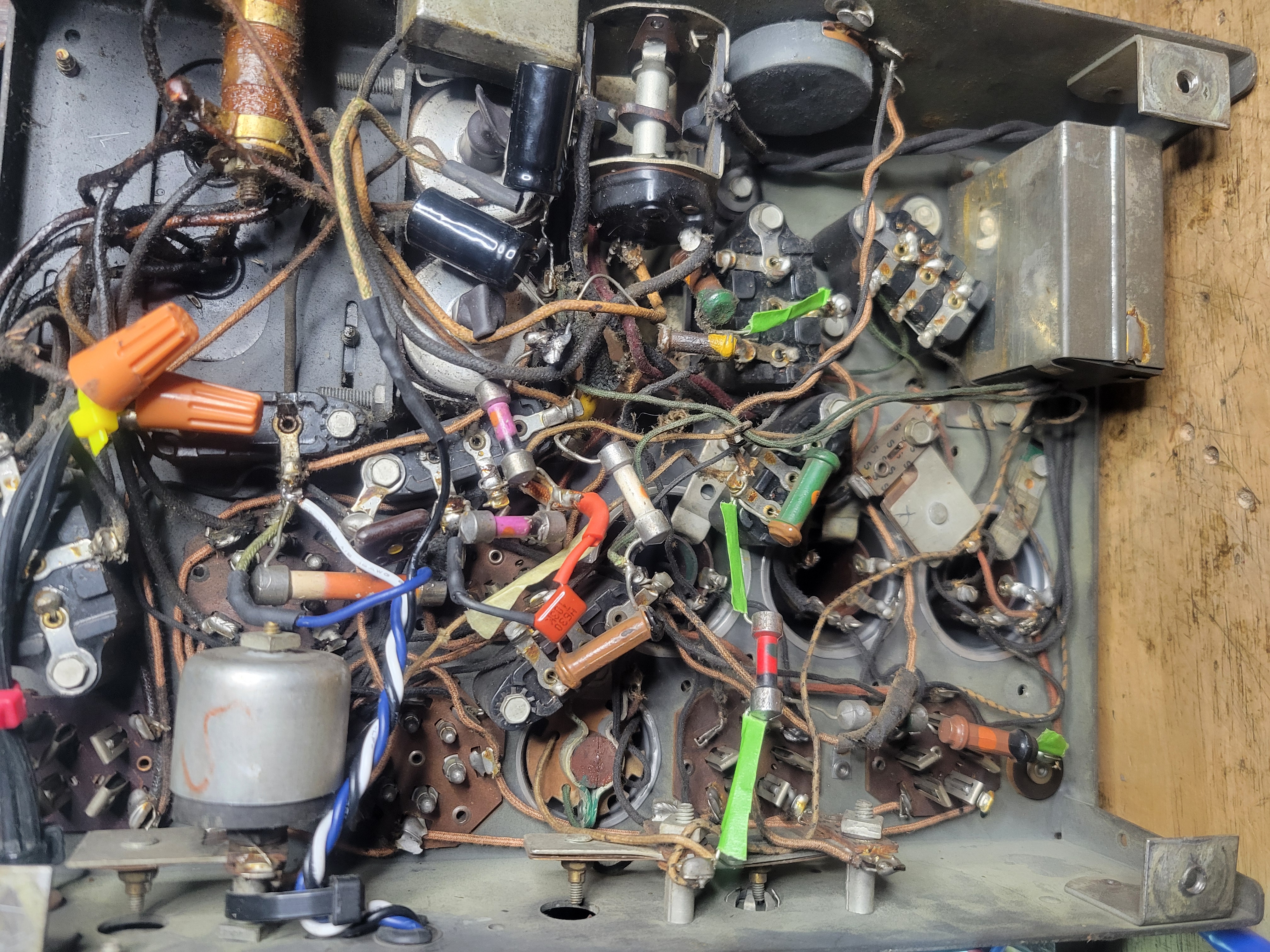

I have aquired the troublesome but beautiful 89/123. The good news is I actually have it working. Did the usual filter caps and I have a temporary ac cord. I see a lot of crazies in here and even though I have the parts list, location list and schematic this is still a rather confusing radio...Actually its working rather well and I might want to only change anything that could be vital. Already did the filters and checked and replaced what I could. My question is is there any hidden "caps in a can"
(and boy are there a bunch of them!) that *must* be replaced before something bad happens? And if so, where would you start first? Also any help identifying what's in where would be appreciated.

From the pictures, it appears that your radio is in rather good and unmolested condition. Congratulations on this!
If you have an 89 actually working, I understand why you might not want to mess with it. however, all older radios have capacitors that deteriorate, leak and eventually short. Of course, right off the bat, the filter caps must be replaced, which appears to be done. The audio coupling cap between the first AF stage and the Output stage must also be changed. If this cap shorts, you will drive the grid voltage so high that the tube will draw excess current and "red plate" (a red glow can be seen from the plate), destroying either the tube, the output transformer or both. If a "bypass condenser" (usually found between a screen grid and ground or cathode and ground) shorts, it will pull B+ to ground, burning out dropping resistors. Therefore, do change the caps. This is a little difficult in this set, as the caps are embedded with tar in the Bakelite "Blocks" that you see on the underside of the chassis. Some of these blocks contain 2 caps or a cap and resistor. The third page of the above diagram will show you which block contains more than one cap. Of course, we are here to provide advice.
