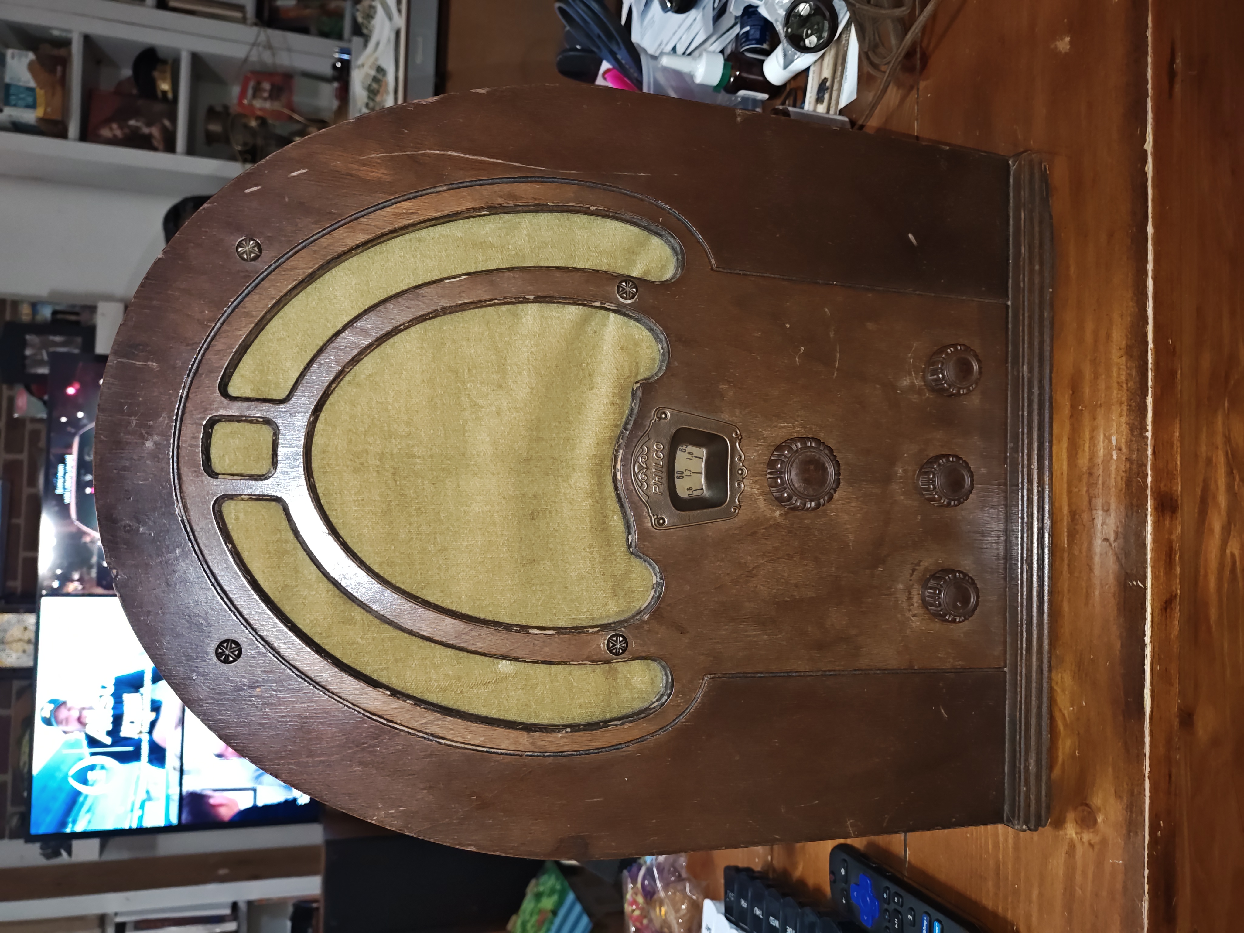

I've had many radios but never a cathedral Philco model 60. . Found it in an old junk store while visiting my home town of New Britain, Conn. I wouldn't dare plug it in without a variac but I will get around to servicing it. Any tips would be appreciated. Cheers.

Nice find, tis an oldie. Hope it turns out good for you. Paul

What Great looking set it looks to be in very nice shape .

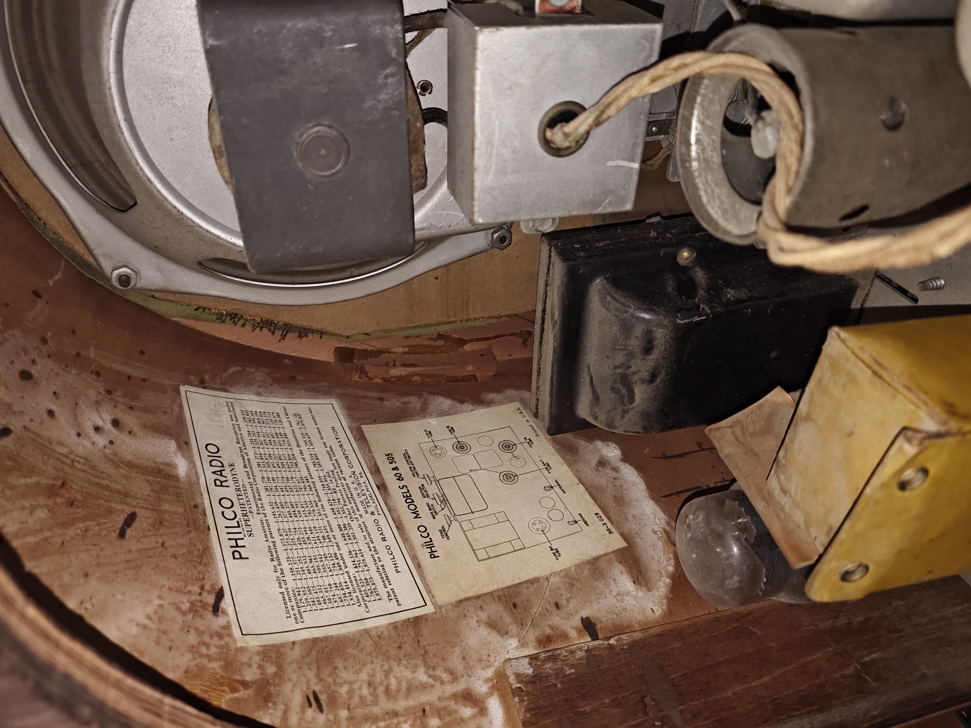

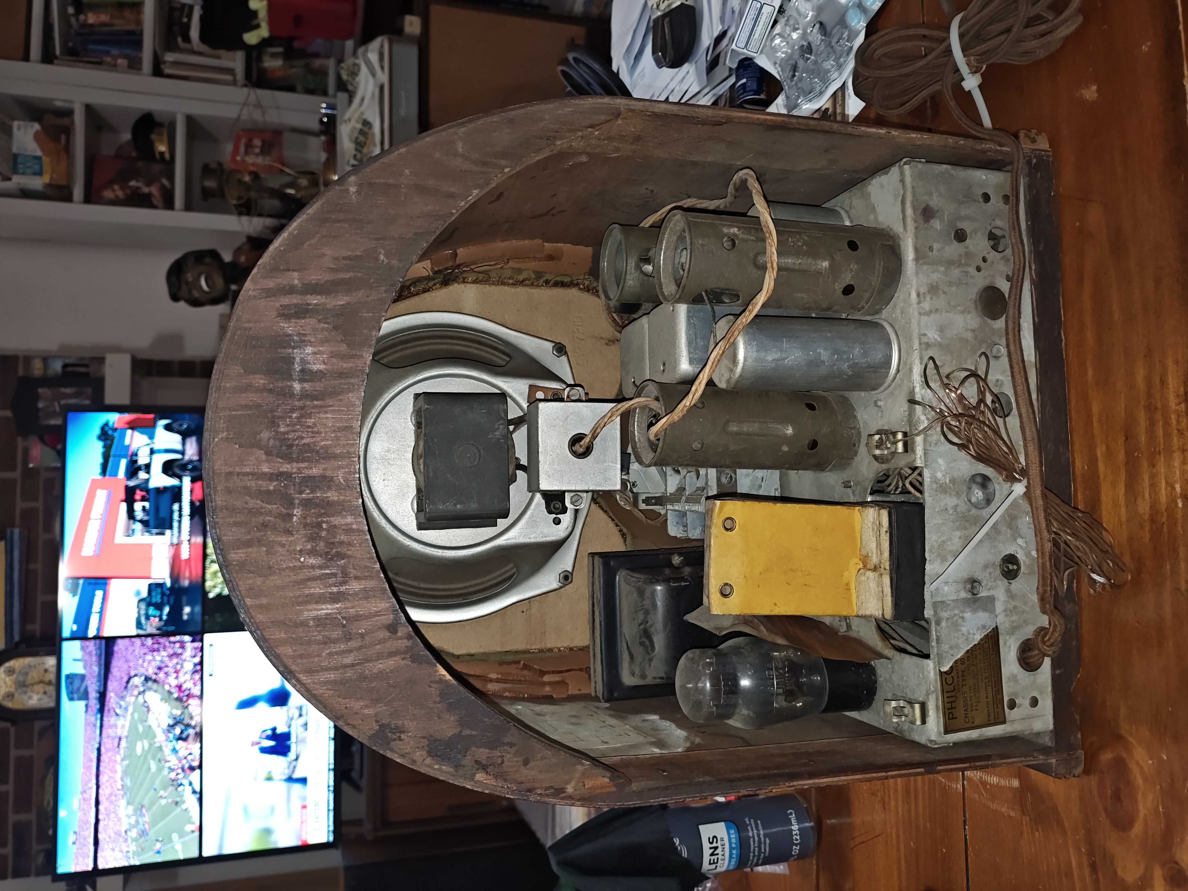

Have you ever restored any 1930s Philco's if not you will find under the chassis what is called a bakelite block and there are a few under the chassis there are capacitors that are sealed in tar in those blocks that will need to be replaced plus that cardboard box looking thing is the sets main electrolytic capacitors that will also need to be changed.
on this sight you will also find Schematic to help in repairing this set.

Welcome. Adding to what Richard said and not to scare you off restoring this set you may find the oscillator coil is open. Rewinding the coil is very doable. I done 3 or 4 so if I can do it you can. Lets hope yours is good. Good luck with the restore. The 60 are one of my favorite sets.

To your radio, this is an interesting set. This set is the basic 5 tube superheterodyne set, complete with pentagrid converter, IF amp, diode / triode detector / AVC/1st audio amp and a substantial pentode output tube; certainly not an obsolete set, as good a set as any plastic 5 tube AM radio from the 1960s, and given the speaker, power transformer and 2.5 - 4 Watt output, superior to these modern transformerless "AA5" sets.
Morzh already gave you a link to several schematics and versions of this set. Based on the cabinet pictures, you have an earlier set.
