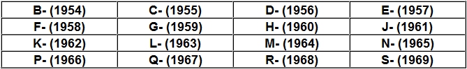

Philco sets made after the 1953 model year start with a letter instead of the last two digits of the model year, as follows:
![[Image: 5469_chart.jpg]](http://www.philcoradio.com/images/phorum/5469_chart.jpg)
In addition, early Philco transistor radio model numbers start with a T-.
